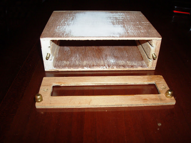

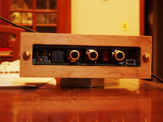

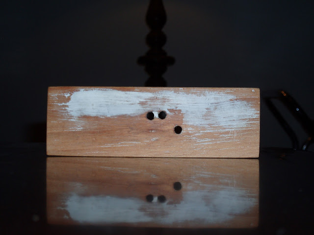

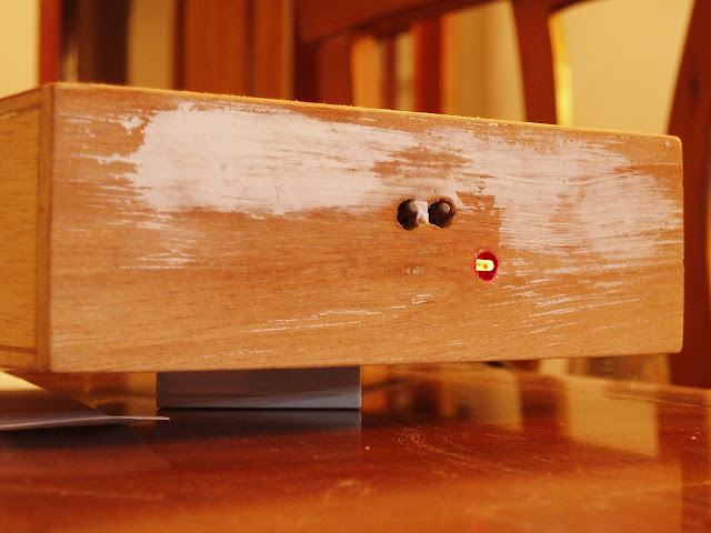

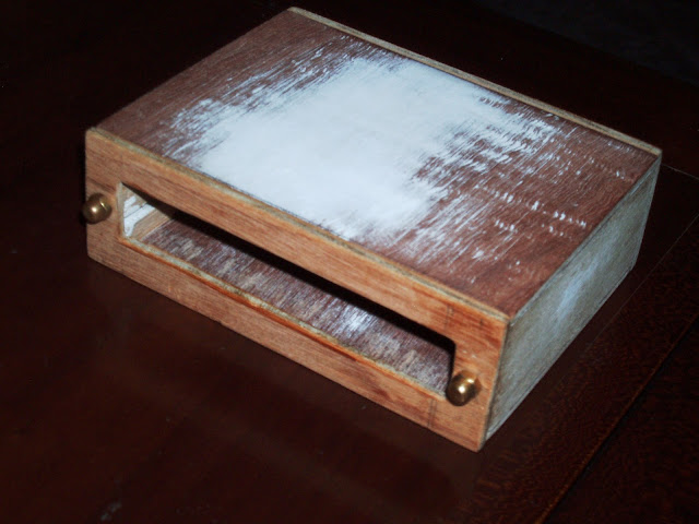

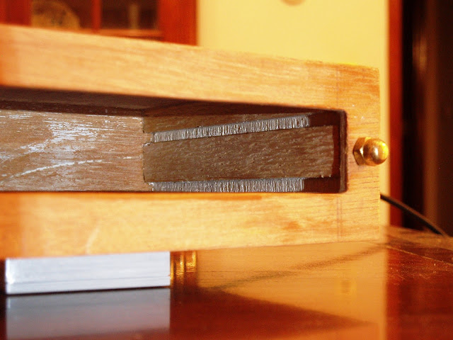

    Update on Gamma2 case, I did the front and rear panels today. Front Panel is glued to the case and the rear panel is removable. It holds in place like a few portable amps, a threaded rod fixed to the case with thumb nuts holding it together. Case was sanded with a belt sander and I noticed that the top panel was slightly convex in the middle, hence the white bitumen in the middle. A few other recessions where also taken care of. Overall I'm quite pleased with the result taking into account that I'm using old spares of wood. Next week I'll be veneering the case.
    Front Panel with holes for the Gamma2 Switches.
    Top and back panel, I opted to make a large rectangular opening on the back instead of drilling the individual holes for each connector as this proved much easier and faster, andwill make veneering much easier too. Still some sanding to do on the inside corners .
    Detail of the inside of the side panel. The top rail is slightly deeper because of the wider gamma1 pcb.
    Back panel removed, you can see the treaded rod assembly, will be glued with epoxy after the veneer is done.
    Back with the Gamma2 inside, there is good clearance around each connector and I'm satisfied with the result.
    Front with Gamma2, the left top hole isn't perfectly centered around the switch, but I'll grind it better, the veneer will also correct this.
