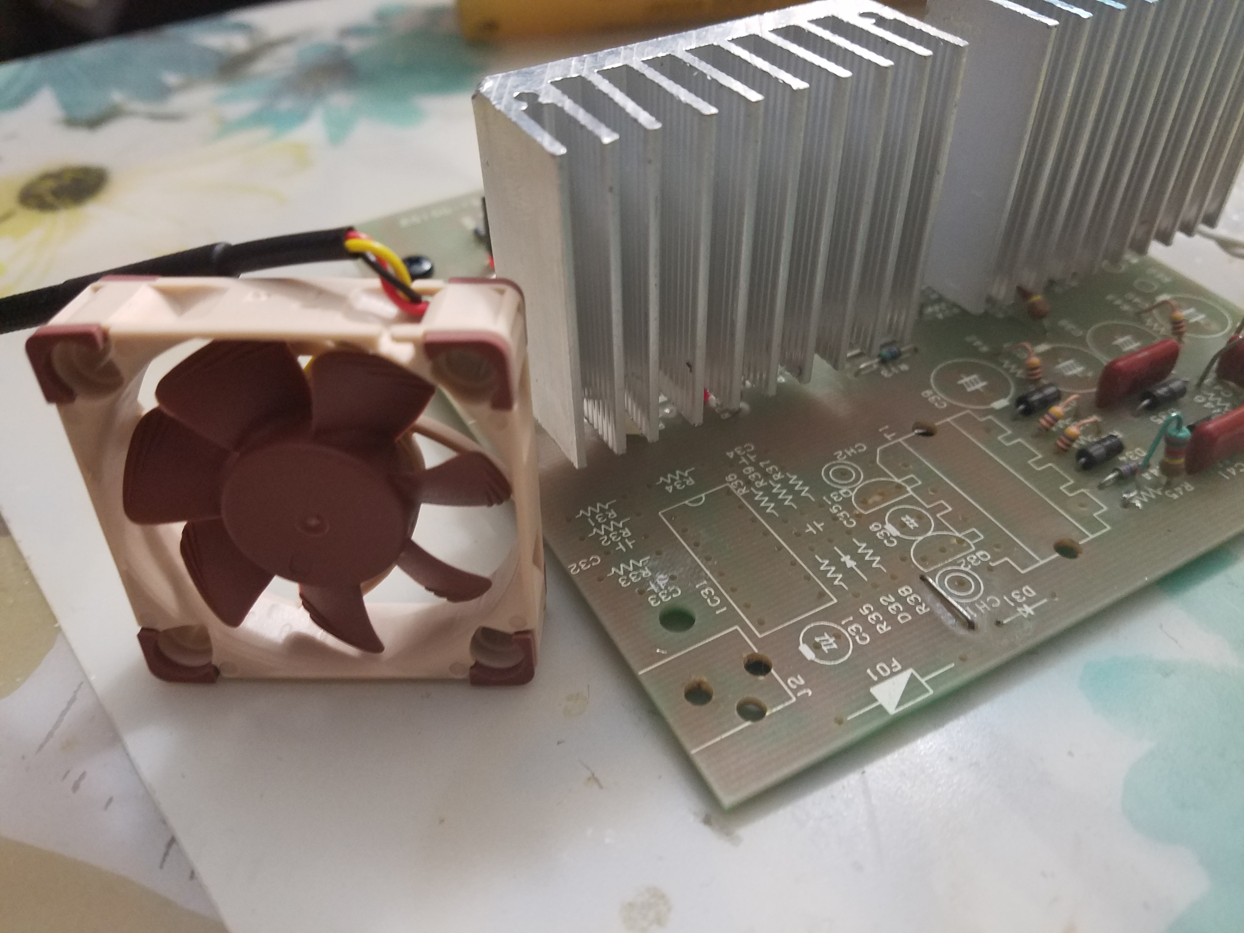

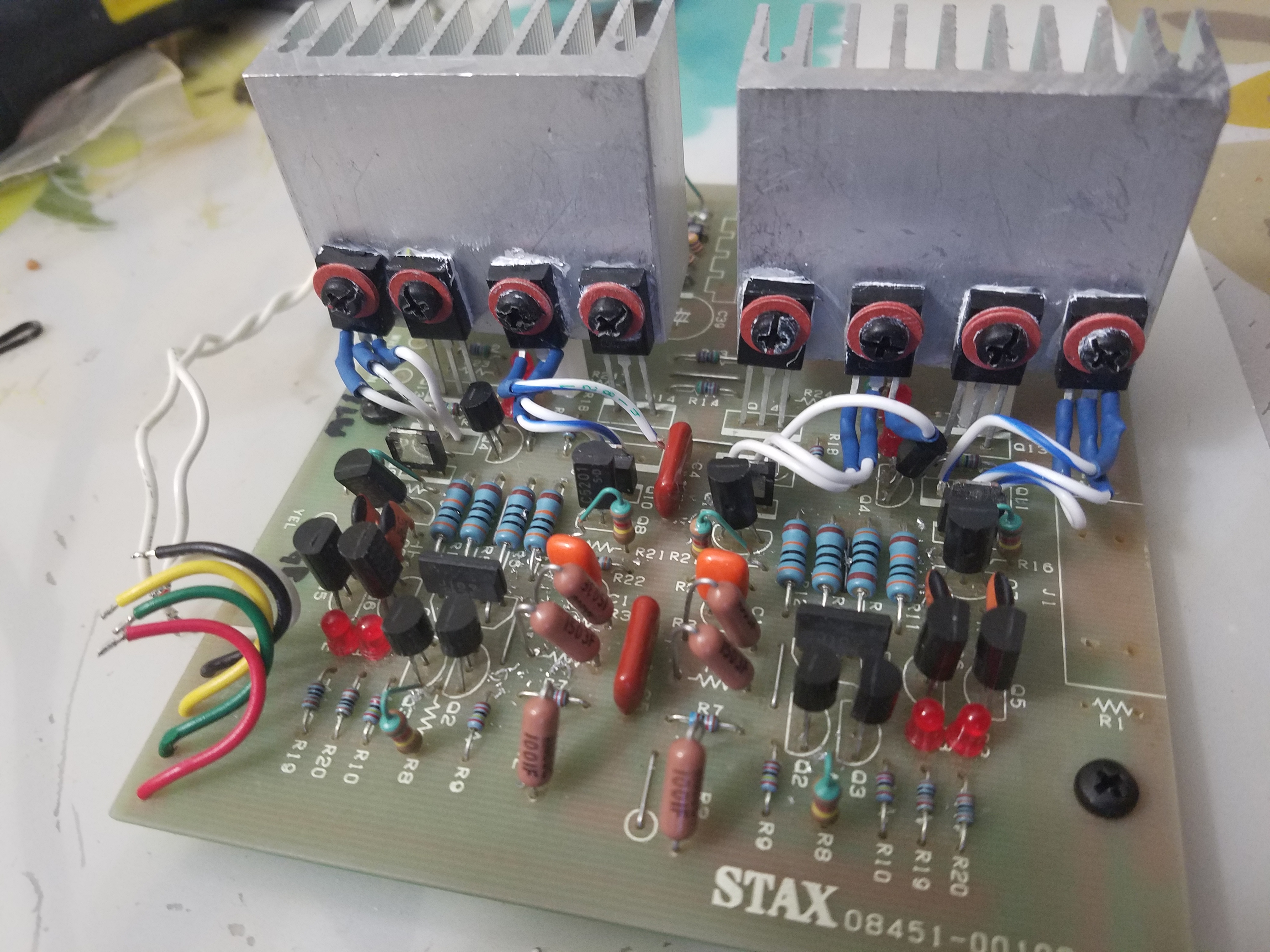

mypasswordis 777 Posted April 30, 2017 Report Share Posted April 30, 2017 (edited) Anyone ever tried them? If so, what setup worked best and how quiet were they? I've been thinking up logistics of the SRM212 I'm recasing with the new HV power supply. Thinking about using a small 40mm fan since the heatsinks I will be attempting to use (same ones as what I'm attempting to put in the mini Dynalo) aren't that big and I want to crank it to 10mA. I'll be using one per channel so 2 total and each will be dissipating around 11-12W. Guesstimating 4C/W rise on the sinks (no specs stated in the listing) that's around 75-80C on its own If it's 5C/W then it's really bad times. Edited April 30, 2017 by mypasswordis Quote Link to post Share on other sites

mypasswordis 777 Posted June 28, 2017 Author Report Share Posted June 28, 2017 So a 40mm fan is pretty small. Definitely glad I didn't get a 50mm as it wouldn't fit in the case. Considering getting another 40mm tho... 1 Quote Link to post Share on other sites
