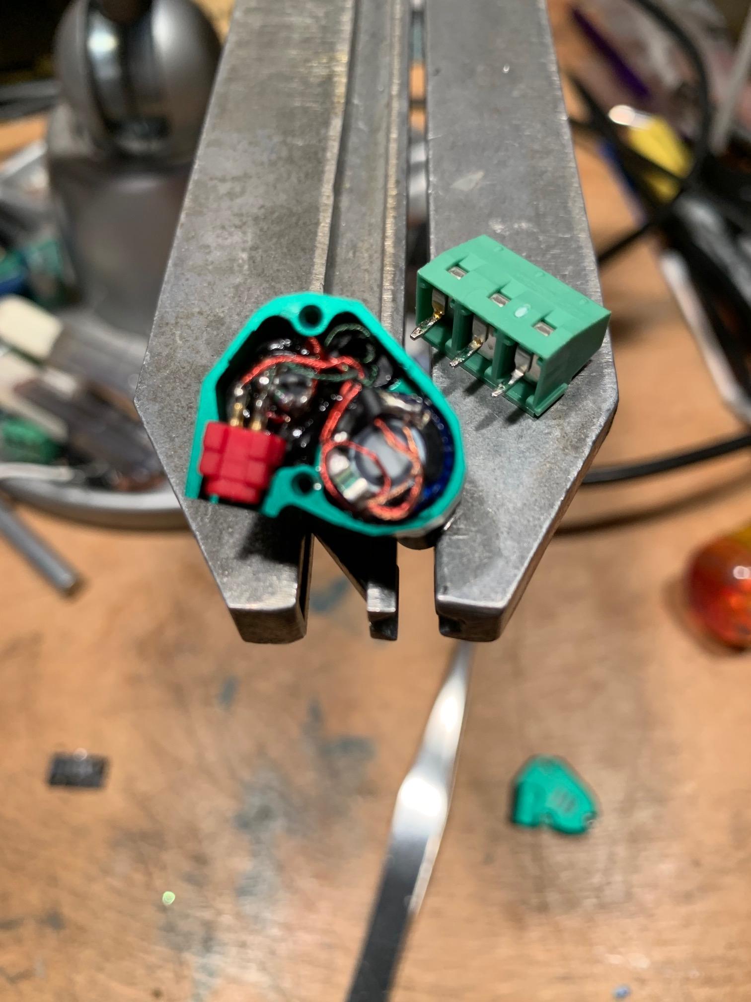

Stock, they are like this:

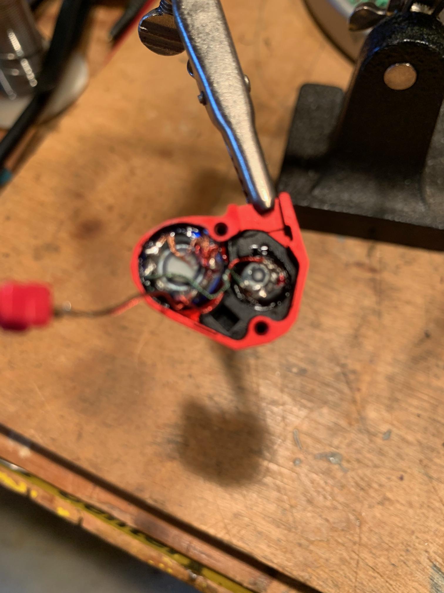

After removing a miniscule cap and resistor (102? barely the size of the end of my tweezers), and rewiring the balanced armature (BA) tweeters from parallel to serial, and replacing the resistor with a 7.5ohm MELF and the cap with a reasonably sized Panasonic ECP-U, they look like this:
Sorry for the fuzzy iPhoneXR pics, but best I could do this time of night...
