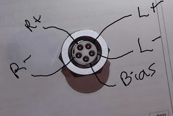

Wanted to add an HE90 jack but wanted to make sure I have the wiring correct from the front view. Not something anyone wants to take any chances on, but surprisingly little info out there on this (other than an old head-fi thread from 2010):
569a818982d54_HE90Jack.jpg.905b819e56132
Was planning on using the +500 supply for the bias and add another 5M resistor in series.
