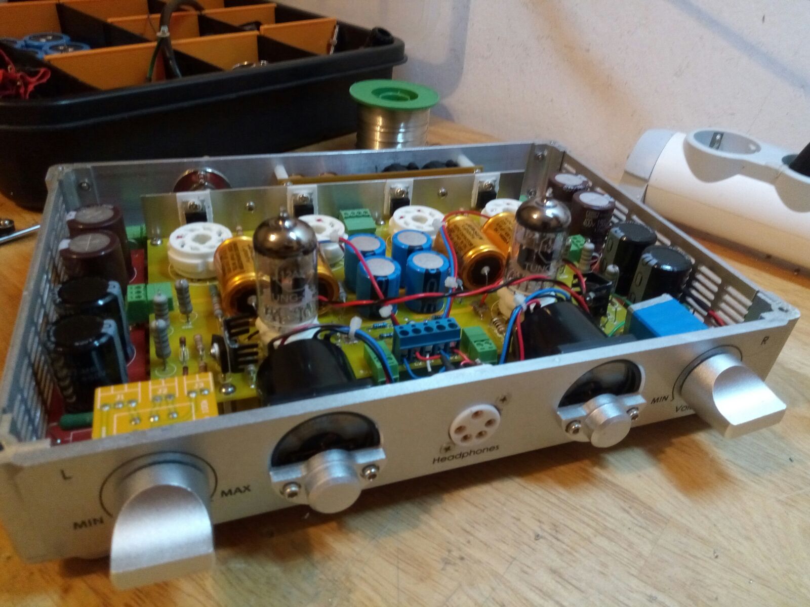

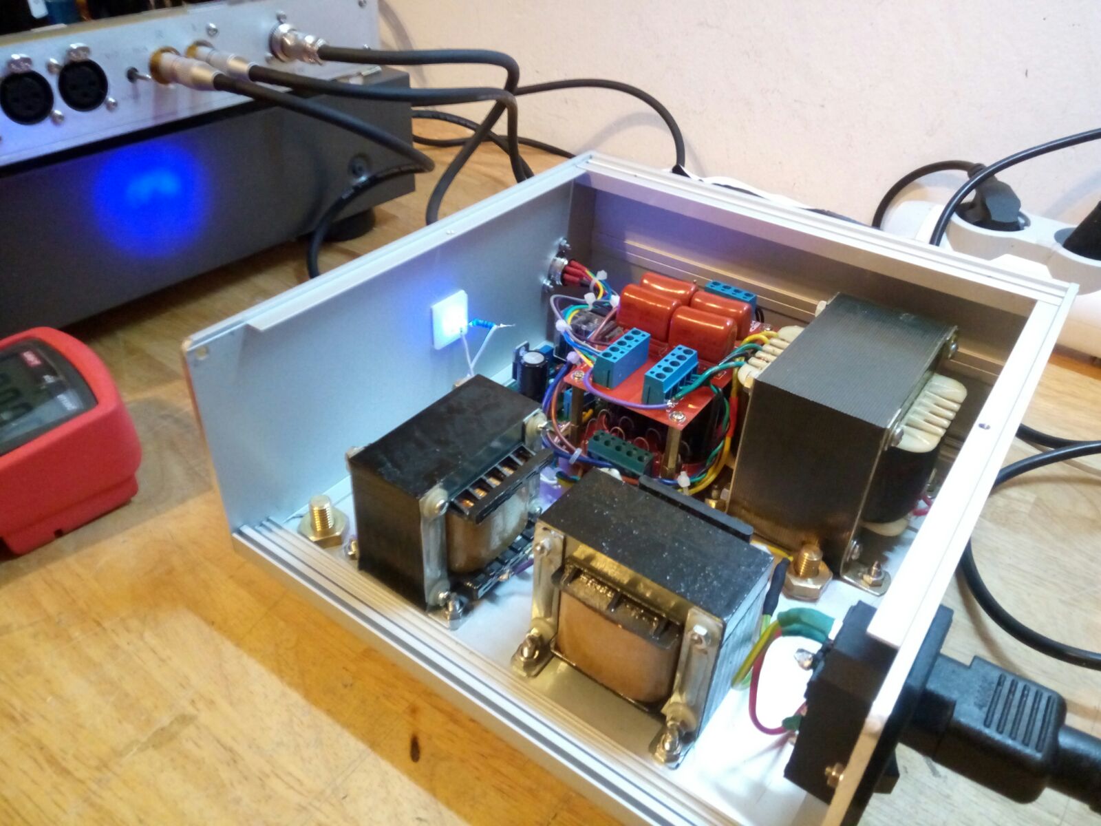

Latest state of the egmont clone from china:
Pro socket is changed from shitty one to teflon one.
Capps on signal path  are changed from mundorf 0.15uf supremes to 0.15uf jenzen copper foils.
Choke filters in power supply are changed from CRC to CLC. Air core inductors are used.
Diodes are changed to SiCs
You might think "why do you spend so much time and money on a shitty amp?!" But I think "what man is a man who does not make the world better."
Chasis of amp will change and transformator will be torrodial from torody.
Edited by Sechtdamon

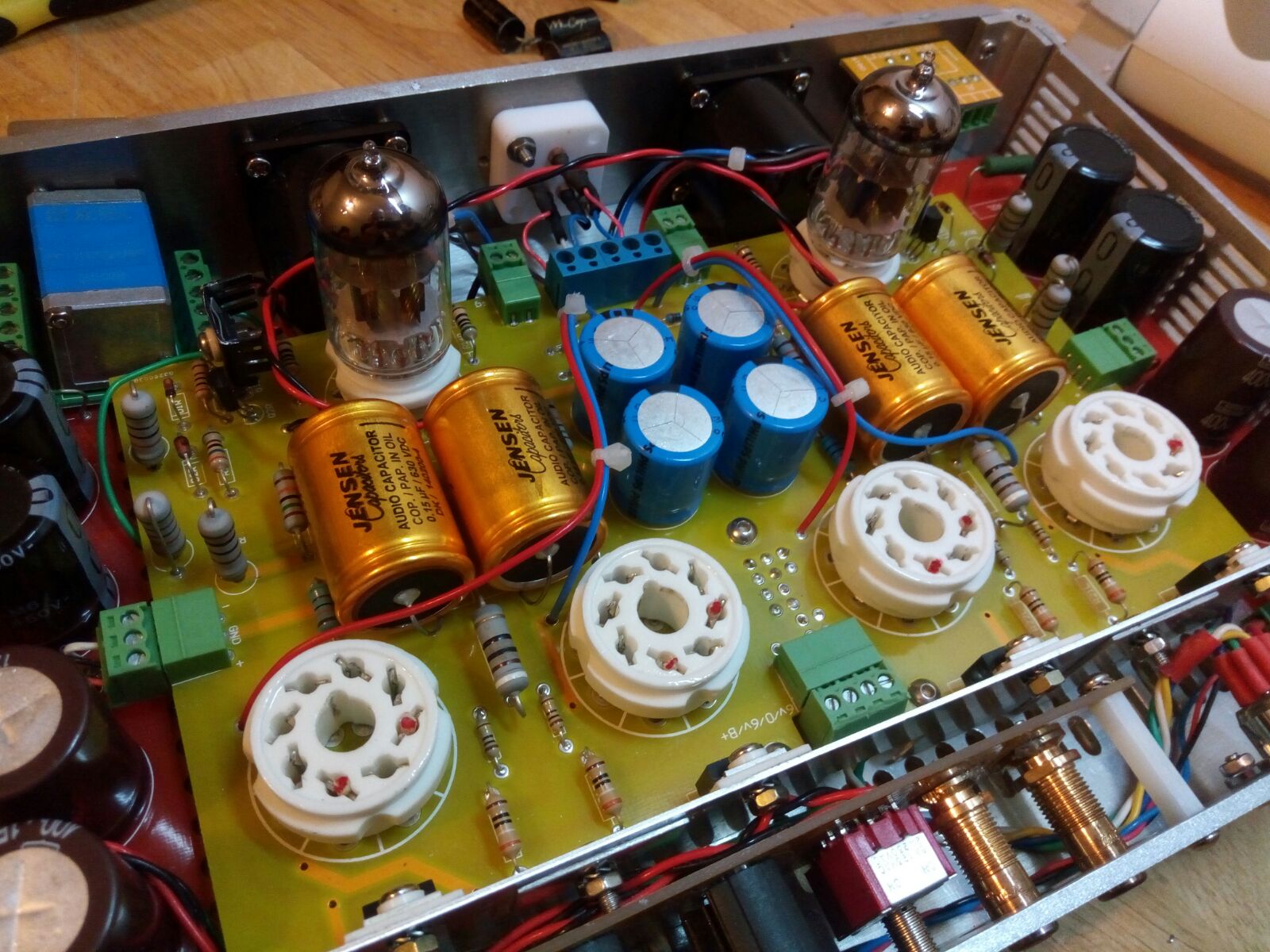

5 hours ago, Sechtdamon said:
Are jensen's are fake Antonio?
They are bought from hificollective.co.uk
https://www.hificollective.co.uk/catalog/jcs110-015uf-630v-jensen-copper-foil-tube-p-8414.html
I'm probably wrong, sorry Özgür. The font of the "audio capacitor" line seemed a bit larger and bolder than I remember in them. Why do you think the Jensens are better than the Mundorf Silver in Oil? I hadn't said so.
  • Like 1
Share this post
Link to post
Share on other sites
It's okey Antonio. For a moment you got me :) mundorfs were entry level one, not silver in oils. It's in test now, I'm going to listen it next week.
I hope it can drive 007s. :)

On 02.09.2017 at 9:41 PM, dsavitsk said:
Those leads look awfully close to shorting
I'll ask my friend for checking them. Thanks for feedback Doug. :)

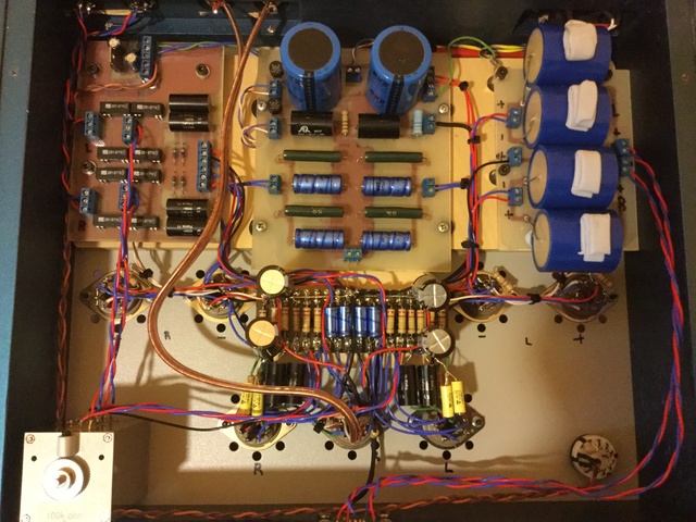

I was just reading HF and came across this "gem".
It's not an amp...it's a "musical instrument"!!  Yeah...what the fuck is it with Italian amps being garbage? Rudistor and now Megahertz...  Bask in the glory of this hand built masterpiece:

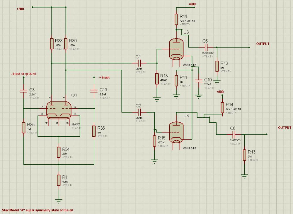

As soon as I saw this it was eerily familiar...  So back in 1968 Stax released two schematics, the SRX and a simpler two tube design with grounded cathodes.  Back in 2013 I released a schematic of a balanced take of that amp and built one unit.  It was ok for a cheapo amp but yeah...nothing that sets the world on fire.  Here is the schematic:
Ok so let's look into this.  Two 9 pin tubes so ECC83 input (pretty much has to be for enough gain) and any of the high power dual triode noval tubes.  6CG7 would work...  So we clearly have a resistor loaded output stage with a grounded cathode and output caps (the big ones) and high value resistors after the cap to ground.  The input is clearly balanced and not many versions of that possible with interstage caps.  Electrolytic cathode bypass caps for higher gain and those silver things might be the input caps.  Sure as shit there are four of them...
Now for the PSU and just the parts quality... this sure as shit doesn't look regulated or filled with quality parts at all.  I guess that and the mediocre circuitry makes this worth 1/2 of what Woo ask for the WES and a "musical instrument".
  • Like 1

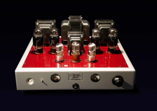

You missed the best one, the Guerra (Italian for "war"), which has...wait for it....output inductors.  Oh, wait, sorry, here's what the manufacturer says, "Although it may seem like our truncated circuit, it has been designed with great care and the output inductance has been realized as a high level transformer, on two holes, with different splits, just like a secondary output transformer!"
Outside:
Inside:
Looks like passive power supply.
Edited by JimL

why do the 2 pictures not match, specifically the input attenuator hanging out the bottom (or top) and the rotary switch?
definitely gotta love the Mikhail capacitor mounting technique.
Share this post
Link to post
Yeah, funny that the pics don't match at all.  Also, why 6 triodes to drive the output tubes balanced?  You can do it with 8 but 6?  I very much doubt it...
Well unless the middle tube is a phase splitter and it's just a two section amp?

Definitely unbalanced input only so middle tube is phase splitter and the other tube is a driver.likely just a push pull amp with a really big output transformer

Don't know about the pictures.  Copied directly from p12 of the HF thread "Stat SR009 and T2 successors confirmed for spring 2017"

Look at the input wiring, the XLR's go to the attenuator but the RCA's (I assume they are RCA's on the right) go directly to the middle tube.  So this is a pretty horrible clusterfuck of an amp...
Edit:  Yup, those are RCA's on the right:
http://www.megahertzaudio.it/guerra.htm

one other thing about that single input tube, both channels inside the same tube definitely reduce the channel separation.
and those monster stax transformers are obviously stax stickers attached to something custom.
