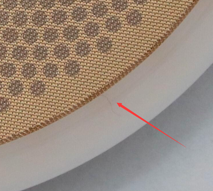

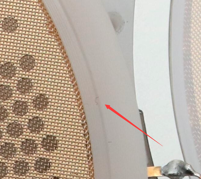

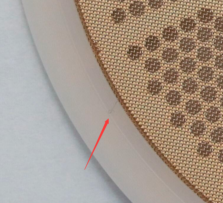

JoaMat Posted November 10, 2021 Report Share Posted November 10, 2021 It’s a small rip, a couple of millimeters. I guess a return for repair is the only option. But the headphone is not completely useless. I use Roon and its signal processor, -12dB on good side and +6 dB on bad (damaged) side. Playing at low to normal level the headphone sounds really nice. I imagine the small wound will grow larger by time. Changing the cable on 007 shouldn’t be a problem (knock on wood). 1 Quote Link to comment Share on other sites More sharing options...
Kung Posted November 11, 2021 Report Share Posted November 11, 2021 From the picture you posted, there are some flocs have been inserted into the driver house,yea, it is more difficult to clean up for the mesh stator...😬 4 4 Quote Link to comment Share on other sites More sharing options...
JoaMat Posted November 11, 2021 Report Share Posted November 11, 2021 Excellent, thank you @Kung. The evidence is clear. There are foreign objects, most certainly the cause of the problem. A replacement is on its way. My supplier is very helpful$$$ 6 Quote Link to comment Share on other sites More sharing options...
chinsettawong Posted November 11, 2021 Report Share Posted November 11, 2021 6 hours ago, Kung said: From the picture you posted, there are some flocs have been inserted into the driver house,yea, it is more difficult to clean up for the mesh stator...😬 Good eyes! Quote Link to comment Share on other sites More sharing options...

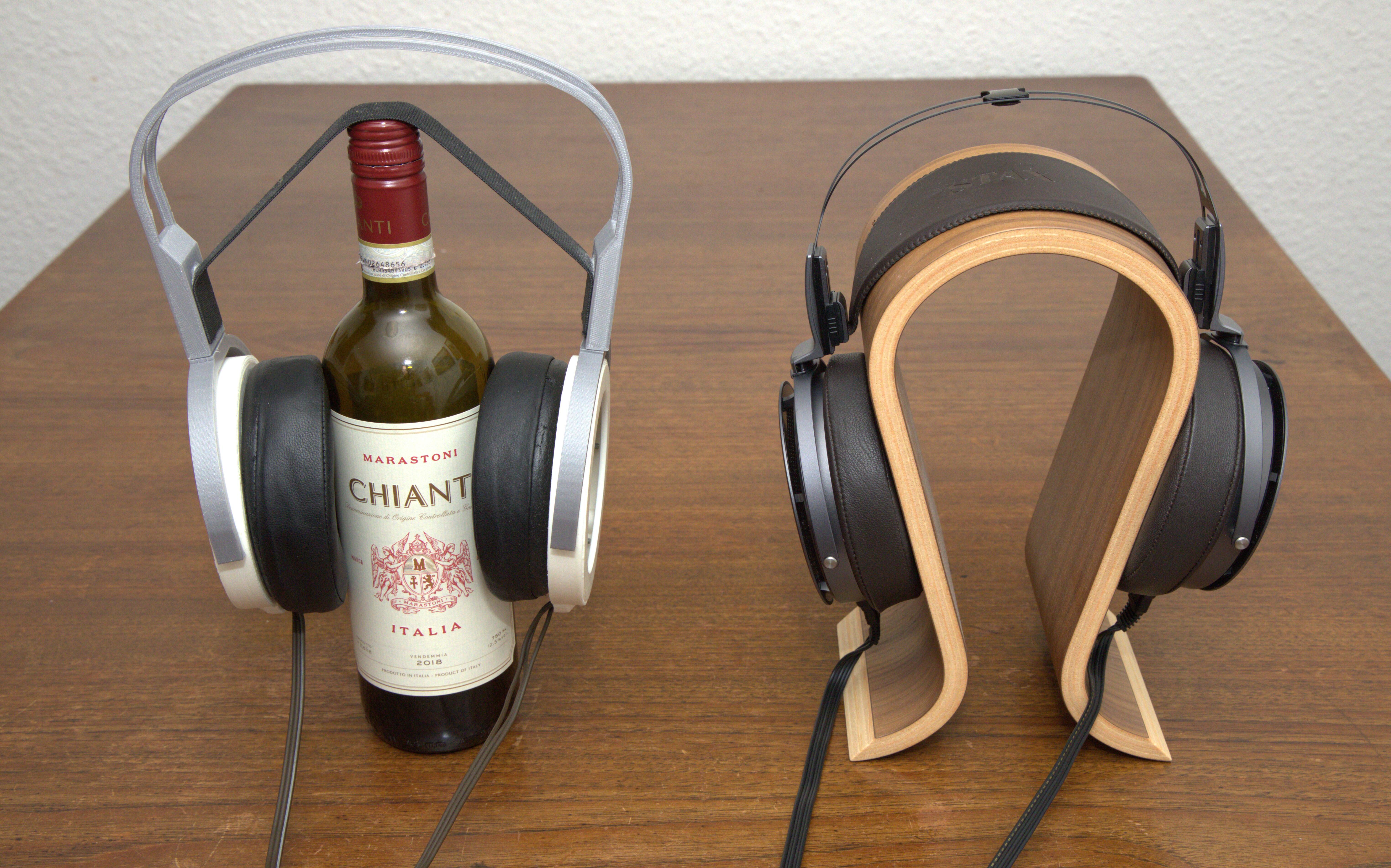

JoaMat Posted November 16, 2021 Report Share Posted November 16, 2021 While waiting for the replacement I today brought forward my home-built headphone which has been stoved away for a year or so. It sounds really good, even better than I remembered. Perhaps it ages as a good wine. Wonder what happens if I put it away in our wine cellar for a couple of more years? Original home-built Faulty Stax 7 4 Quote Link to comment Share on other sites More sharing options...
mdr30 Posted November 17, 2021 Report Share Posted November 17, 2021 (edited) 21 hours ago, JoaMat said: While waiting for the replacement I today brought forward my home-built headphone which has been stoved away for a year or so. It sounds really good, even better than I remembered. Perhaps it ages as a good wine. Wonder what happens if I put it away in our wine cellar for a couple of more years? Original home-built Faulty Stax A listen now and then might be advantageous. Aren't the bottles supposed to be turned every year or so? About to replace the cable of the 007 when I've got the Carbon together. Gamma will do service meanwhile. Thinking of moving the drivers to a SR-X MkIII, but don't know if it's worth the effort. On-ear not so comfortable. If the Carbon fulfills expectations the headphone to the right behind may be the next step. Edited November 17, 2021 by mdr30 Quote Link to comment Share on other sites More sharing options...
