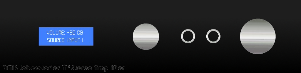

geremy replied to geremy's topic in Do It Yourself
I have attached my projected faceplate design. Inputs are appreciated! I'm not sure whether or not it is OK to use the AMB Laboratories name. Anybody know? Current Plan is for the case to be the Hifi2000 Galaxy GX348 with the optional 10mm front panel. The text is (hopefully) milled out from the plate. The knobs are also from modushop.biz, they are the 29mm for source/power and 39mm for volume/mute. The jacks are standard neutrik. I am considering adding the milled handles if that is possible on the galaxy front panel but I'm worried it may be overdoing it. -
