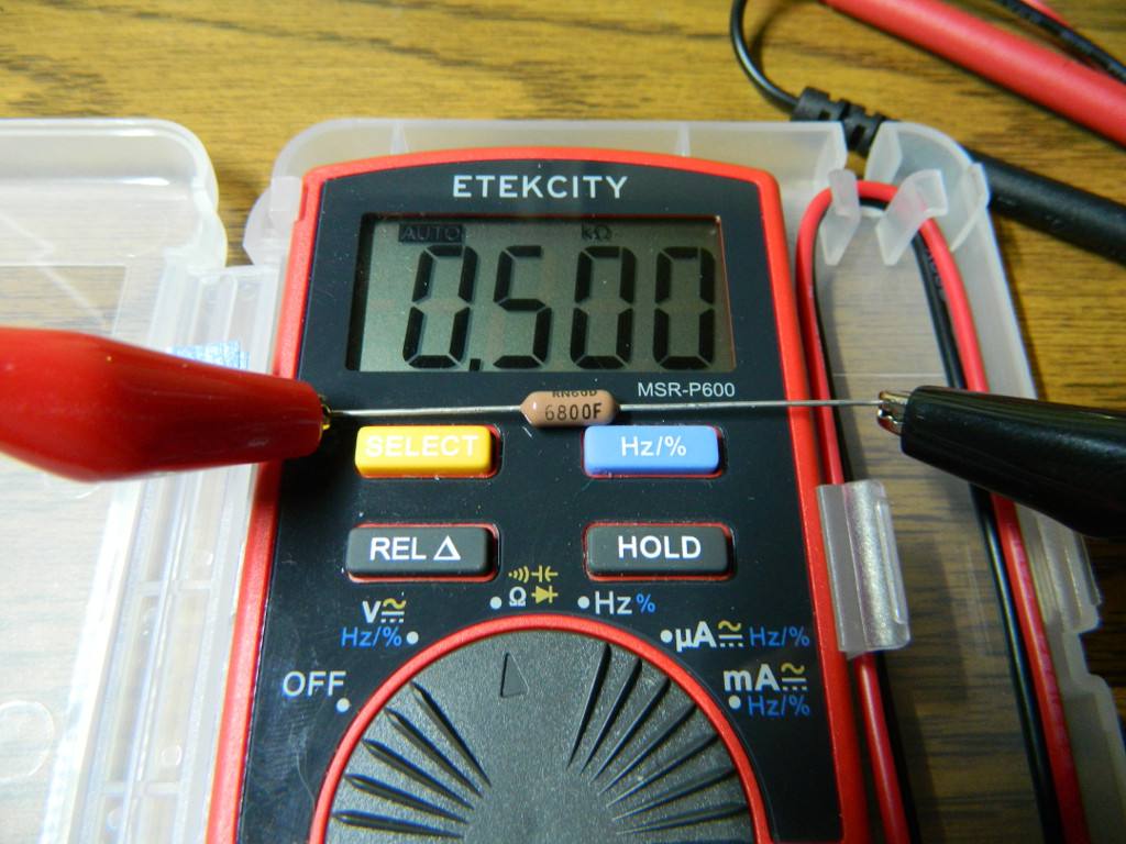

  7. I just had the cheapo meter handy for the picture. I checked it with my Amprobe meter, and it measured 500 ohm. The rest of the pack of resistors (from Mouser) measured between 674 and 680 ohm, perfectly within spec of 1%.
  8. 1st post here. Getting ready to go ahead with the build, waiting for the PCB from ebay. I was checking resistors and I found this: I have never come across a Vishay resistor this far off (please no comments on the crappy "multimeter"). Will update once I get the build underway. Thanks KG!
