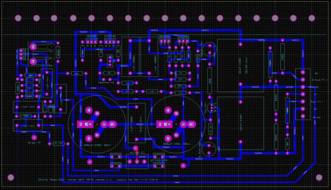

  2. Hello Jim, I'm building your own version of SRX amplifier and your shunt regulator PSU. Before ordering the transformer I would be sure of the necessary AC voltage. On the shunt pcb there is AC700 CT If VDC = VAC x 1.41 350-0-350VAC = 490-0-490VDC and if the shunt drop 20VDC I think the voltage is too high. Then the transformer should be 260-0-260VAC, correct? (200mA be enough?) Another question: how do I adjust the CCS shunt 10M90S-DN2540? What should I read on the 10ohm test resistor? 0.4V? 0.5V? Thank you
