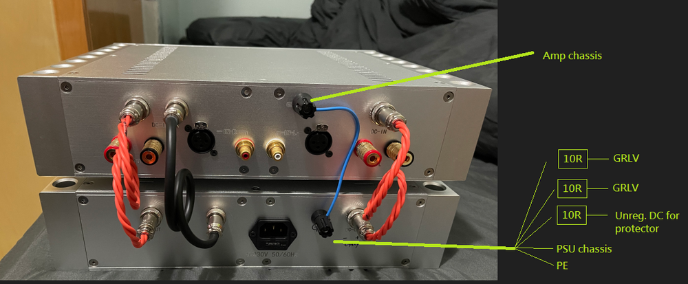

	and now for something completely different part 3EL_Ken replied to kevin gilmore's topic in Do It Yourself Had done isolations between sands and heatsinks. And then finish casing the PSUs (PE connected to case). When I powerup GRLV alone, DC voltage goes wrong and pass transistors dead. After checkings, I find GND on one of the GRLV shorted to case. Top green insulation layer of pcb (near mounting hole)is damaged. This short GND and case through screw. So I thought that's the reason the transistors dead. Maybe the transistors were damaged by desoldering, had to resolder them to fit the case. But none of the circuit connected to PE will cause risk of electric shock. And proper grounding can block out noise. And I found some of your words said before. Hope my drawing below is understandable. GND: Splitboards > 10R resistor > amp case > extra wiring to PSU case > PE
	and now for something completely different part 3EL_Ken replied to kevin gilmore's topic in Do It Yourself English isn't my native language. Hope I didn't misunderstand your words. That's mean don't connect circuit ground to PE, right? PLT-163 connectors used for DC in/out. 3pins are +30V / circuit ground / -30V respectively, none of them connected to case. I had once mis-connected circuit ground of GRLV to chassis, and killed the pass transistors. So, I think circuit ground should not be connected to PE/chassis. Now the whole system is floated from PE/chassis. None of the circuit are connected to PE or chassis. Sorry for my ignorance and please correct me if something wrong.

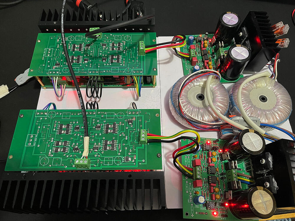

	and now for something completely different part 3EL_Ken replied to kevin gilmore's topic in Do It Yourself Just finished casing. Case size 360*270*86mm (inner 280*255*73mm) Dual GRLV ±30V Extra DC supply for attenuator, relay boards and Protector. Ship-in-bottle-like building experience with small cases and multi layer PCBs. Some very soft cables would make it easier. Difficult to adjust those trimpots on splitboards after casing. Better to do the adjustment before casing. Spider webs at the input state is a mess. Better-designed PCBs can reduce half of the cables. Will fix that after I get a new back plate and PCBs.
	and now for something completely different part 3EL_Ken replied to kevin gilmore's topic in Do It Yourself Output transistors are MJE15032G/15033G, extra insulation is needed. Size of the heatsink is 200x62x40mm, ~50°C with 120ma bias. It could handle more heat but I need larger heatsink for GRLV. The nichicon kz cap (Ø:12mm) is too big so one has to lying down. Edit: one more pic added

	and now for something completely different part 3EL_Ken replied to kevin gilmore's topic in Do It Yourself Just finish soldering my split boards. There are some problems happened dual to my bad SMDs solder technique. IF non-wetting happens / flux not clean-up between pins, no bias from 1R resistors and all output transistors not heating up; and very high DC offset can be measured from output to GND (~10-27VDC). I resoldered all the SMDs to fix this. After that I powerup my spirtboards, an 1R resistor heats up quickly and smoke comes out. One of the output transistors(Q17) shorted, replace it and no smoke again. Finally I test the split boards with a pair of speakers and HD600, both speakers and headphone sounds very well. But when I test the boards with my DAC and preamp which have ~100ohms and ~1ohms output impedance respectively, a 10k pot can only adjust volume a bit , only a little volume change from 10kohms to 0ohm; sound still comes out at 10kohms. A 50k pot could fit but some previous works in this post use 10k pot. Did I got some mistake with my work? Edit: A 10k pot can adjust volume from no to full with proper wiring.
