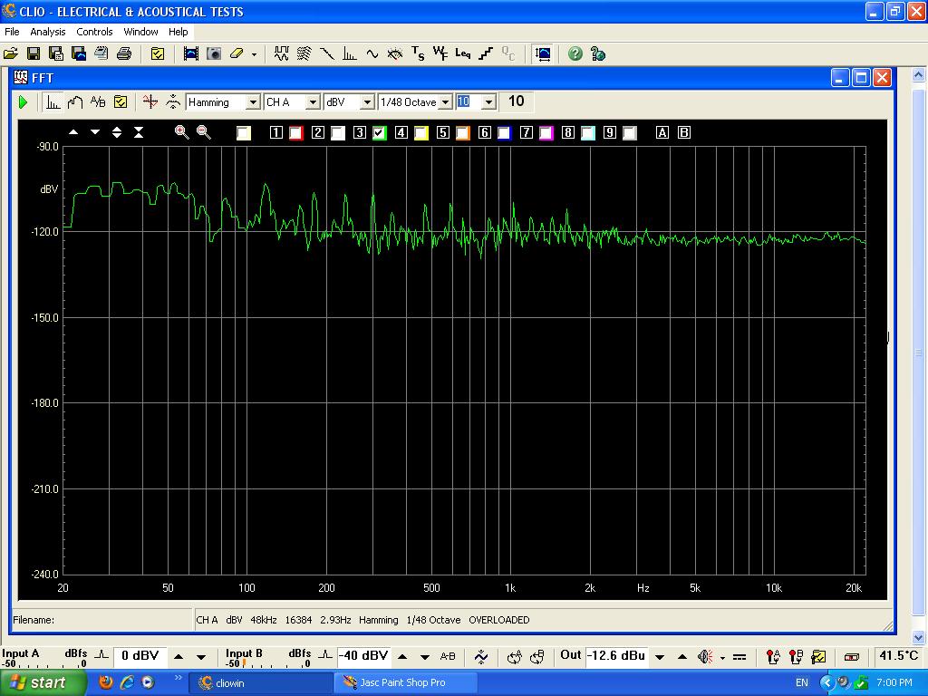

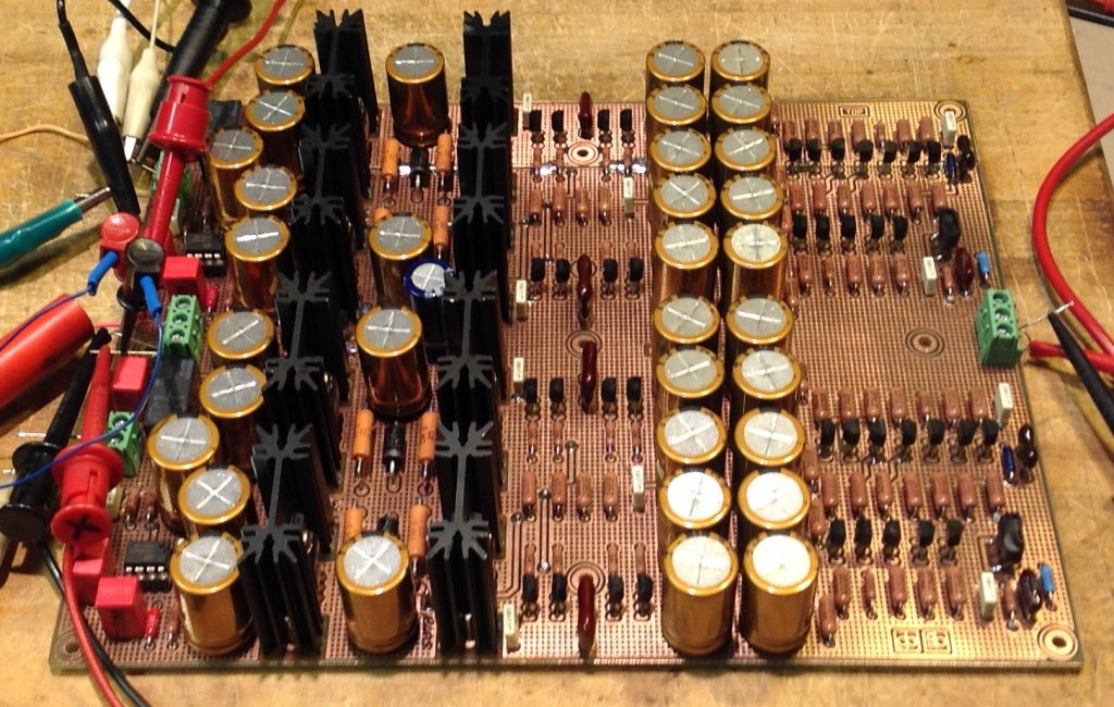

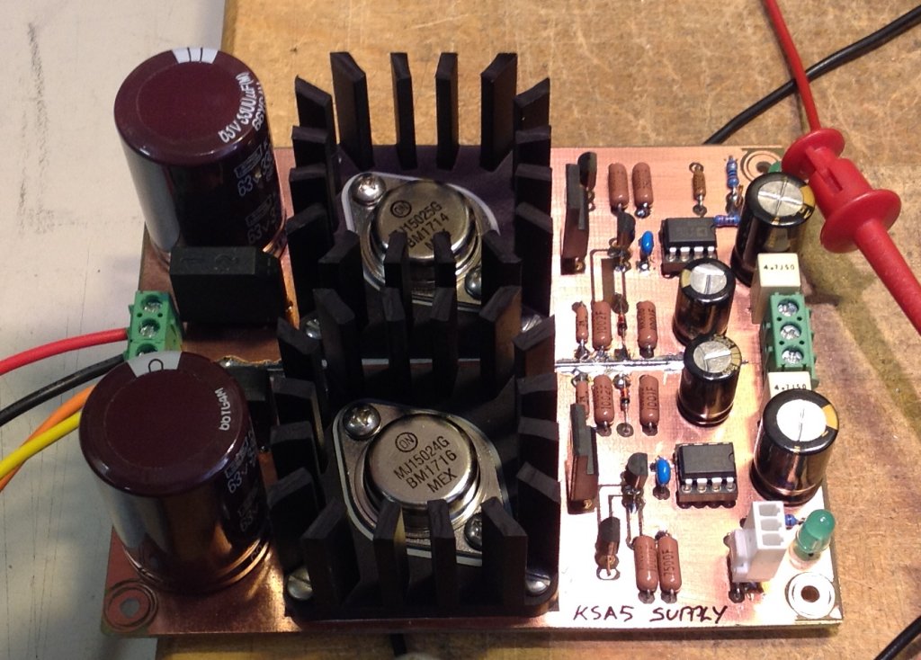

  1. Hi. Just completed my own set of PCB for this amp, see pictures. I also took detailed measurements. Here some measurements: Sensitivity: 1.25Vin max, for 6.9Vac Out Max. into 8 ohms Power: 5.95W into 8 ohms max. BW (Ref 1Khz, 1V): 0.3Hz to 145Khz Noise (gnd input): 0.08mV (Lab. power supply), 2.2mv (Standard Supply), see graph THD (1V, see load): 0.042% (8 ohms), 0.007% (16 ohms), 0.008% (no load), see graph IMD (1V, 1 & 2Khz): 0.007% (16 ohms) In normal use, max volume, gnd inputs, no noise can be hear... You can see the complete files at http://www.diyaudio.com/forums/headphone-systems/109618-krell-ksa5-9.html
