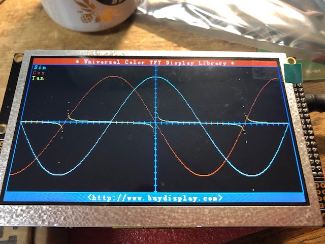

I got the no touch test pattern on the 5" display to work.
For those that are new (myself included), here's what I did.
Download the example file from buydisplay.com.
Extract it and the copy the UTFT folder located in Libraries-Examples_ER-TFTM050-4\Libraries into the Libraries folder in the Arduino folder under My Documents (Windows).
Open the .ino file located here Libraries-Examples_ER-TFTM050-4\Examples\No_Touch_GraphicTest
compile and upload the code
Remove the usb cable from the programming port
Assemble the shield, screen, and arduino together
Plug a 7-12 Vdc 1A or more power source into the power socket on the arduino board
It should display the test
