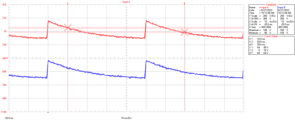

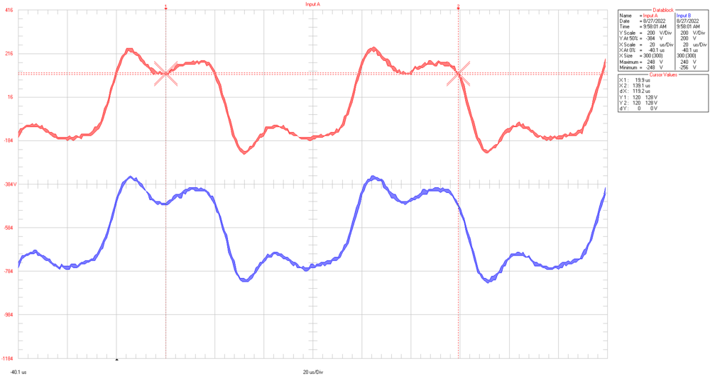

  1. I can put a square wave into the transformer and see what level trips the Zener and how quickly. And the effect on the system. Given that it's the high impedance winding, even if i don't put in a resistor, it would seem to me a kind of current limiter.... just a thought, not my field of expertise.

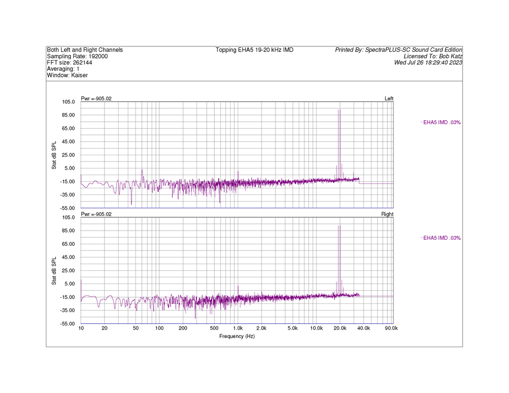

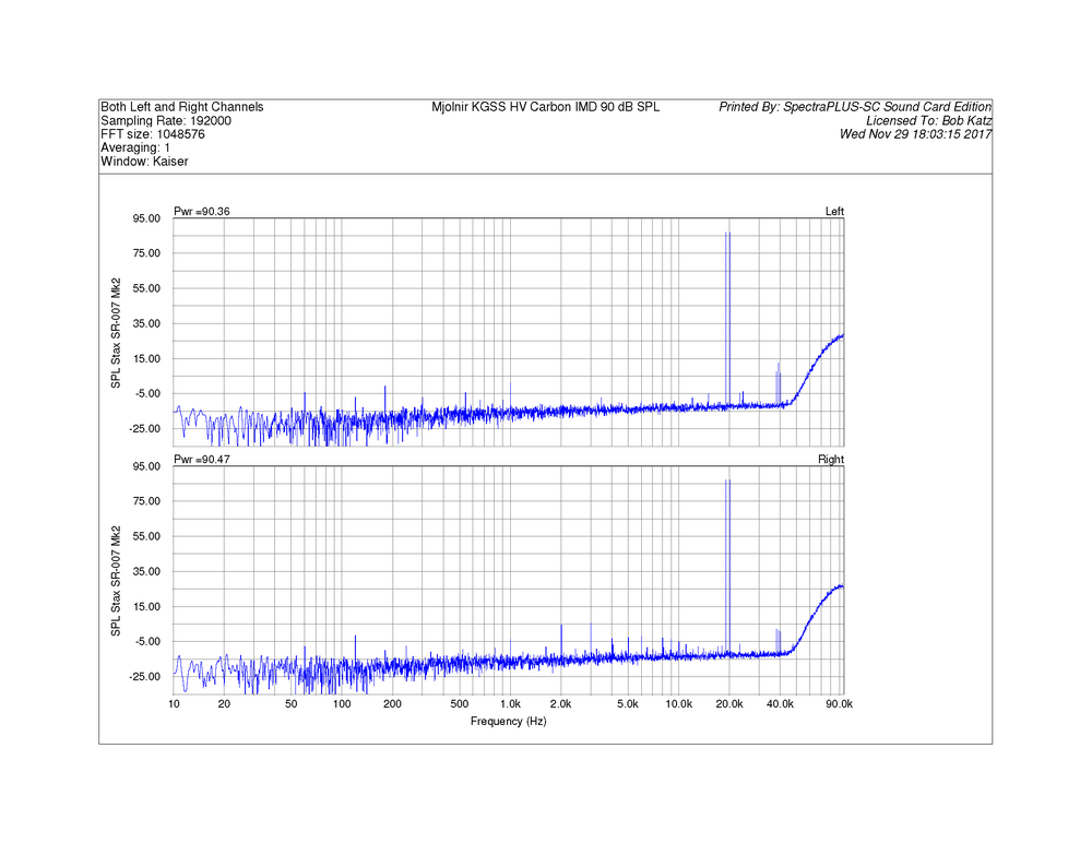

  9. Thanks. That's what I was afraid of. Keep in mind that the intermodulation distortion I saw in the Topping amp concerns me. I think that's the amp module, not the transformer as I don't think IM is a typical component of a transformer. If the TPA amp sounds and performs like crap I'm only out $10 each and I'll seek another solution. I'm thinking an alternate amp solution that I can handle and implement conceptually is a +-24 volt power supply with a pair of 990-style opamps in push pull. A 990 can deliver 13.8 volts RMS into 75 ohms so it's a pretty powerful discrete opamp. I found a 33:1 transformer so basically if I want to get to max of 600+ Volts RMS/sine wave I need nominally up to, say 19 volts RMS in. That's 19.8 volts in push pull. And as you all know, push-pull helps cancel even order harmonics, which could help the purity of tone. Again, if I don't like the 990 approach, I'll try something different until I'm happy with the sound 🙂 Back to the clamping zeners. Does anyone have a value recommendation and a simple orientation schematic? Thanks!

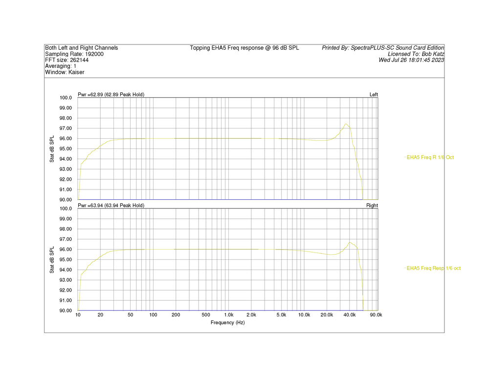

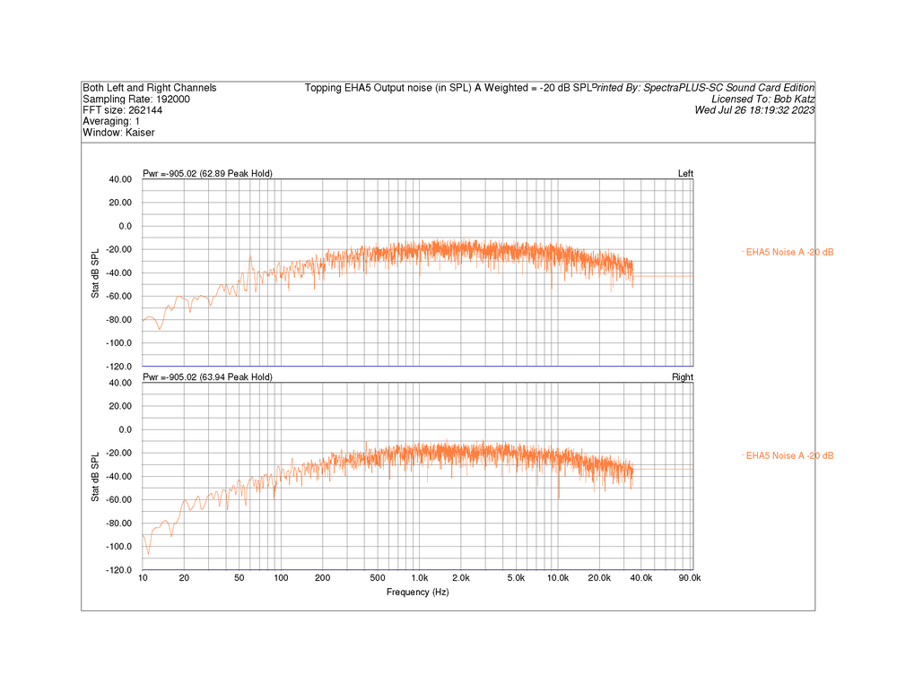

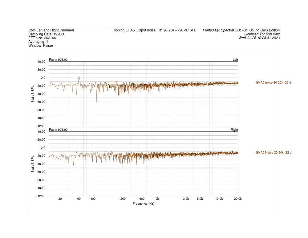

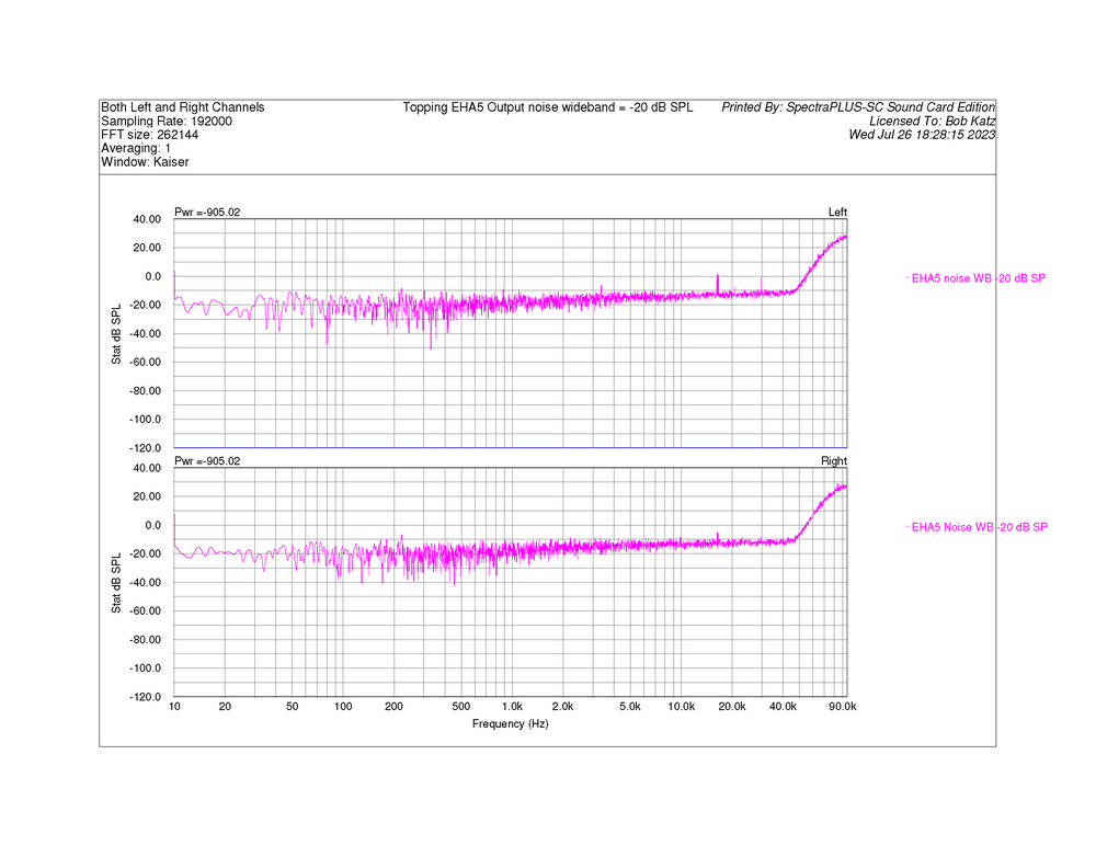

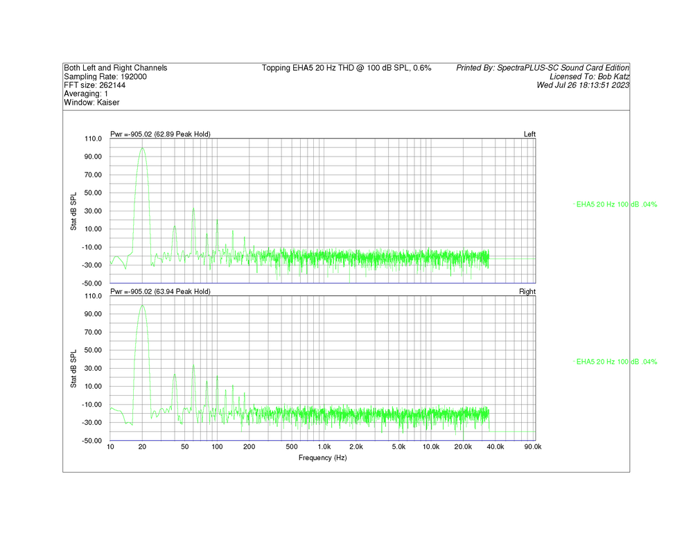

  11. Background: Just for fun, I'm going to build an energizer using a small Class-D power amplifier and a transformer. The inspiration was that I'm basically junking my recently-purchased and rejected Topping EHA5 and O can use the chassis and connectors. The rest I plan to junk. I bought a high voltage DC-DC converter for the bias voltage and a pair of toroidal transformers meant for a tube amplifier. The transformers are so big I may have to mount them on top of the Topping Chassis! For the amp I'm hoping that the Texas instruments TPA3116d2 Class D chip will do a good job. If I don't like the soun of this chip, I'm only out $10 for a populated board from Amazon!!! OK, if anyone can help, please, I'd like some advice on clamping Zeners for driver protection. Cribbing from a Stax SRD-7 schematic I see ZL01 through ZL04 but it doesn't give the values or the orientation of the Zeners. If possible, it would be nice to pick a value that will protect the headphone but have no sonic effect on headroom or impact. Many thanks in advance for any advice!

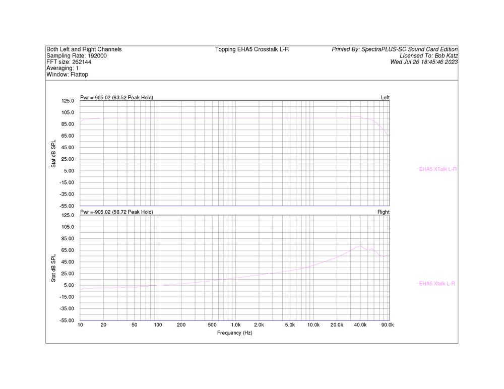

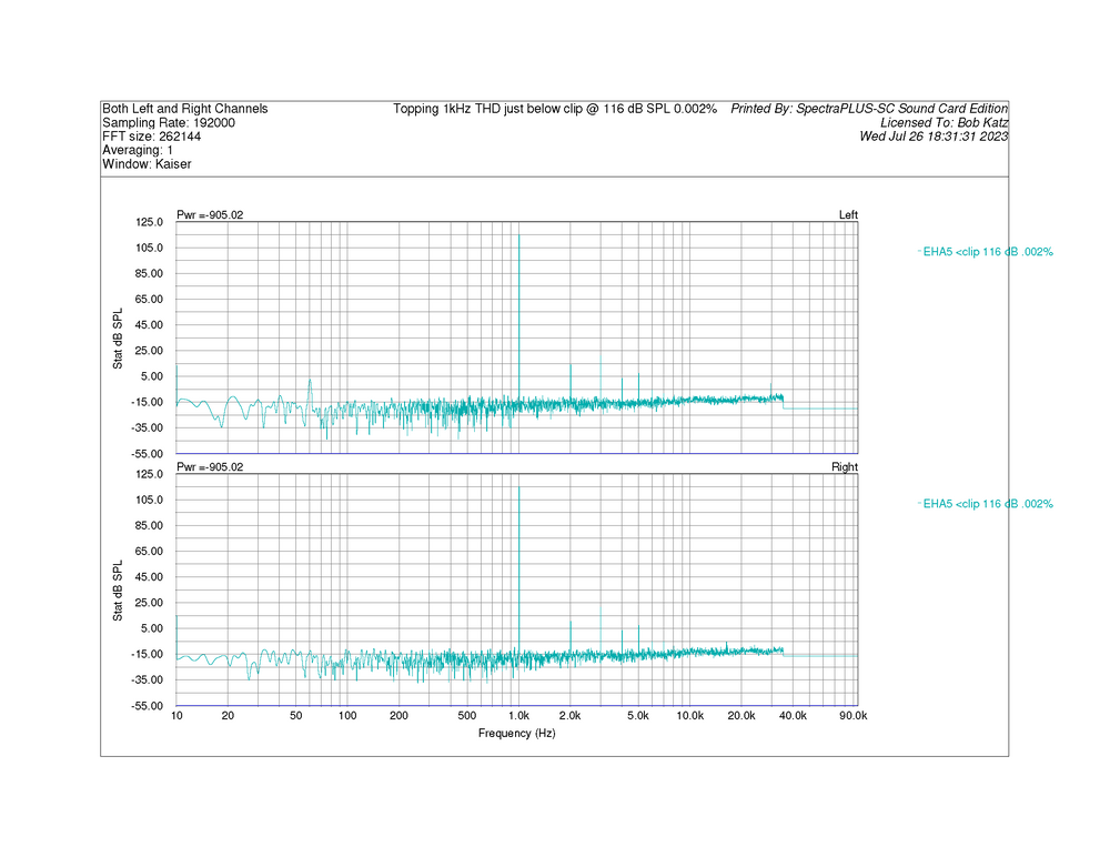

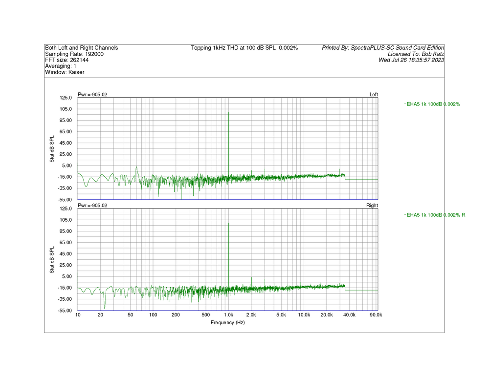

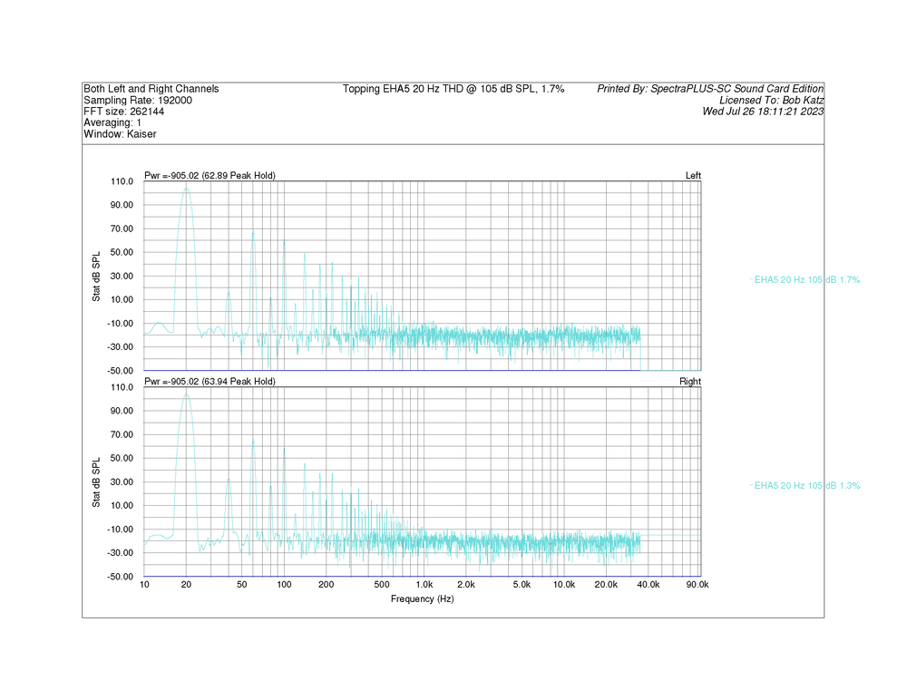

  12. I'm sorry that the BBS interface does not show the names of the files. The unlabeled ones are square waves at 1 kHz, 10 kHz, 20 Hz, 100 Hz. Next time I upload I'll annotate all files in the GUI 🙂
  13. My pleasure! Just uploaded the Mjolnir measurement. Put the Mjolnir and Topping pictures side by side!
  14. I bought the Topping and got it this week, with hopes it could be a second or extra Stat amp. I was even planning on doing a "bargain stat amp" feature at my new journalistic home "Positive Feedback", where you can find my review of the Audeze CRBNs, for example. Anway, I'm not going to publish, I don't like to publish reviews of bad gear 😞 What a disappointment this amp turned out to be. My disappointment came in stages. The first stage was an optimistic listen: "Hey, not too bad". At that time I was listening to some simple classical and folk arrangements: with solo voices and guitar, the weaknesses of the Topping circuit are not immediately obvious. But as soon as I played more complex music, full orchestra, rock band, you name it. Where it starts to get real harsh, bloated, lose dimension is with complex music, full orchestra, rock band, you name it. The more I listened, the more I started to hate this amp. I WILL BET THAT THERE ARE MEASUREMENTS THAT WILL REVEAL THIS AMP'S WEAKNESSES. You just have to know how to find out where the bodies are buried. I did find some that clearly show its weaknesses. Attached below. Frequency response (with a 100 pf load), Output level just before clipping, THD at various frequencies at normal levels and just before clipping (spectrum and %), IMD (19-20 kHz) (spectrum and %). The one thing I should have measured is a special multitone signal I use, I bet that would show where the bodies are buried, and tell us why the amp falls totally flat the more complex the music you put into it. But I'm so disenheartened and disappointed by the sound of it that I don't have the energy to bring it back to the test bench. I like to display an amplifier's measurements in equivalent SPL, based on Stax 007 and CRBN nominal sensitivity of 100 volts RMS = nominally 100 dB SPL. It helps bring a real-world perspective to amplifier measurements. Topping Factory spec for max is 700 volts RMS (I suppose the factory took this a cat's hair below clipping and only at 1 kHz). I measured maximum output at 1 dB below clipping at 630 volts RMS at 1 kHz, equivalent to 116 dB SPL. But When performing the 20 Hz THD test, the amp's DC protection circuit kicked in and the most I could get out of it at 20 Hz with a continuous sine wave was the equivalent of 105 dB SPL, 177 volts RMS before the amp shut down. So the lower the frequency, the worst the amp's headroom for transients. Plus, the THD at low frequencies is pretty bad, the transformer saturates very strongly. To see where the skeletons are buried in this amp, take a look at my measurements. The measurements to really study is a comparison of the Mjolnir KGSS HV Carbon and the Topping at nominally 90 dB equivalent SPL of IMD 19-20 kHz 1:1 ratio. I think that lurking in that measurement is at least one of the reasons why the Topping sounds so harsh and the Mjolnir sounds so pure. The primary difference tone at 1 kHz in the spectrum does not tell the story. Notice the high frequency side bands near the 19-20 kHz that begin to reveal to us the Topping's nonlinearities. There's more in the attachments. I'm sorry that I didn't do the multitone, I will some day, when I get around to it, and I'm sure it will reveal the skeleton underneath the "golden glow" of this amp. The date in the Fluke scope pictures is wrong... it's actually yesterday, 7/28/23. I have to fix the date in my Fluke Scope. Every time the battery dies, it loses the date 😞
