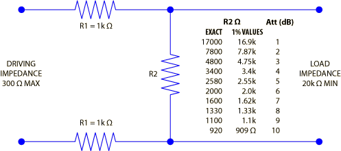

  2. So will a 100pF 1KV cap across the + & - output do it? Is 1M high enough? With a balanced attenuator like this (but with high impedance)?
  3. I have access to an Audio Precision analyzer, but I have never measure an amp for electrostatic device. Do I need a dummy load?

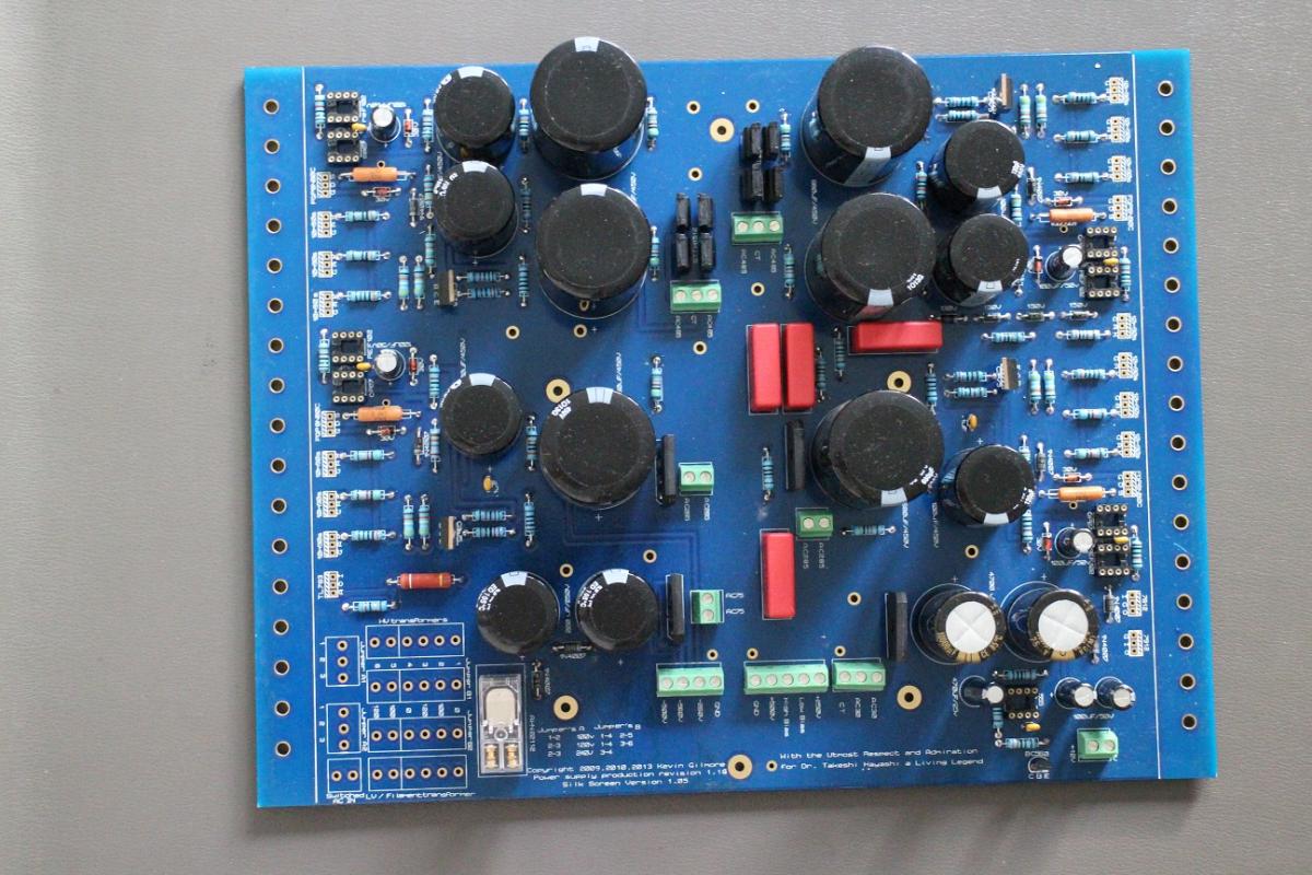

  5. hi luvdunhill, thank you for the suggestion. which cap I need to remove? if you mean C12 or C13, then yes, I knew I populated both of them. I was stuffing the board late at night, and didn't realize I put both of them on until I soldered them down. I should remove them before I forget about it. Thanks anyway!

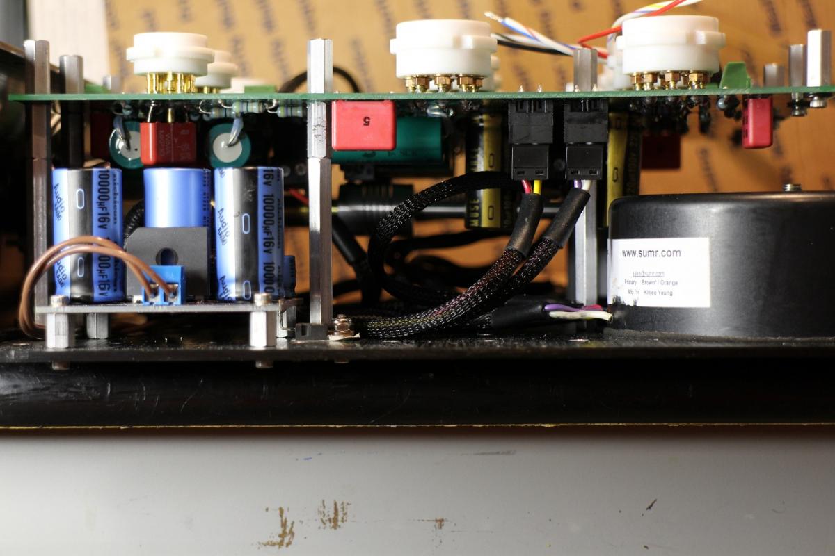

  6. Thank you guys for the encouragement. I left my SD card at home, but I have a few inside shot of the amp. I used good quality components: Alps RK50 pot, Takman REY resistors, Solen FEP Teflon caps in the signal path, WIMA bypass caps, Nichicon Audio caps, Teflon tube sockets. I made PCBs for the 300V power supply and front-end DC heater. Transformers are from Sumr. Chassis are ordered from eBay.

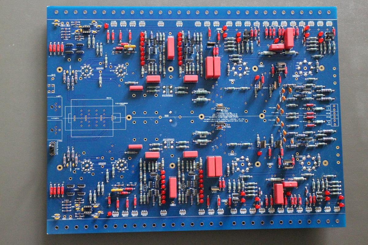

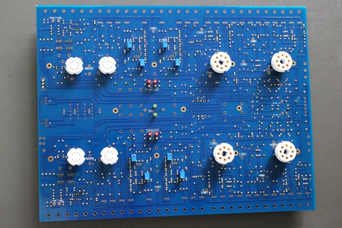

  7. Indeed I'm ready. T2 boards are fully stuffed. I'm waiting for the chassis from Tran.

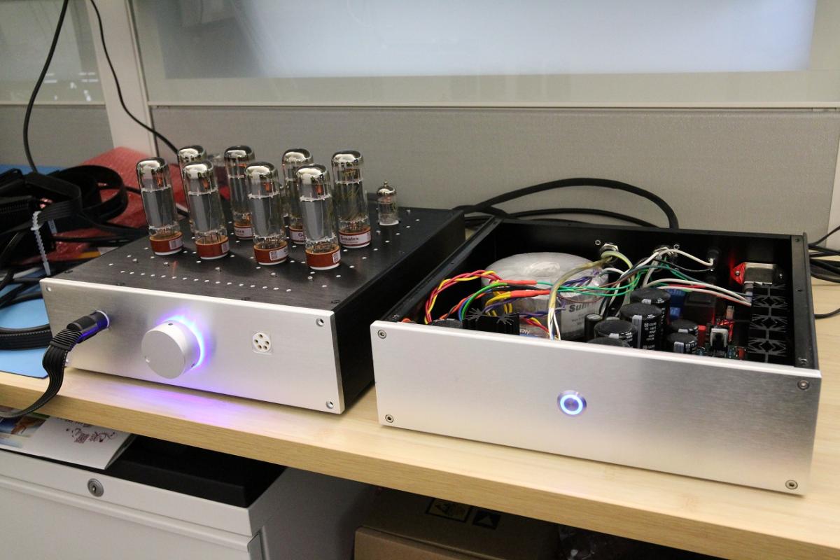

  8. Thanks! It is my very first tube amp. Thank you, Kevin and the team, to share your work. You guys made the world better! I also have the KGSSHV 500V. I prefer the Megatron, especially with SR-009. Now only if I can locate Tran, then I can finish my T2 build.
  9. A few pics of my Megatron...

  13. I'm using the Antek 400VA 430V transform in my KGSSHV build. It is temporary until SumR finished my transformer. In this particular application, the transformer is always quiet and cool. I didn't use the filament windings. This weekend, I will bring up my Megatron build with this transformer (again, waiting for SumR for the proper one). I'll let you know how it goes.
