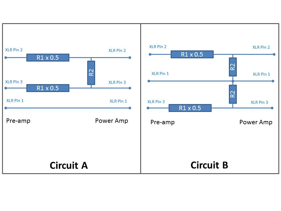

    The drawing is from DIY. There was a discussion which circuit is better.(B they say).I used the online calculator in the link.

    After work I have done some soldering. This site gives lot of information http://www.sengpielaudio.com/calculator-voltagedivider.htm. I made an attenuator with resistors I had by hand.I used circuit B .With two 10k seriesrisistors and 5.6 parallel. The attenuation should be 11.5dB. I think it can even a bit more. 12.00 o'clock is now OK with classical music, but much too loud with modern pop music.Older pop music is not so loud.

    Thanks Laowei,now I understand what Kevin meant with the Neutrik connector. The problem is I don't have enough space behind my amp.I already use angled connectors. Besides I think it is a bit overkill.I only need 6 resistors to attenuate the signal. I have done some new calculations: line input 10k, attenuation 10dB, R1 & R2 2700 ohms, R3 3300 ohms.
  23. meeskees replied to kevin gilmore's topic in Do It Yourself
    Don't know how to do this with the Gungnir . I am not sure about the calculations. With the 10k series risistors I calculated for -10dB 9.25k for the parallel resistor. Are these a reasonable values?
