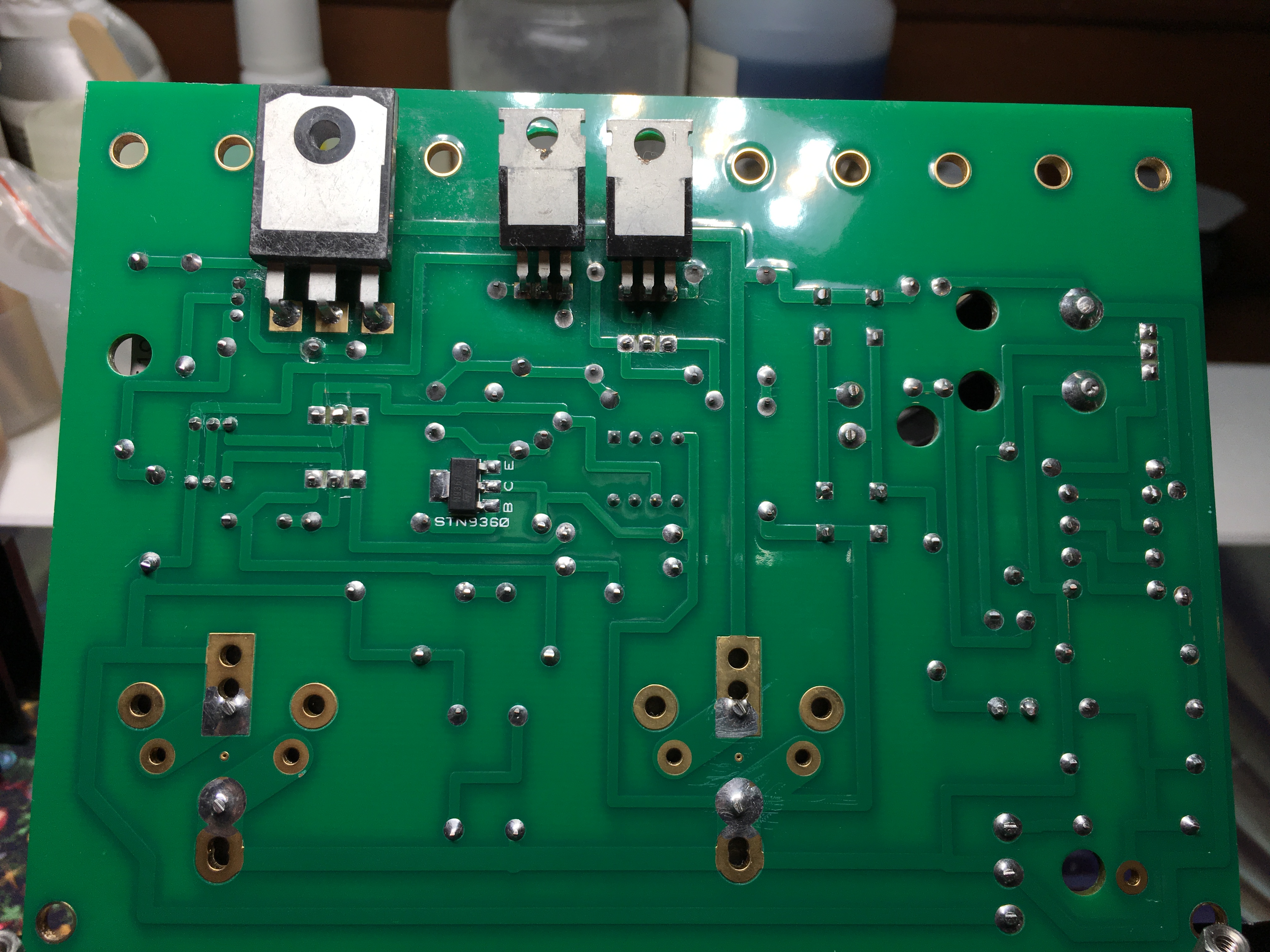

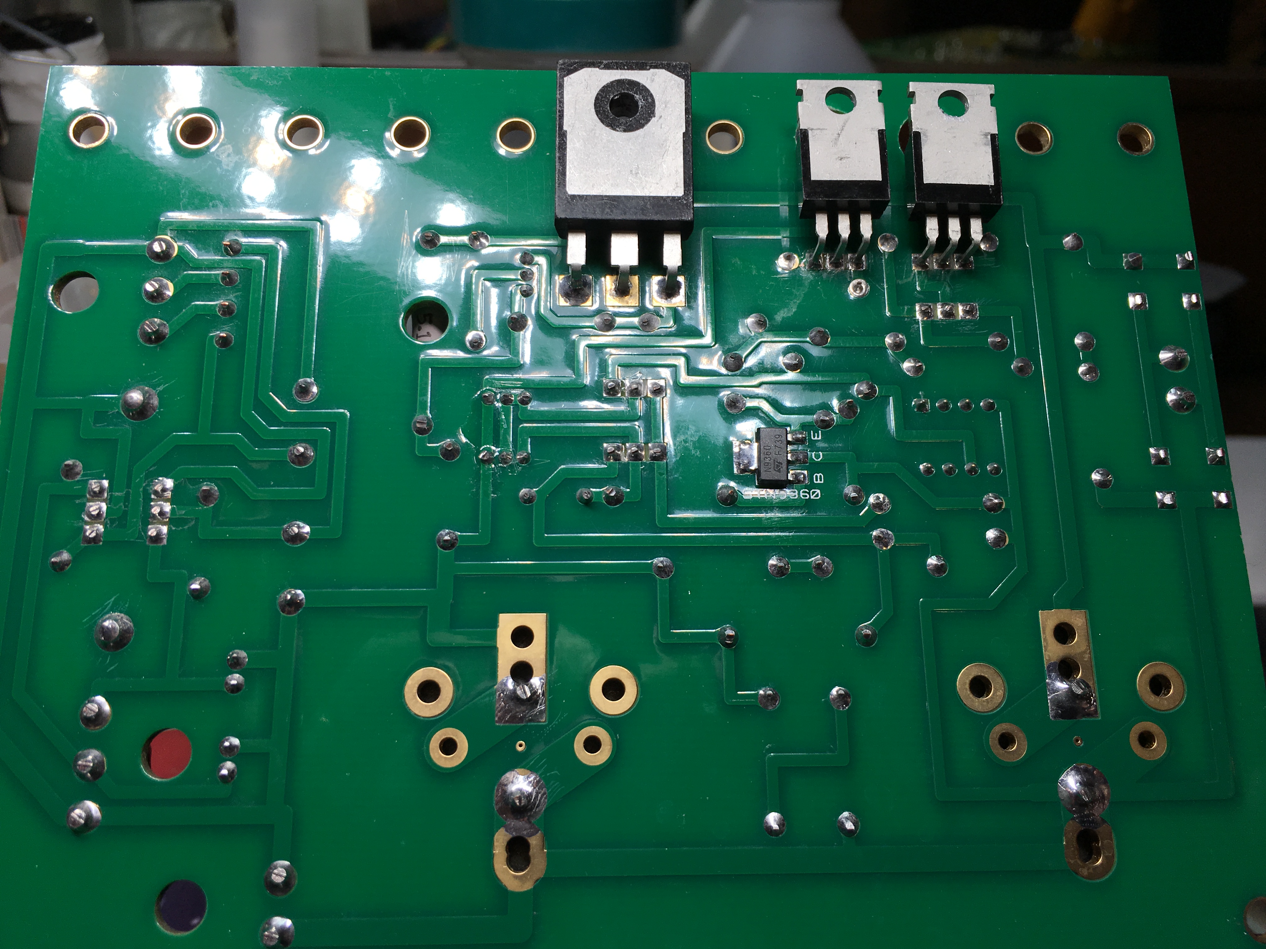

  3. These 1st 2 photos are the front and back of the board I’m trying to fix right now. The last 2 are of the board whose 10m90s popped at full voltage. I’ve just finished cleaning most of the thermal paste off. There’s lots of scratches on the back from where I had scraped off hardened flux spots.
