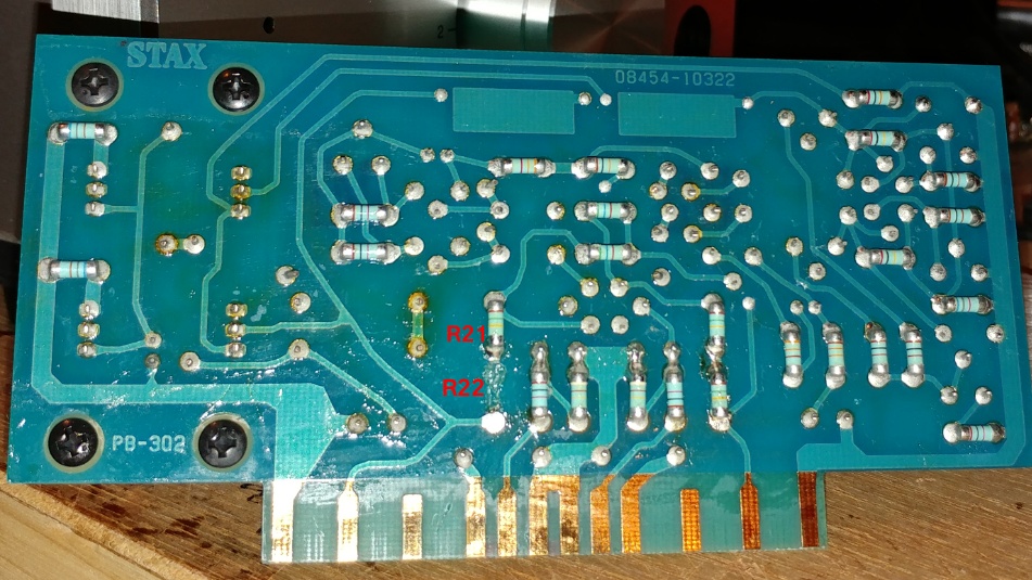

My 727A mod is successful I dealt with the glued pieces by digging underneath them with an xacto blade, then broke them off a half at a time. Just getting the first one took longer than the other three combined. It was probably about 90 mins of actual work. I'm trying not to worry too much about the differences and trying to just listen and enjoy it for now. It takes me anywhere from two weeks to to two months to truly evaluate gear, and rushing usually does the opposite of help xD

Wait of course they're just in series. I can see that on the other side! I'm going to go do something else for awhile If anyone has any ideas to deal with the glue, I'm all ears still. It would be a lot easier to just cut the resistors in half and worry about making it look nice later
Long time lurker, first post here Did I mess up my Stax 727A feedback mod? I think I'm okay, R21 and R22 are in series, correct? As long as I didn't tear off an essential trace where the top of R22 was I know where to go next. I have the old boards with the resistors glued on I figured I might destroy that resistor during the removal, and I have a replacement already on the way. Any tips on dealing with the glue on the other three I still have to pull?
