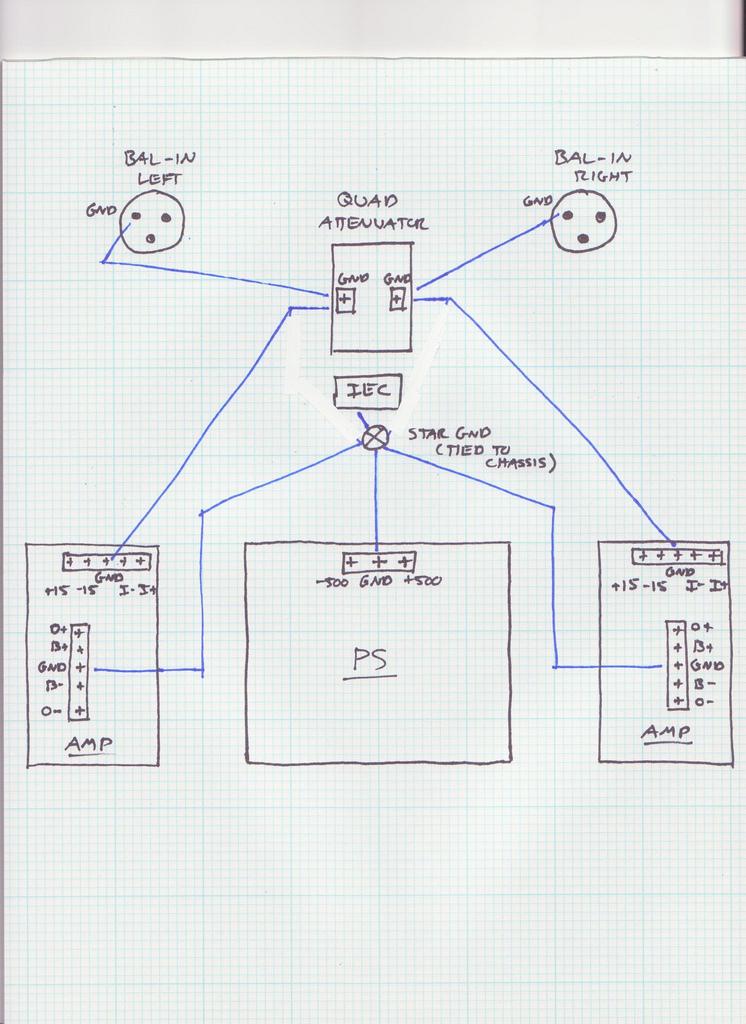

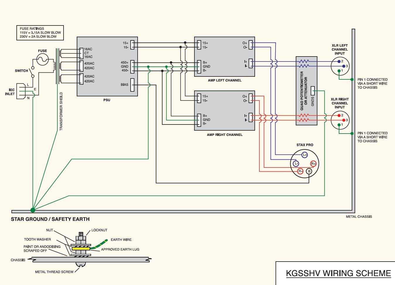

	Now at a wiring up stage and one thing confuses me, and that is the grounding scheme. Numerous versions seem to be posted (two examples attached). Using the GRHV boards with the LV supply on one, there will be an additional ground to I presume the star ground. Does anyone have an opinion as the best grounding scheme? Regards
