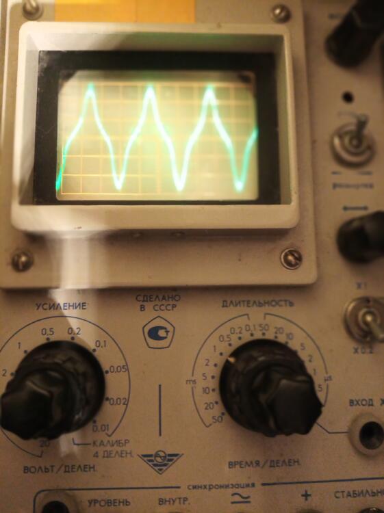

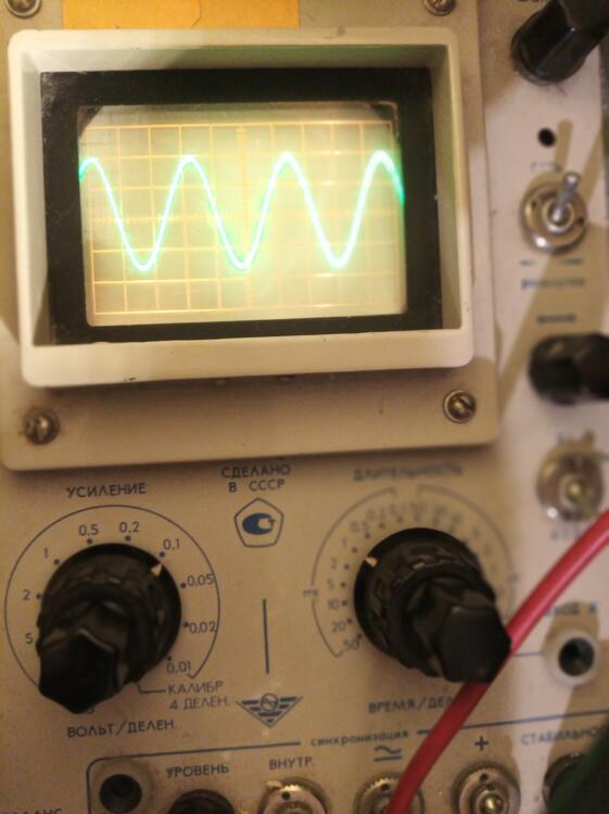

  3. filed 220, 400, 460, but alas, the result is not happy. !!! fed the input BALANCED signal 0.35v, photo 1. the output received a swing of 82v and 84v, but in terrible condition, photo 2 P.S. I get an undistorted signal with a swing of 20v at the output if I input 0.170v It's not enough for headphones.

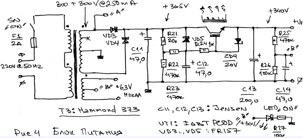

  16. I looked it up, the transformers are approximately clear. thank you. I do not see in this thread the circuit diagram of the power supply for the mini.
