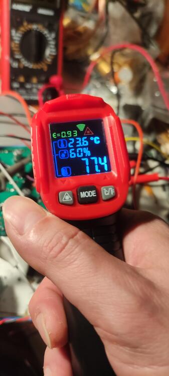

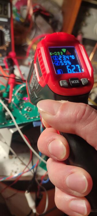

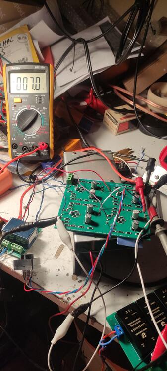

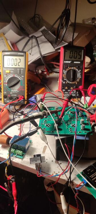

I guess it should be max 10mA. These bricks output max 20mA. If we take only the right or left half, the upper amp (+) draws 10mA, that are "vacuumed" by the lower PS (-400V). Then add other 10mA for the lower part, and you're at max acceptable draw. I'm testing with the 10k pot, until now it drew really more than 10mA, so the PS started "pulsing" under my dim bulb tester. I'll keep you updated.
And so, yes it is, quite unstable due to drifting. Problem is not the PS, it's that the current draw grows slowly with time, then it begins pulsating, then flames or short. I'm now assembling the stabilized version with dn2540 and pot, so that you can dial in the desired current, yet I'm having some issues with that, but as said, I started this morning (and now it's early afternoon). Who sold this unit made the error of "marketing" it too early, perhaps not testing nor listening at it. Here it's all about patience, testing, doing it better and listening. So probably a new PS will not solve the issue.

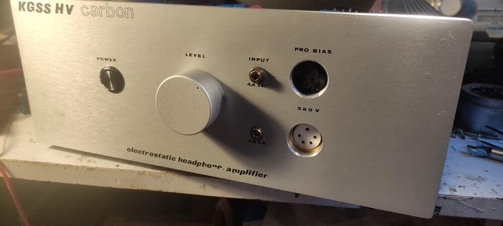

Michelag started following KGSSHV Carbon Build Thread
Thought I never shared pictures of my build, et voilà. Those 3.5 and 4.4 input connectors on the front do really a pragmatic job... I fit a normal bias plug (thanks @JoaMat) so the writing is now aged 😁
