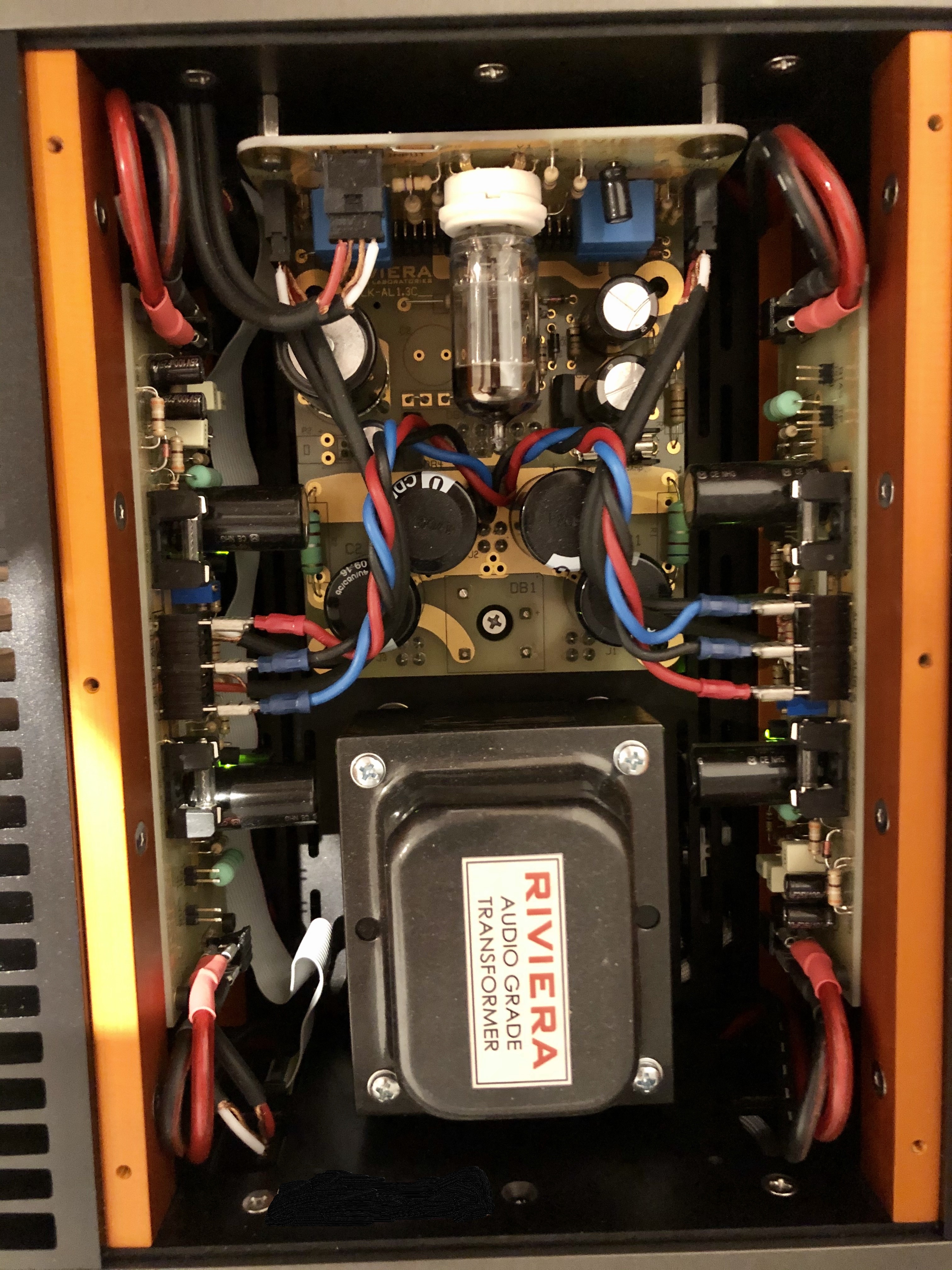

AudioGD Posted April 8, 2023 Report Posted April 8, 2023 I tried to collect some pictures of the super popular high end headphone amplifier Riviera aic10, wishing for some engineering insight and professional assessment. Quote
kevin gilmore Posted April 8, 2023 Report Posted April 8, 2023 well its much better built than the viva piece of crap. 1 Quote
spritzer Posted April 8, 2023 Report Posted April 8, 2023 I agree, I don't see anything terrible here nor anything great for the matter. I don't see why they are using 5% resistors in this day and age but nothing else really stands out. Well only that they really like their flag connectors... Quote

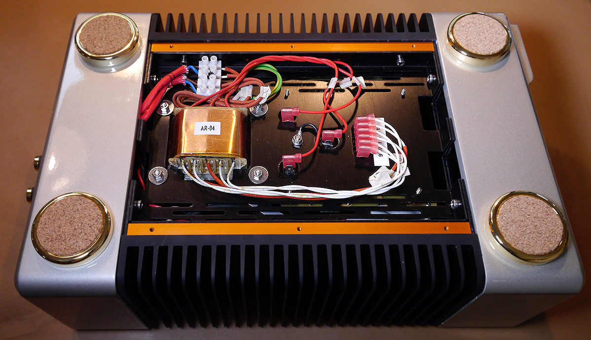

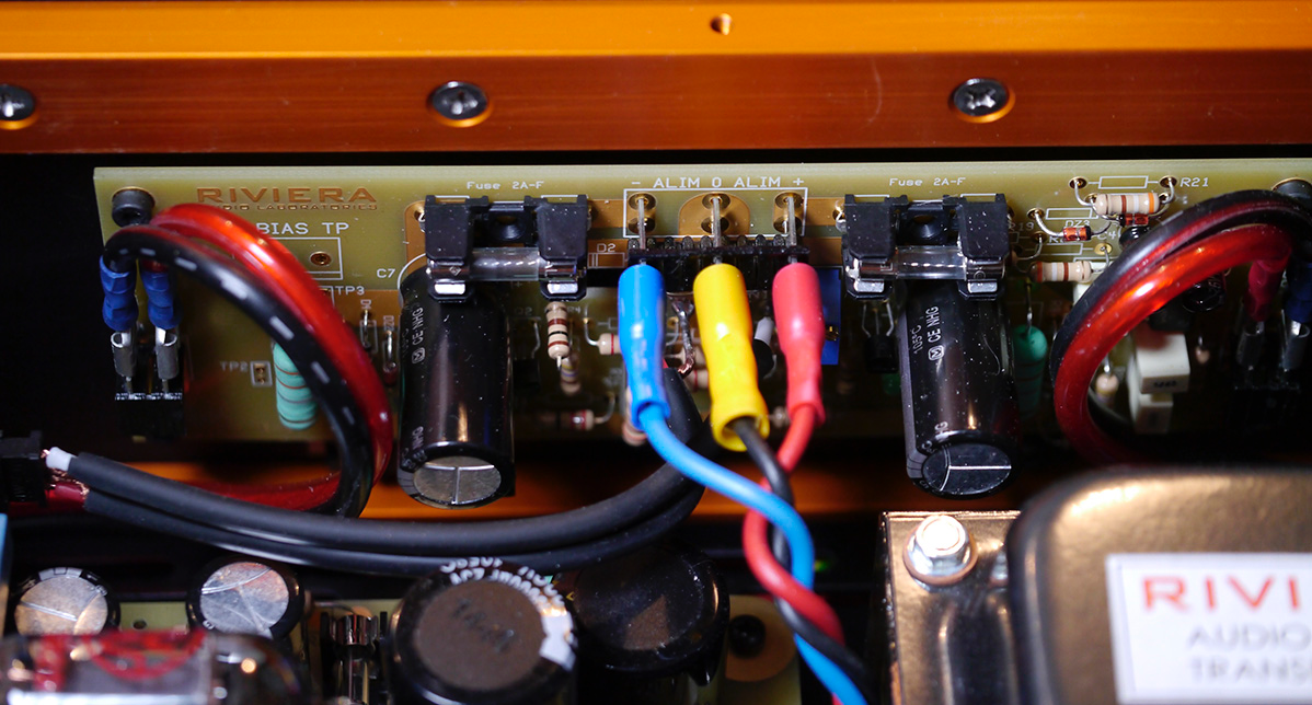

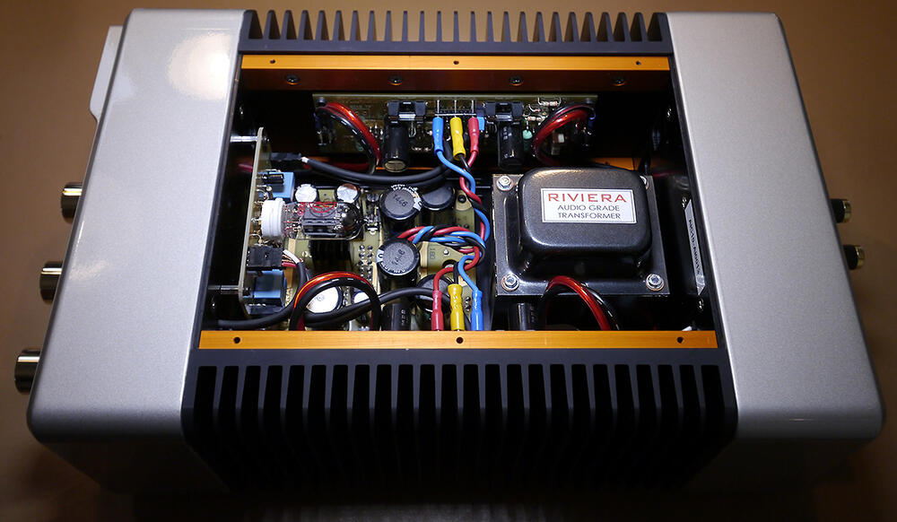

simmconn Posted Monday at 11:42 AM Report Posted Monday at 11:42 AM Picture 2: An “audio grade transformer “ didn’t care to color code the wires properly, such that the assembly tech has to attach hand-written labels to tell them apart. Maybe only the decal is custom made? Nonetheless it shows the production volume of this kit. Picture 3 and 4: It’s funny they try to use different colored quick disconnect to do dummy-proofing. Did they not know that those quick disconnects are colored differently for a reason? Pink/red for 18GA or smaller, blue for 14/16GA and yellow for 12/10GA. They used similar wire sizes regardless of the requirement of the quick disconnect, and the yellow one is apparently oversized (loose crimping). So much for a “professionally put together” kit. 1 Quote
spritzer Posted Monday at 09:35 PM Report Posted Monday at 09:35 PM The black wire on the yellow looks to be the smallest too which is always what one wants for the ground. Using different color crimps makes no sense at all... I don't even have yellow in stock here. Quote
