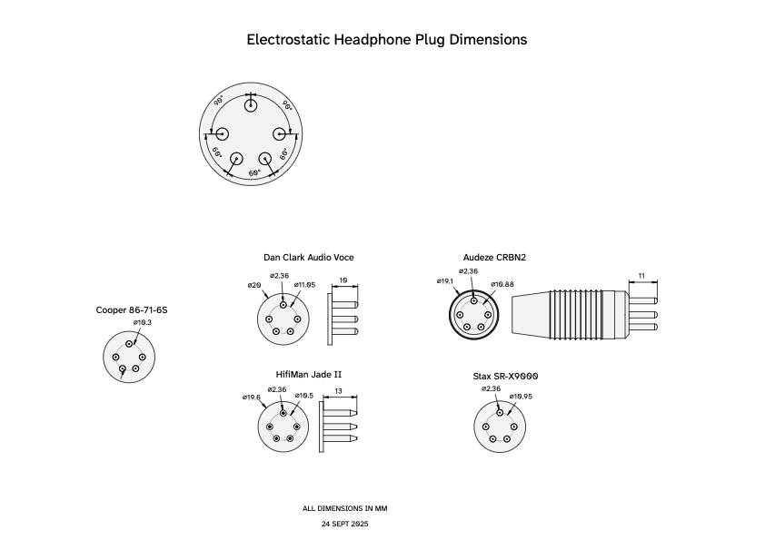

I enjoy thinking about different ways to accomplish the often-overlapping electromechanical goals of audio devices. Every few years I get to considering electrostatic headphone connectors, and every time I end up finding the same collection of vintage part numbers, shared experiences, and a few useful drawings that can be put together to probably lead to a functional socket or plug, if you want to make one yourself. I appreciate and have used that information, and now I'd like to consolidate it and create some actual specifications to help anyone trying to make a plug or socket.
The most useful thing to start with would be plug specs. Pin diameter, length, pin circle diameter, and housing outer diameter, in case you want to make a recessed socket. Here's a drawing of a plug I got from Dan Clark (I can't guarantee that it's the same as his current production plugs) and a plug from the Hifiman Jade II. If it would be useful I could make a complete model of both plugs and share the STEP files. Next week I'll be able to add the dimensions for the Audeze CRBN2. Eventually I should be able to measure some Stax plugs.

Standard pin diameter seems to be .093" or .094" (2.36-2.38mm), the same size as a 3-pin XLR contact or an octal tube socket pin, or a Size 12 circular connector contact. There is a standard housing layout for #12 contacts that matches the position of a 6-pin Stax plug, arrangement 16-6 or 17-6, but I haven't been able to find any documentation of the pin circle diameter. Neutrik also makes a crimp socket contact, HA-3FXX
The threaded socket most commonly used for electrostatic jacks and tube sockets (like this, or these) is good and conceptually simpler to design a housing for, but I would love to find a design guide or get some advice on the right way to make a hole for circular connector contacts or that Neutrik contact. They're probably not easy cavities to machine from a single piece of material, but 3D printing is useful, and I saw some mil-spec circular connectors that appeared to use stacked layers.
Standard pin circle diameter is . . . something between the .406" (10.31mm) in the Cooper catalog and the .435" (11.05mm) of Kevin Gilmore's socket drawing. The Hifiman plug was closer to the Cooper at ~10.5mm. The Dan Clark plug seemed to match up perfectly with the KG drawing. My estimate of this Viborg socket from their drawing puts it closer to 11mm.
