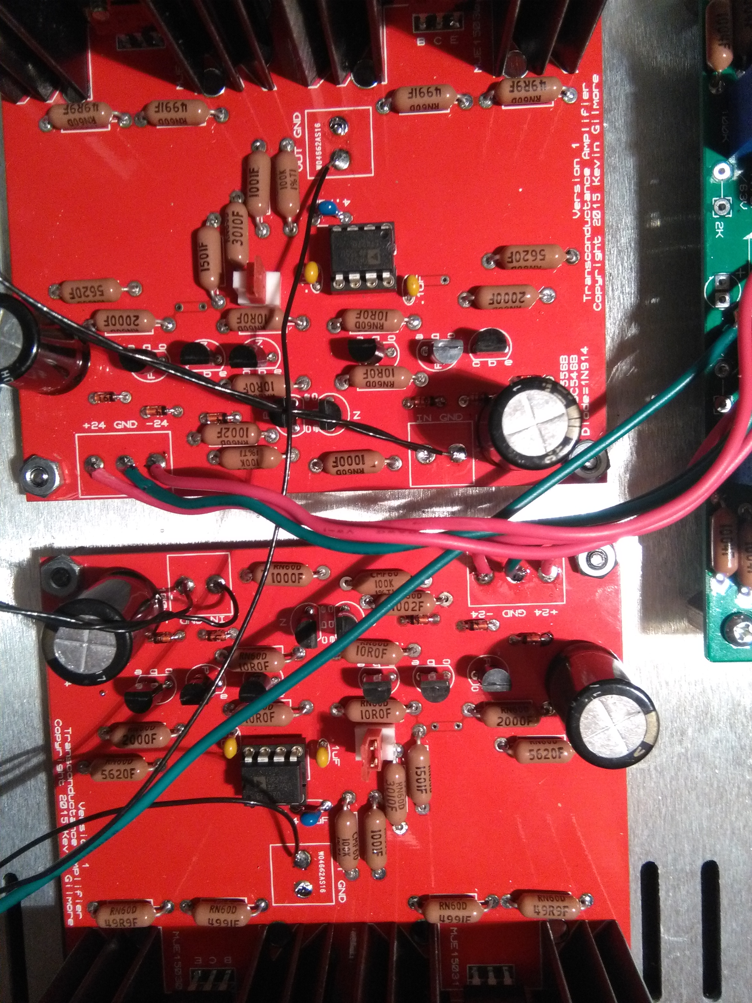

  2. Yeah, I kind of figured that. Not sure why the "good" board all of a sudden got offset issues though. I personally really hate having to fix boards with major issues so I'll probably rebuilds a new set while salvaging the parts that I could.
  3. MAJOR UPDATE! I just realised the "bad" board had the V+ and V- flipped! I wired it correctly and was shocked to find out the following: "Good" board now has almost 1V DC offset "Bad" board now has about 17V DC offset Now I'm quite confused.
  4. Inputs are not shorted, nothing connected. No load on putout while testing +9V good, -17V bad pin6 to ground on opamp Not yet measured voltage base/emitter I don't know what the .5v refers to I know it's marked and easy to populate which is why I'm surprised I messed up somewhere. Update: I replaced the 4 SMC transistors, no change.
  5. I have not found that to be the case and have a few boards in the garbage to show for it. I tested both board and one works perfectly. Unless I am really blind, a possible scenario, the transistor are correctly placed. It troubled me that redoing the soldering raised the offset a little, making me think something really did burn up before. I'm just uncertain of which to replace. I should have extras around, I think. Any suggestions of where to start? I think smc as those are still on my table. Thanks by the way.
  6. Double checked every transistor, all are correctly placed and none get warm. I don't know where to start replacing them and from experience, TO92 are a pain to remove and I've damaged boards before trying. Any suggestions on where to start or which are likeliest to fail?
  7. Update: So I just cleaned up the board and redid some solder joints, DC offset is now 2.8V... WTF?
  8. Just completed this amp running from GRLV at +/- 20v, powered it up and see 5mV DC offset on one board and 2.7v on the other Where should I be looking to try to debug it? I measured voltages across a bunch of the resistors and they certainly don't look similar between the two boards. I double checked the output transistors and they look to be installed properly. The resistors also look to be the same on both boards.
  9. Thanks my friend. I had thought so but really wanted a clear and direct answer like this. After 15 minutes of setup, I've gotten both boards to about 0v. The second was MUCH harder for some reason but it looks good now.
