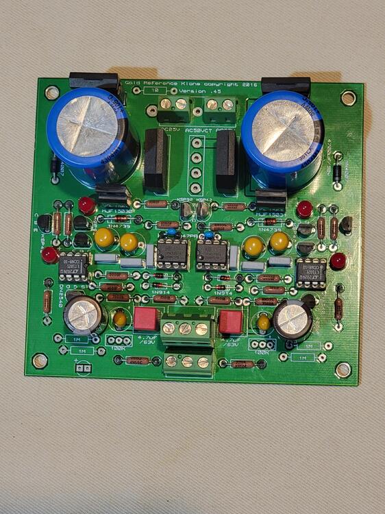

  1. I have completed the GRLV, have not tested it as yet,

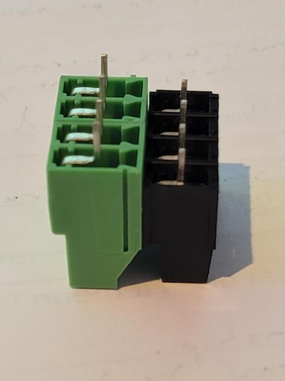

  4. If you look carefully you will see that the horizontal part of the metal connector is recessed deeper into the housing. Plus I have them in my parts bin.
  5. Anyone tried these connectors (the black one): https://www.mouser.com/ProductDetail/571-7969495
