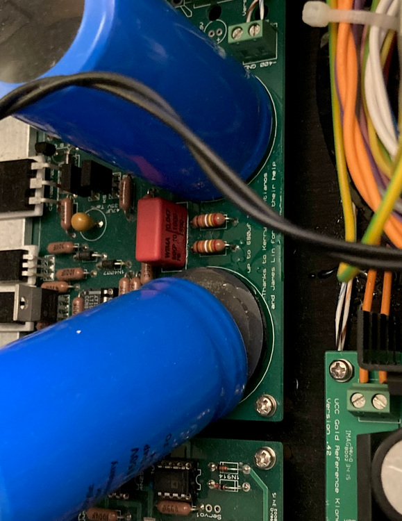

Red: soldering pad Green: Traces Blue: Suggestion for kapton tape, although depicted otherwise, I would not put it over the red pad. Just over the green trace. Yellow arrows: Metal of the terminalblock coming very close to the green trace. FYI: I used the terminal without the additional test point, but the crucial construction point is identical to the blue prints below. I think the problem was that the solder/flux ran along the bent pin of the terminal block coming very close to the green trace. I think one or two layers of kapton should work because it slightly lifts the terminal block form the board and provides addition insulation between the bend pin and the trace. If place correctly, I think its very unlikely that either solder or flux would go under the kapton tape.
Ok I agree that if you don't have flux under the terminal block, it will probably not be an issue. Nevertheless, terminal blocks take a bit more solder to fill the holes compared to other components. To conclude: I think the boards are fine to use, as long as you are very careful about the soldering of the blocks. Furthermore, the ORIENTATION of the terminal block is curcial for the problem to appear. If you mount on the reverse side, there will be no problem. If you mount on the regular side, it may also matter where the openings of the terminal blocks point to (although there are traces running on both sides of the terminal blocks). In my project, the holes were pointing to the c2ms. One could also just put some insulating material over both traces, be it kapton tape or something else that is non conductive.

Took a picture for you ;-) This is no coincidence. And I cannot clean it off. On the broken board, I plan to bridge the trace with a wire and put some kapton tape below the terminal blocks.
During the repair process of my carbon I also checked on the other channel how it looks under the terminal block. There was no short, but it looked like it would have failed as well within some time. I must therefore recommend for everyone using the v0.5 boards not to use such terminal blocks as I have, even if they are rated 400v. I they are mounted on the reverse side, it shoud be fine. But on the top side with that trace going right below the angled metal pin of the terminal block failure is programmed. FYI these are Phoenix terminal blocks from mouser and not some cheapo ebay stuff. After all I think I might be able to repair the amp board. The consequence of the -400 shorting to that trace caused a failure in both servos. The 1n914 were all shorted leading to a full short between +15 and -15. The 12V protection zener of the servo was shorted. On one board, the 4n25 measured a bit strange, so I will replace it. I don't know how to check the opamps. Will probably just replace them not to risk anything. Furthermore the GRLV both suffered severe damage. I didn't bother to check which parts were dead, so I just replaced all the active parts and they seem to work again. There were no overheated parts or so, because I switched of immediately after the failure. I guess it was a voltage spike thing. What I know is that on one of the GRLVs the 1n4007 was also shorted, which is rated 1000v 1A, so here it is probably a current issue.

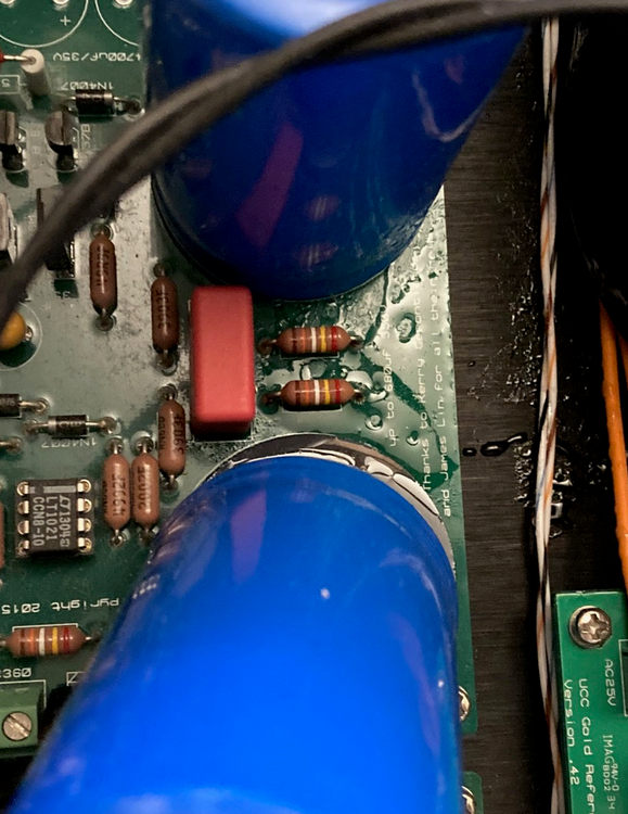

Looks like I have found the culprit today. There was some charring on the B- header of one amp board... See for yourself. To me it looked like there might have been a bit of flux from the B- pad to the trace adjacent to it. I cleaned all the board on the back side as well as possible, but how the f*** was I supposed to get that flux under the header? Do you guys always soak the boards on both sides? But even then, no brushing possible there. The good news is that the transformer is alright. Unloaded voltages are fine. The bad news is that the amp board is trash (I got two spare boards luckily). Unfortunately the two GRLV boards don't work properly anymore. I guess I will have to replace the amp board and replace all the active parts on the GRLV. I still have to check the other amp board. Hopefully there was no damage to it. The GRHV seem to work properly (without load). FYI the amp was used approx. 50h before this happend and ran about 15min on the day it happened. What should I do to prevent this from happening with a new board and the other board?
