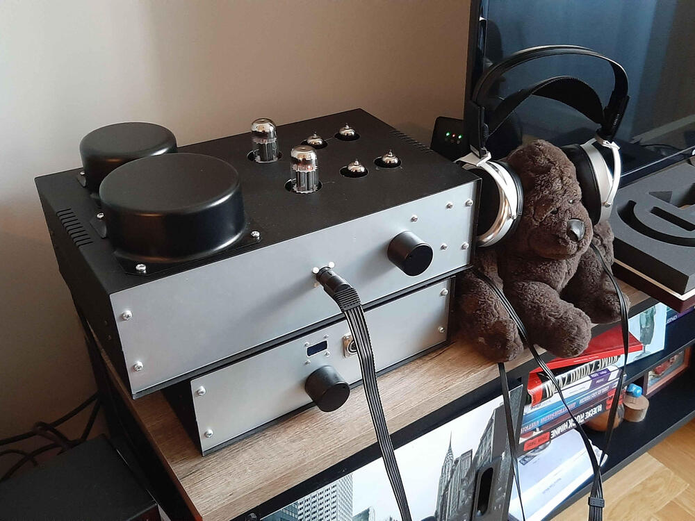

  10. not the prettiest build, but i'm learning. goal was to make it work, and worry about the looks later. metal works was something new for me, you need to have good tools. these are my first two amps i have ever built. lower one is SS dynalo. edit: looks like i can upload maximum one picture(500 kb).
