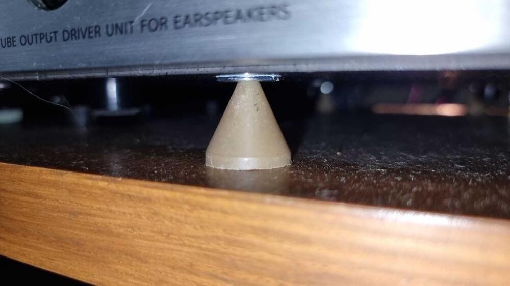

no, cones/tips can make a positive or negative contribution even with all-solid-state electronics, it is something I have encountered on several occasions... for example in a dual linear power supply I built the use of rubber cones, instead of the feet supplied with the cabinet, led to significant sonic improvements (I know, it sounds crazy. .. but unfortunately it really is)... in general I have found that if in the electronics (same cabinet) the transformer is itegrated as well then mechanically coupling with the board (cones, spikes, etc.) can lead to benefits... if there is no transformer then it may be advantageous to decouple (rubber feet, etc.) or leave unchanged it is not at all true that 6SN7s are microphonic tubes, if anything the opposite...a friend of mine, a hi-fi manufacturer was telling me that some tubes, small, of his use tend to be microphonic and, because of this,force him to make long selections...for this reason he is now switching on new designs to 6SN7s which give no such problems. I also use 6SN7s in an OTL amplifier and there are no problems, mostly NOS tubes...some even from 1952 (unfortunately not GTB, too bad because fabulous)...I would avoid Russian Tung-sols, I have not heard good things about them (mine are American NOS ones), I would go to Sylvania GTBs which are readily available at a very reasonable cost the computer power cord leave it to the computer, it is only good for that...use a shielded cable that is also good for the electronics around there reducing electrical pollution, don't listen to those who say nothing changes, the world is full of uncurious and very rigid people... if you want to play try making this cable here --> https://www.tnt-audio.com/clinica/ttse.html i use L300 Limited (pad from L700)- 107 replies

Hi plaurids, thks for super-detailed reply ok.. probably now I got it... this R20 value change make sense togheter with CCS mod, without not (confirmed?)... I thought was useful to have better control/stability when setting balance/offset (in any case if the resistor is on the bottom side the add another in parallel is very simple soldering it in place) differences between 6SN7GTB (Tung-sol at the moment, those quite tall) and 6CG7? Well, at the begining I used RCA Clear Top and GE, both 6CG7... RCA are considered super-top but I found them too cold, GE are better but... then I tried Sylvania GTB, better but I have always found Sylvania good but nothing special... then the Tung-sol, those always gave me the feeling to be too much clear, with not enough body in low end... and this time was the same until... until I placed below the energizer three ceramic cone (those used in industry to clean metals), one in the front and two in the back, and that changed the sound quite noticeably, for the better of course (that transformer screwed onto the pcb will make sense from an industriele and cost point of view...but it's not a good job, imho) I also changed the fuse holder by putting a tinned copper one size 5x20 and fitted a Gustard fuse... another positive change in sound (note that I was quite skeptical about the fuses)(require burn-in and has a dircetion of flow... yes I know, I didn't believe it either) the power cable made with Supra Low-rad 2m long, I didn't notice any changes from another industrial shielded cable I was using previously, I'm just more comfortable about the noise shielding (the DIY cable with triple choice for shield connection) any experience with 6CG7 from Mazda or Matsushita?- 107 replies
