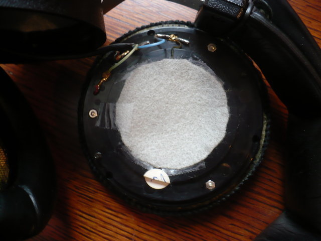

spritzer Posted February 7, 2014 Report Posted February 7, 2014 The aim of the thread is to consolidate all the info that is out there of old and frankly strange electrostatic headphones we come across. I really should have started one of these back in 2005 when I started my collecting but hindsight and all that... So I'll start off with one so rare that there is pretty much no info out there for this set. Here is what it looked like when I got it: These were made by Audiotec in France and aside from some brochures back in the say we know nothing about them. There isn't even a model number on them or a left-right identifier. They are quite big, roughtly the same size as the SR-Omega and the back of the fork is pretty much a clone of the SR-1,2 and 3 setup Stax used. Here are the earcups opened and these do have the honor of having a truly unique earcup design. No screws as they use nails which are friction fitted. Very secure assembly but an utter pain in the ass to disassemble... Not sure what is up with that baffle. It made of the same material as really old PCB's but those traces don't go anywhere. Driver lifter out of its cradle and doesn't this look familiar. Turns out that it's the same or very similar driver to the ones used in the Stax electret models. Never seen one with the mineral wool damping pad being a part of the driver housing though. Same pic but showing a bit more of the green wool pad used on the back of the driver. This keeps the driver in place against the baffle similar to the Magnavox sets but it's a far from ideal setup. There is also very little to keep the back wave from colliding with the front and that foam around the driver is decomposing quickly. Showing the connections inside the cups. The joints simply have fiberglass insulation pushed over them but not secured in any way. Yet another thing that needs to be fixed... Here is the original 6 pin DIN connector. Oxidized all to hell so I simply removed it. Now the important bit, how do they sound. Well I don't have the original adapters so I had to make due with what I have at hand... I knew that the stock transformers used with the Audiotec stuff had very high stepup ratio (1:65) so it was no surprise that the highly modified SRM-007tII didn't manage to drive these even at full volume. I do have a few KGSSHV's here and they did a stellar job with a very balance sound signature. The bass is a bit odd given the housing and all the colorations it adds but not bad at all. Finally here is how they look now but I'll do some further mods to them. They really need a new cable and some baffle insulation... Last but certainly not least, great thanks to Luc for giving me this set to play with. 2
mypasswordis Posted February 7, 2014 Report Posted February 7, 2014 (edited) First thing I thought when I saw the driver was it looks like a Stax electret, so is it an electret or full electrostatic? Looks very cool. Too bad I'm done with collecting vintage 'stats after I find a Gamma Pro and ESP9. Here are the pics of the Superexen I already sent to you: PEP-81 https://www.dropbox.com/s/4kso86ao196v3yr/IMG_20140113_221339.jpg https://www.dropbox.com/s/urt7iycl6orzegq/IMG_20140117_224116.jpg EP-5 https://www.dropbox.com/s/zib1xq32ynjv41x/IMG_20140113_221434.jpg https://www.dropbox.com/s/0dz5ebtns5p6rb4/IMG_20140117_222908.jpg https://www.dropbox.com/s/ujis7j066vt0bre/IMG_20140117_223110.jpg Edited February 7, 2014 by mypasswordis
spritzer Posted February 7, 2014 Author Report Posted February 7, 2014 They are electrets but Audiotec also made full blown electrostatics as I've seen the schematic for the energizer. Bias is -300VDC...

poussi_pousse Posted May 27, 2014 Report Posted May 27, 2014 Hello to all, I would like to add some info about this headphone : - it's a CES (Casque ElectroStatique) from Audiotec (France). - the version presented is the electret version (from Audio-Technica, ATH-5 -> ATH-8 ) - the left-right identifier is the grey plastic on the cable - there is no serial number because the driver aren't from Audiotec - the old PCB is one of the two electrode from the original electrostatic headphone, if you see my photo you'll understand - this headphone wasn't suppose to have an electret driver originally - the six pins plug is silver plated so no bad oxidation. - the 300V bias is for the electrostatic version only. Here's the photo of the original (1972) version (full electrostatic) : Poussi_Pousse

spritzer Posted May 28, 2014 Author Report Posted May 28, 2014 Hello to all, I would like to add some info about this headphone : - it's a CES (Casque ElectroStatique) from Audiotec (France). - the version presented is the electret version (from Audio-Technica, ATH-5 -> ATH-8 ) - the left-right identifier is the grey plastic on the cable - there is no serial number because the driver aren't from Audiotec - the old PCB is one of the two electrode from the original electrostatic headphone, if you see my photo you'll understand - this headphone wasn't suppose to have an electret driver originally - the six pins plug is silver plated so no bad oxidation. - the 300V bias is for the electrostatic version only. Here's the photo of the original (1972) version (full electrostatic) : Poussi_Pousse Thanks for that info, much appreciated. It's nice to know that the odd baffle plate was actually supposed to be a stator. Always seemed that way to me but no way to confirm. Not sure why these drivers are in there but it looks like they came from the factory like this. There are only four wires in the cable so either it had to changed or they were always like this.

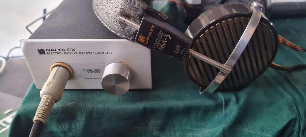

Bingturong Posted March 16, 2023 Report Posted March 16, 2023 Sorry for reviving the thread but don't know anywhere else in the site I can post this, got something curious. A Napolex NSA-3 2

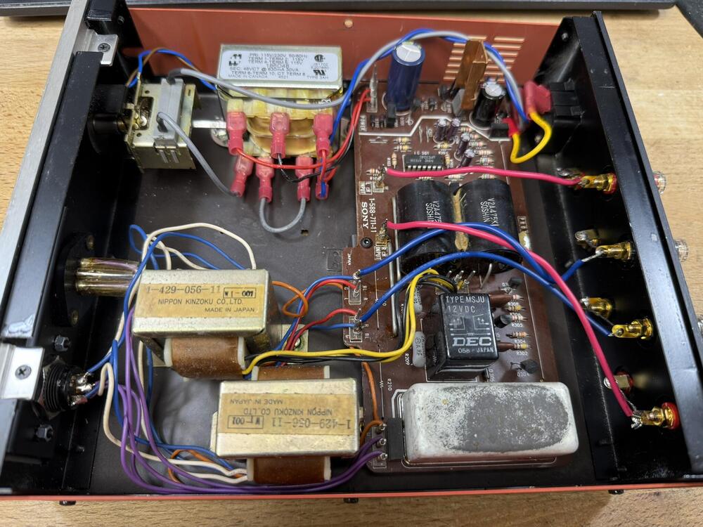

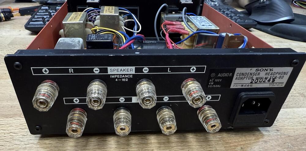

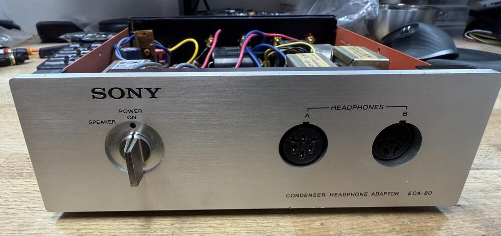

spritzer Posted July 29, 2025 Author Report Posted July 29, 2025 I wasn't sure where to put this either but this should be rare enough, the Sony ECR-800 energizer or the ECA-80 to be precise. Now there is a bit of a backstory to this one, I've never found a ECR-800 but I found this one for a song in China so I had to snap it up. It was in a bad way when it arrived, damage all over and the back sockets all a bit crooked but the worst was inside. See, Sony in their infinite wisdom, used a mercury switch for the input switching and that had broken in shipping. There was mercury all over the inside so I had to clean everything and dispose of it properly. It's a shame as its a very early unit with the custom Sony sockets, they later moved onto using Stax 6 pin sockets with these. I let it sit for probably a year before I decided what to do with it as so a full rebuild was in order. These are 100V only so for my use I need a new transformer, I fitted an IEC on the back, new binding posts with the switch function bypassed and all caps replaced. I also fitted a 6 pin Stax socket to the front as I don't have an ECR-800 and if I ever find one, odds are it will have that plug. Plus this works nicely with Stax normal bias sets. For the circuitry as it is a bit odd for 1978 or so. Most of the what's there is a protection circuit and output relay but the gray brick on the bottom is the bias supply, a DC/DC converter. It has clearly seen some use as there should be paint on there but it seems to work fine and there is clearly a ballast resistor in there too. It's also odd that the transformers have two sets of wires so each socket is fed from its own set of wires. See the 4 purple bias wires too, they are all common on the bias supply. 9
