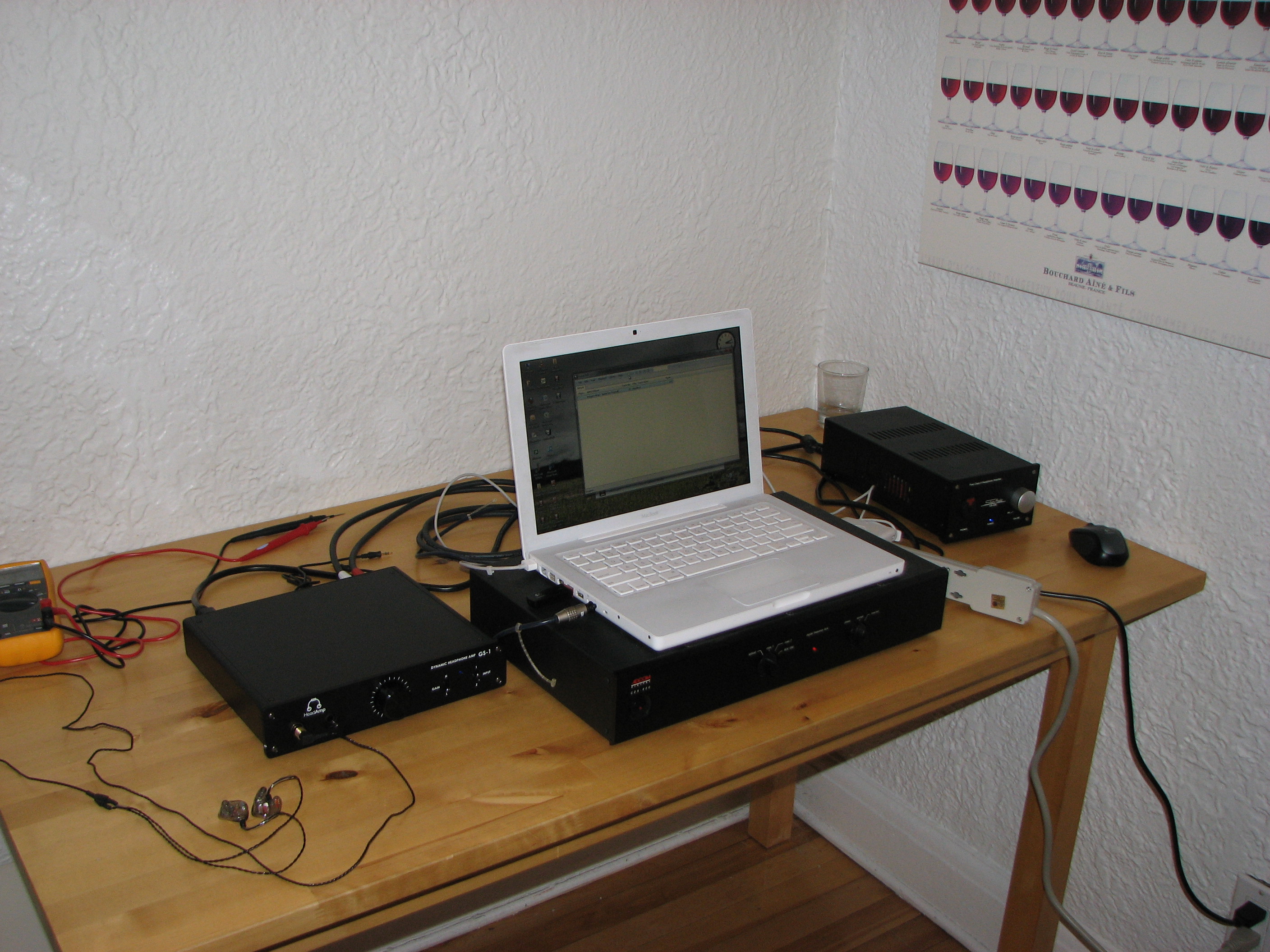

GPH Posted May 4, 2010 Report Posted May 4, 2010 (edited) This morning, I received the GS-1 that I bought from veloaudio and since it's a rainy/cloudy day and I had nothing very important to do this afternoon, I decided to do something that I rarely do (because frankly it's a pain in the ass), an amp comparison. I thought it was an interesting comparison to make because the two amps are different implementations of the classic Dynalo design by Kevin Gilmore, but at very different price points. On one side, HeadAmp 899$ GS-1 that's been a respected amp for a few years and on the other side, the Chinese-made HA-006+ that's a newcomer to the market at a very attractive price of 280$. Features The HA-006+ has an headphone out, one set of inputs and one set of preamp outs, the GS-1 has the same and adds an extra set of inputs, an extra headphone out, a loop out and a a gain switch. The HA-006+ has a gain of 11 and on the GS-1 you have the choice between 3 and 9. Technically, I'm not sure what are the differences between the two amps, someone more knowledgeable in electronics would have to answer this. Aesthetically, the GS-1 smokes the HA-006+. The Sheer Audio amp looks like a DIY build while the GS-1 looks professional. Surprisingly, the HA-006+ weights quite a bit more than the GS-1. Sound I used my Adcom GDA-600 source to make the comparison. The volume levels were matched with a 0.3mV difference according to my multimeter. I had to swap the RCA cables when I switched amps, which is a less than ideal method, but I didn't have another pair of interconnects unfortunately. I used the JH13 for the test with a few tracks that I know very well, mostly progressive rock and classical. First thing, the GS-1 is quite a bit more silent than the HA-006+. With the JH13, the background is almost pitch black, while the HA-006 has some low-level noise when there's no music playing. I plugged my KSC-35 for fun and you can't hear noise on any of these amps, but the JH13 are quite sensitive. With that said, it doesn't matter at all when there's music playing, but I like my amps quiet. Also, I thought earlier that the HA-006+ produced some kind of very low hum, but finally it had nothing to do with the amp, it was a ground loop due to who-knows-what in the way my setup was arranged. I did a lot of back and forth listening of short sequences between the two amps and I have to say they are pretty close. I've never been very good at describing sound, but I'd say the GS-1 has a sound that's just a little more focused than the HA-006+. Same basic sound signature, but it does everything with a bit more confidence and precision. On the other hand, the GS-1 strikes me as a little more polite than the HA-006+, which sounded a tad more open and fun, sacrificing some smoothness at the same time. The two amps are very fine performers with the JH13 and it's nowhere near a black and white comparison, they are small variations on an excellent theme. In conclusion, I think you can't go wrong with any of these amps. There's an important price difference between the two, but you have to consider the extra features in the GS-1 and the fact that it's built in the USA. The higher noise floor of the HA-006+ probably doesn't matter with regular full-size cans, but for sensitive IEMs, it can be a small annoyance. Hope this comparison will be able to help future buyers because it was damn long to write! [ATTACH=CONFIG]3078[/ATTACH] Edited May 4, 2010 by GPH
