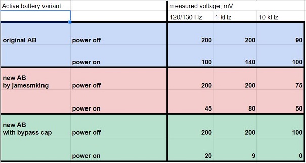

  6. A short table with results: It seems that active battery without the capacitor increases amplitude of signal at the base of Q26 with frequency, especially the original battery. Has it been done intentionally? I just can't see a reason. This imperfection of AB probably decreases stability at HF and slightly lowers bass. Measurements have been made with Tektronix THS720 and P5102 voltage probe. I can't wait to measure these batteries in the amp itself
  7. The new battery with added capacitor: 1. 120 Hz, power off http://ixbt.photo/photo/406668/17916TMfujOMyVu/Hgj7GE8yHX/1514671.jpg Amplitude is about 200 mV 2. 120 Hz, power on http://ixbt.photo/photo/406668/17916TMfujOMyVu/Hgj7GE8yHX/1514672.jpg Amplitude is about 20 mV (!) __________________________________________________________________________________________ 3. 1000 Hz, power off http://ixbt.photo/photo/406668/17916TMfujOMyVu/Hgj7GE8yHX/1514667.jpg Amplitude is about 200 mV 4. 1000 Hz, power on http://ixbt.photo/photo/406668/17916TMfujOMyVu/Hgj7GE8yHX/1514668.jpg Amplitude is about 10 mV or less (!!) __________________________________________________________________________________________ 5. 10 kHz, power off http://ixbt.photo/photo/406668/17916TMfujOMyVu/Hgj7GE8yHX/1514673.jpg Amplitude is about 100 mV 6. 10kHz, power on http://ixbt.photo/photo/406668/17916TMfujOMyVu/Hgj7GE8yHX/1514674.jpg Amplitude is about zero (!!) __________________________________________________________________________________________ Adding the bypass capacitor makes the active battery much closer to an ideal "voltage drop" element. I think that increasing the capacitance to 4000 or 5000 pf will decrease the measured voltage even in the case of low frequencies like 100hz.

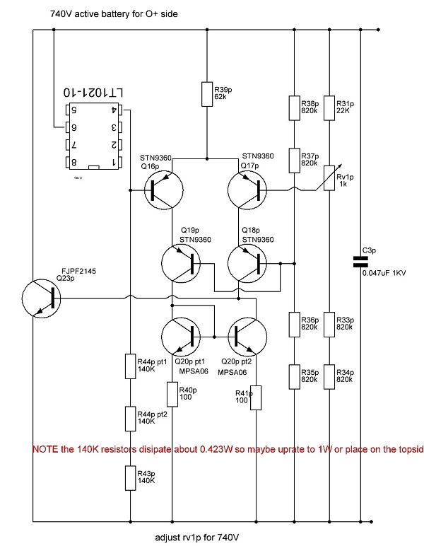

  8. The second version of AB was taken from this post. We changed R43-R44: 140k -> 150k, MPSA06 -> HN4C51J and FJPF2145 -> 2SC3675 selected with the best hfe. Why ? 1. We decided to slightly lower supply of LT1021 - it is still enough for normal work of this voltage source. 2. HN4C51J has better hfe and also I prefer to use double transistor in one case in current mirrors. 3. 2SC3675 has lower input capacitance and better hfe. STN9360 has much higher current gain and lower capacitance in comparison with 2SA1486/2SA1413 and we thought that performance of this battery should be much better. And so it turned out: 1. 120 Hz, power off https://ixbt.photo/photo/406668/17916TMfujOMyVu/Hgj7GE8yHX/1514659.jpg Amplitude is about 200 mV 2. 120 Hz, power on https://ixbt.photo/photo/406668/17916TMfujOMyVu/Hgj7GE8yHX/1514660.jpg Amplitude is about 45 mV __________________________________________________________________________________________ 3. 1000 Hz, power off https://ixbt.photo/photo/406668/17916TMfujOMyVu/Hgj7GE8yHX/1514661.jpg Amplitude is about 200mV 4. 1000 Hz, power on https://ixbt.photo/photo/406668/17916TMfujOMyVu/Hgj7GE8yHX/1514662.jpg Amplitude is about 80 mV __________________________________________________________________________________________ 5. 10kHz, power off https://ixbt.photo/photo/406668/17916TMfujOMyVu/Hgj7GE8yHX/1514663.jpg Amplitude is about 75 mV 6. 10kHz, power on https://ixbt.photo/photo/406668/17916TMfujOMyVu/Hgj7GE8yHX/1514664.jpg Amplitude is about 50 mV __________________________________________________________________________________________ The new battery performs much better! But it is still is far from ideal. Why ? At the next day Dmitry noted that capacitance of STN9360/2SA1486(Q17p/Q17) and really high resistance of the voltage divider (R33-R34) make a low-pass filter. Could it be the cause of problem ? He added one 2200 pf teflon capacitor between the low end on R34p and the base of Q17p transistor. Results of the measurements are in the post below

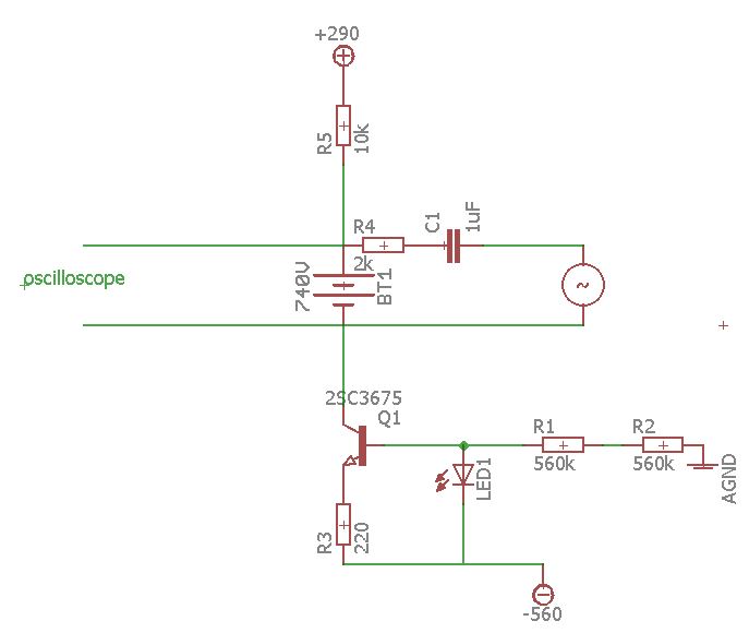

  9. Still waiting for last parts.... 🥱 And waiting for them to be delivered, I and my friend Dmitry decided to tests a performance of the active battery at hight frequencies. The scheme of the stand has been given by @Kerry. Thanks! We just slightly modified it. Safety note: we supplied the battery by a source completely decoupled from the mains. That is why our generator is alive. Be careful. All the batteries are set to 740V. The first battery is the original one with 2SA1486 -> 2SA1413 and 2SK246 -> 2SK208 and 2SC3381 -> HN4C51J. The first two pairs are the same transistors in different cases. Results of the measurements: 1. 130 Hz. Power off. https://ixbt.photo/photo/406668/17916TMfujOMyVu/Hgj7GE8yHX/1514651.jpg Amplitude is about 200 mV 2. 130 Hz. Power on. https://ixbt.photo/photo/406668/17916TMfujOMyVu/Hgj7GE8yHX/1514652.jpg Amplitude is about 100 mV 3. 1000 hz. Power off. https://ixbt.photo/photo/406668/17916TMfujOMyVu/Hgj7GE8yHX/1514653.jpg Amplitude is about 200 mV 4. 1000 hz. Power on. https://ixbt.photo/photo/406668/17916TMfujOMyVu/Hgj7GE8yHX/1514654.jpg Amplitude is about 140 mV 5. 10 kHz. Power off. https://ixbt.photo/photo/406668/17916TMfujOMyVu/Hgj7GE8yHX/1514655.jpg Amplitude is about 90 mV 6. 10 kHz. Power on. https://ixbt.photo/photo/406668/17916TMfujOMyVu/Hgj7GE8yHX/1514656.jpg Amplitude is about 100 mV 😨 The questions: Shouldn't there always be zero volts AC ? Shouldn't the battery always stay at 740V after powering on? It looks like the active battery in the T2 scheme suppresses low-frequency signal. It is a problem ? We decided to test another version of the active battery.

  17. I've made a simple stand, thanks to Kerry, and all ABs have passed all tests, dropping now silently 740 volts as it shoud be 🙂
