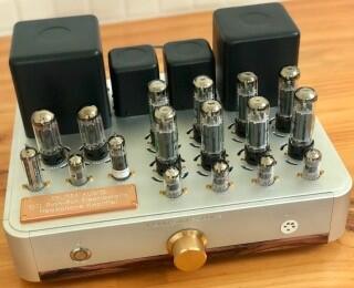

  7. Megafixed by Kevin Gilmore! I love it! There has to be some way to flip that plaque over and re-etch
  8. @gepardcv Yes, its the same Thuan, under 10 different characters and names, as quoted above; he made the mistake of replying to me under several different accounts over the past 2 years. I didn't fully put the pieces together until I read the complete DIY T2 build thread, in anticipation of receiving GeorgeP's build to replace his horrific amp. Thanks to Kevin fully gutting the Thuan fls.audio nightmare, it looks like I'll have two amps!

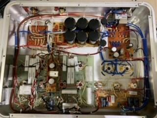

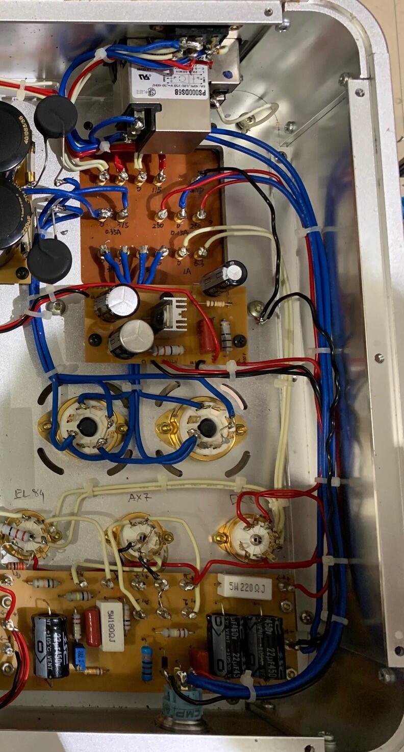

  15. I’ve received several helpful replies You are very welcome to have a look without cost or obligation, and bin it, if that’s all it’s really good for. I don’t have high hopes for it, and George’s T2 is already near completion. It would be good to shed light on what this builder is actually doing. I get 80% off on UPS domestically, and it should be at your door next-day, within province. UPDATE: A very reputable member, local to me, has kindly agreed to take a look, and shed some light on this build... Thank you, all!

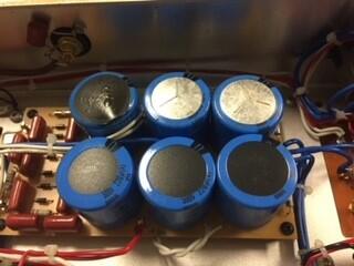

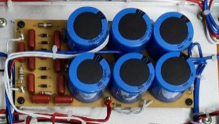

  16. I agree: there are multiple implementation issues. The power supply schematic likely existed on a napkin at one point, but Thuan doesn't have it. In two years, I've never seen a copy, in spite of repeated requests. Upsizing the caps to 550V 220uf slowed the issue down, but didn't eliminate it. In two years, when the amp worked, it was excellent, which was usually for bouts of moderate length, until the mains transformer finally gave out. However, any excellence could likely be attributed to the vintage tubes stuck in the amp by myself. This Thuan fellow's immediate and selfish PM response today, after two years of providing no support for an amp he asked 5.5K USD plus shipping for, has raised my ire. Curious and telling, too, is the nearly simultaneous appearance of an apparent shill, as above. I actually have no hard feelings, overall - this community has been fantastic to me, I've rolled more vintage tubes than I ever thought possible, and I've been the recipient of a great deal of kindness and outright generosity from tube collectors, fellow enthusiasts, and so on. Everything from NOS pinched waist Philips E180CC's, to several quads of iconic gold pin USA 7308's and Holland 6922 from the early 60's, were practically gifted to me by a kind-hearted Canadian collector for my T2 build; this community has been stellar. A fellow with two Shangri-La SR's sent me one pair from Korea for roughly half the Canadian cost of a new pair. GeorgeP is a kind-hearted and generous builder, as you well know. It's too bad that I wasn't aware of George and these threads a couple of years ago. I'm sending a hi-res picture of the innards to Birgir, who has also been very helpful over the years. If he or anyone else wants, I am happy to get Thuan's unique "Megatron" masterpiece to them. Thanks for being so kind as to reply. Thanks for all of your help and suggestions.

  18. You know, not many things upset me too much, which is why I suppose I've put up with this amp for 2 years; however, the IMMEDIATE and IDENTICAL reply I received from Thuan BOTH here on head-case (thuytn) AND on head-fi (tranhieu) to the above post does get under my skin: I've just seen your post on HC. Could you please remove my name from that post? It could heavily affect my future sales. Hopefully you could understand my situation. Cheers Thuan Wow, this fellow has guts. Hence, I will provide some helpful, clarifying details: 1. Thuan's amp was dead the week it arrived. It had eaten through it's first set of 6 under-sized 220uf 450V Nichicon power filtering caps, and blown the soldered fuses between the GZ34 rectifiers and the caps. The inrush current was virtually uncontrolled on startup. 2. Thuan provided ZERO support, and was completely unresponsive. 3. Thuan was using a different account for amp/T2 board and transistor sales on head-fi (kytuphicanh), which was scrubbed by head-fi moderators, who added the warning: Caution: Incomplete Sales Why? Good question. The next fortunate head-fi member to buy one of Thuan's Stax Megatrons was paramesh; Paramesh contacted me directly regarding my Megatron build, and we basically had the same experience: amp dead within a week, zero support or accountability. I have all the PM's. Hence, the head-fi moderators deleted Thuan's account, kytuphicanh. No worries, Thuan has several other accounts, (including thuytn, tranhieu, fls.audio on SBAF and tee8tee4388 on reddit, among many others, no doubt) 4. Thuan's Megatron contains no delayed-start or soft-start circuit of any kind, not even a thermistor for crying out loud. The power filtering caps blew repeatedly. 5. For additional clarity, please see pictures attached of Thuan's caps upon arrival, and within a WEEK of use. Notice any tops blown right off? This happened 4-5 times before a thermistor was installed, and then the power transformer died... 6. The main power transformer was described as (pictures of his winding rig are on SBAF): "Custom-wound Kawasaki 0.23mm Z9 core transformers". In reality, the mains power transformer is under-sized and is now dead. 7. Anyone on head-case who would like to further evaluate the quality of this fls.audio Felitsa Audio amp build is welcome to receive it at my expense via UPS Express, worldwide. It is a large, single-chassis build, and it is quite dead, yet again. Cheers, indeed!
  19. Hi All! I have had the fortune of having owned one of Tran's (Thuan, Thuy etc...) Megatron builds, shipped from Vietnam, for the past two years... I bought it from the same Head-fi account that was selling T2 boards and kits since 2005: kytuphicanh (now using tranhieu on head-fi and fls.audio on ebay). It was a fairly temperamental build at the outset, eating through the power supply filtering caps... until I eventually upgraded them to Kemet ALC10 550V (from Nichicon 450V) and added a couple of MS-22 thermistors to slow the startup. However, the amp recently began eating the 5A inlet fuse, and I suspect that either the primary or secondary filament transformer has given up the ghost. Would someone in North America be interested in taking a look, without obligation? If you can't fix it, you can simply bin it. It seems like a waste to bin it without at least giving it a second chance. It was a fine sounding amplifier when it was working. I would be happy to UPS the amp to you. I have some very nice tubes you may be interested in for your trouble, I'm under the same handle on Canuck Audio Mart. I have a DIY T2 coming from GeorgeP, so I'm not in a terrible rush or anything like that. Thank you!
