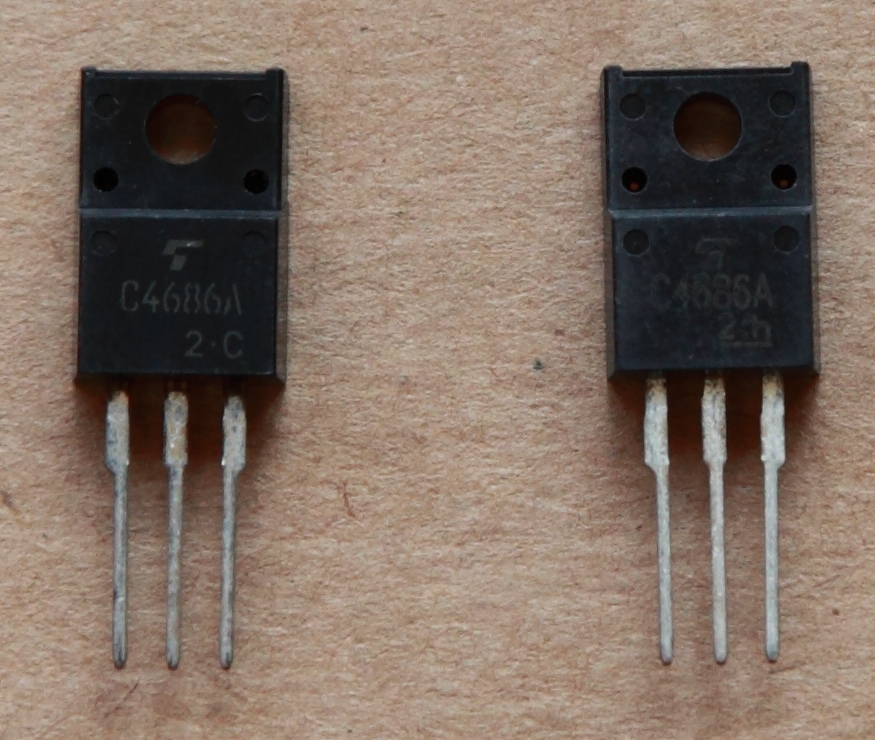

So I received two packages today and one of them is the 2SC4686A I bought on eBay from UTSOURCE. In the photo below are two 2SC4686A, one I bought from BDENT (on the right) and one from UTSOURCE (on the left). Can anyone spot any difference or discrepancies other than the batch code? All I have is a Fluke 112 multimeter. Is there some way I can test the two to see if the eBay ones are legit? Thanks!
