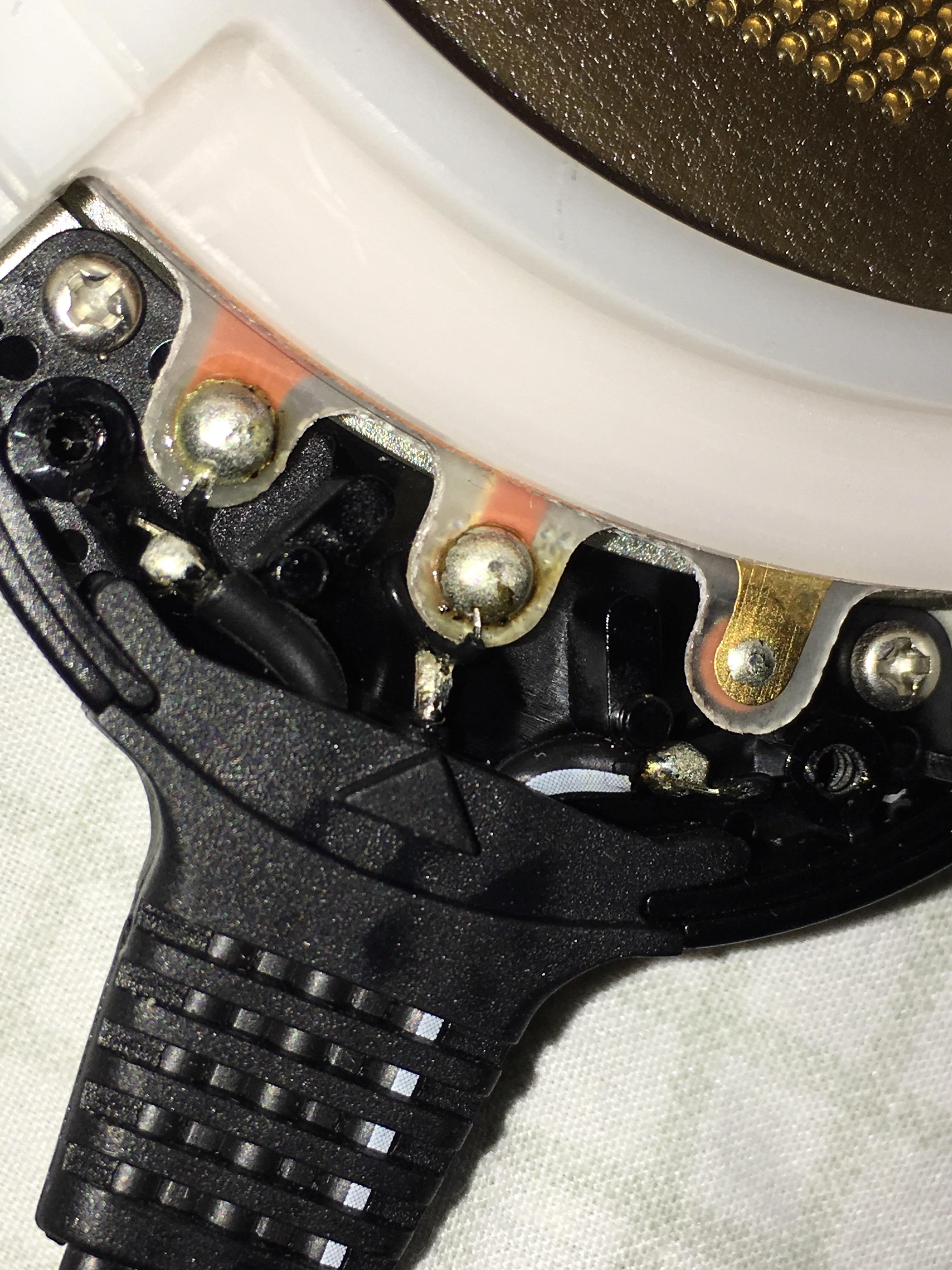

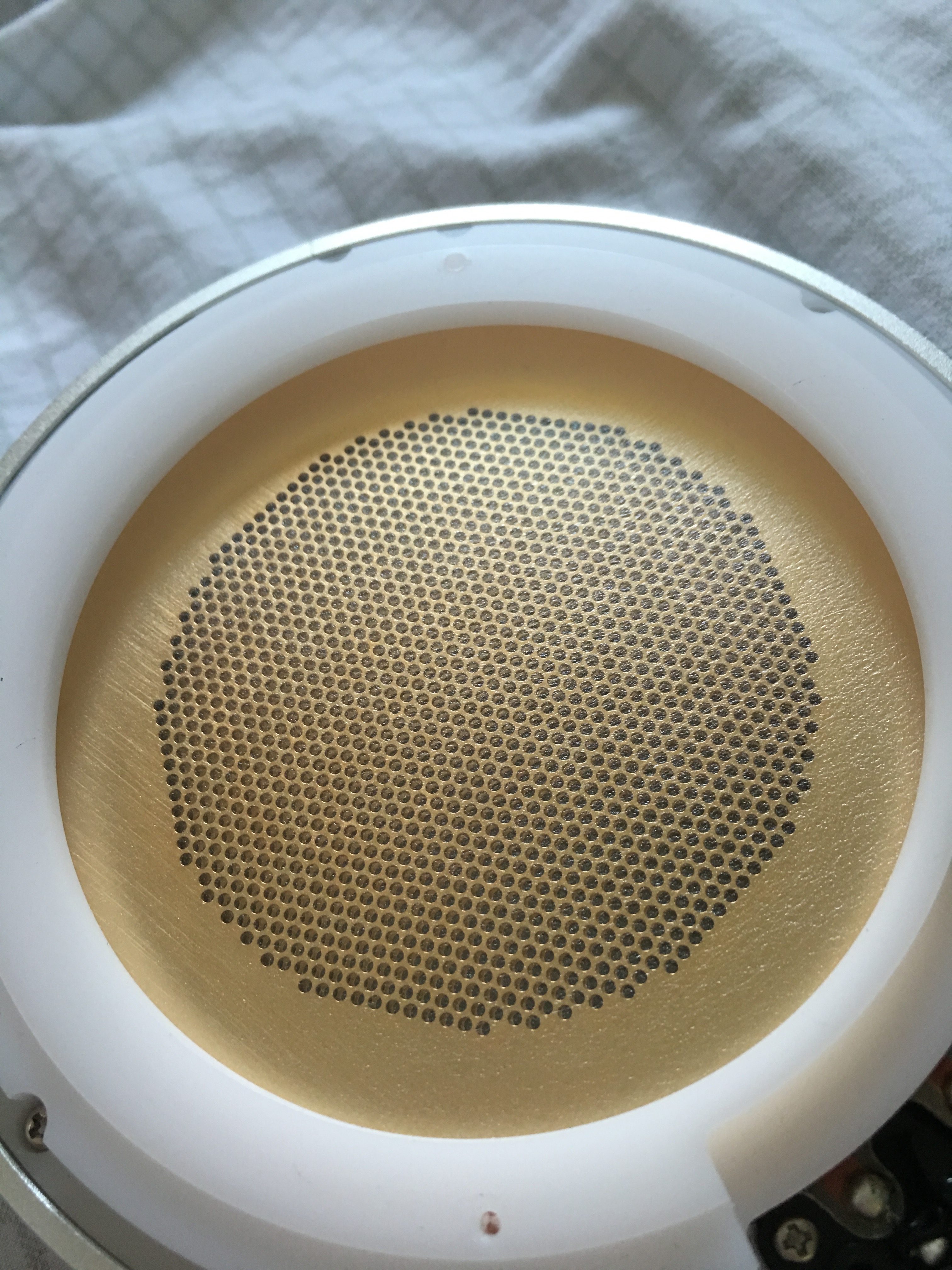

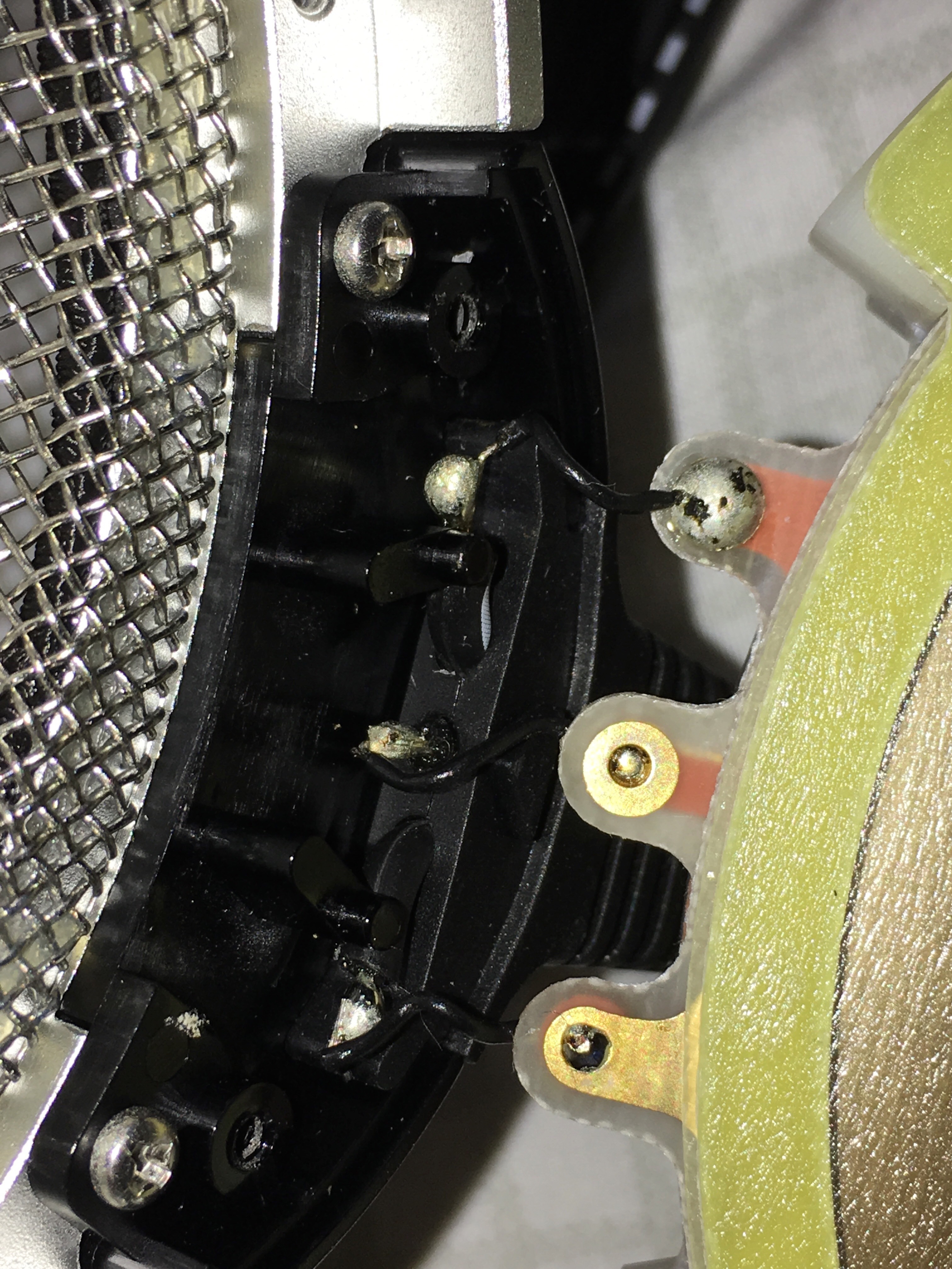

opened up the left earcup, looked fine, put everything back together and imbalance still there. some pics: i'm assuming if the connections were bad no sound would be coming out, right?
