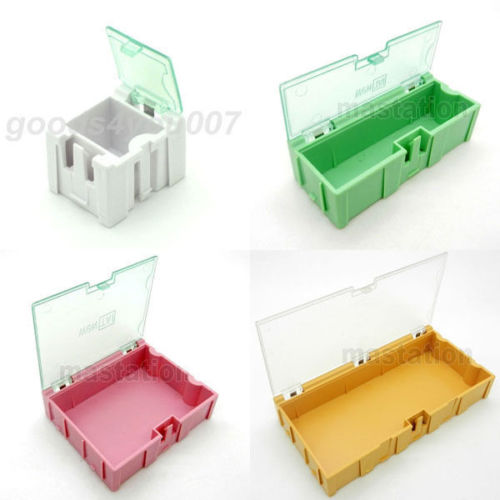

gwrskien Posted February 26, 2017 Report Share Posted February 26, 2017 I use these..from ebay. Search with this frase: Laboratory Storage Electronic SMT SMD Box SMT Anti-Static Start at 50pc for $16 incl free shipping. 2 Quote Link to comment Share on other sites More sharing options...
