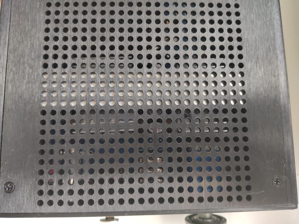

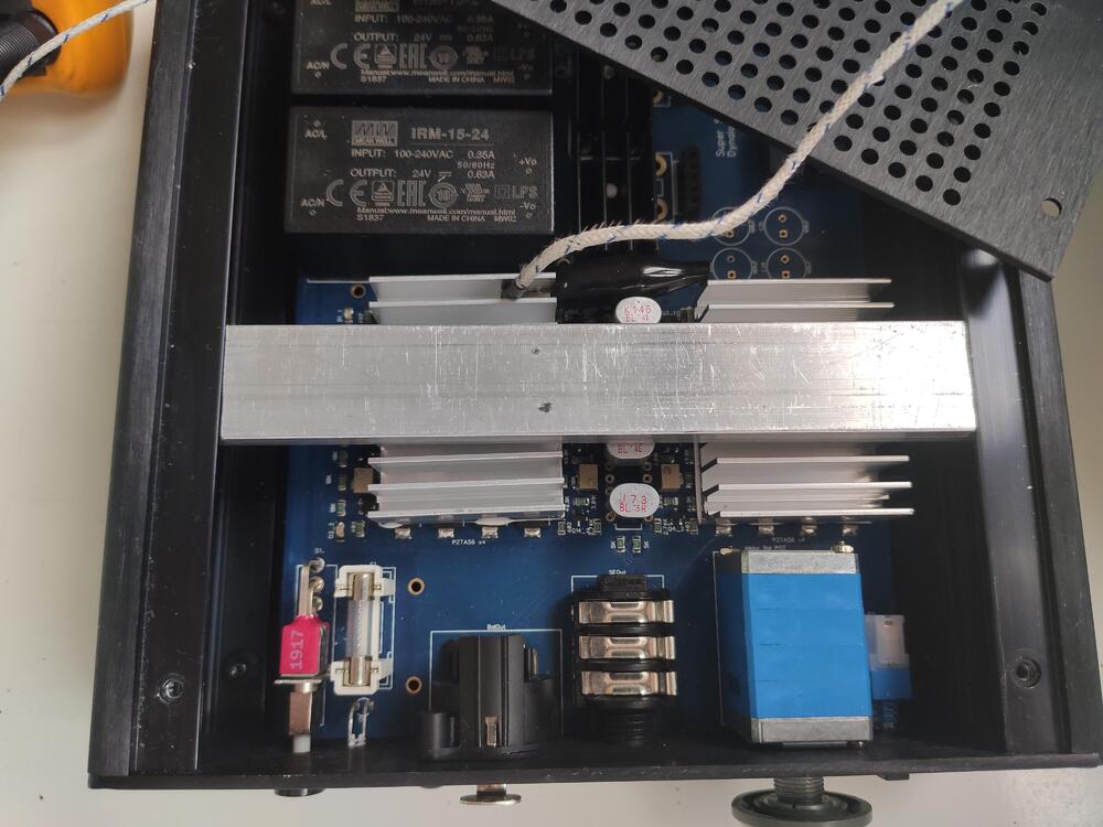

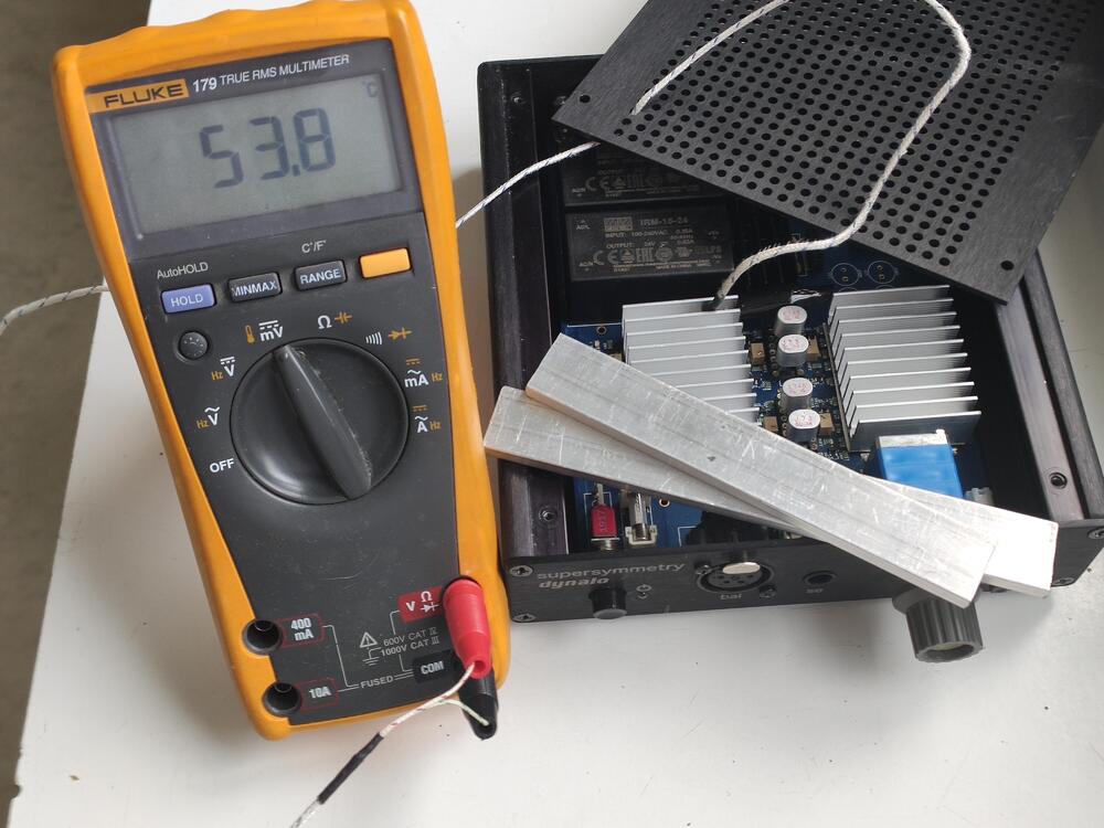

  11. To the heat issue: I have a "standard" mini from the first group buys. Case, the unfortunate 3 oz board, 402 led resistor, 255 bias resistor, 15 mA bias. I used it with offboard regulators and without the top cover mainly for a time. Now I squeezed in the onboard regs second times a bit better with the same heatsinks but only with open lid. I would not like to reduce the bias so I experimented with @Skooby's resolution(see in this thread) a little. In my version there is almost 10 mm the distance from the transistors's heatsinks to the lid so I made a "heat bridge" from two 5 mm thick aluminium pieces as you see in the picture. The result is more than I hoped. Measuring the temp on the heatsink hotter side: with the top cover 85-86C; without the cover 70C. With the "heat bridge" and the cover 63C. The absolute temperature is depends on the ambient, the music, the headphones a bit but the more than 20C gain is stable. This was a surprise to me, the mod is easy maybe helps somebody. You can secure it with screws, widen it etc.. Maybe later. It is stabil mechanically I am happy with it as is. Thanks for Skooby! The temperatures were measured after cc. 90-120 minutes when they were stable.
