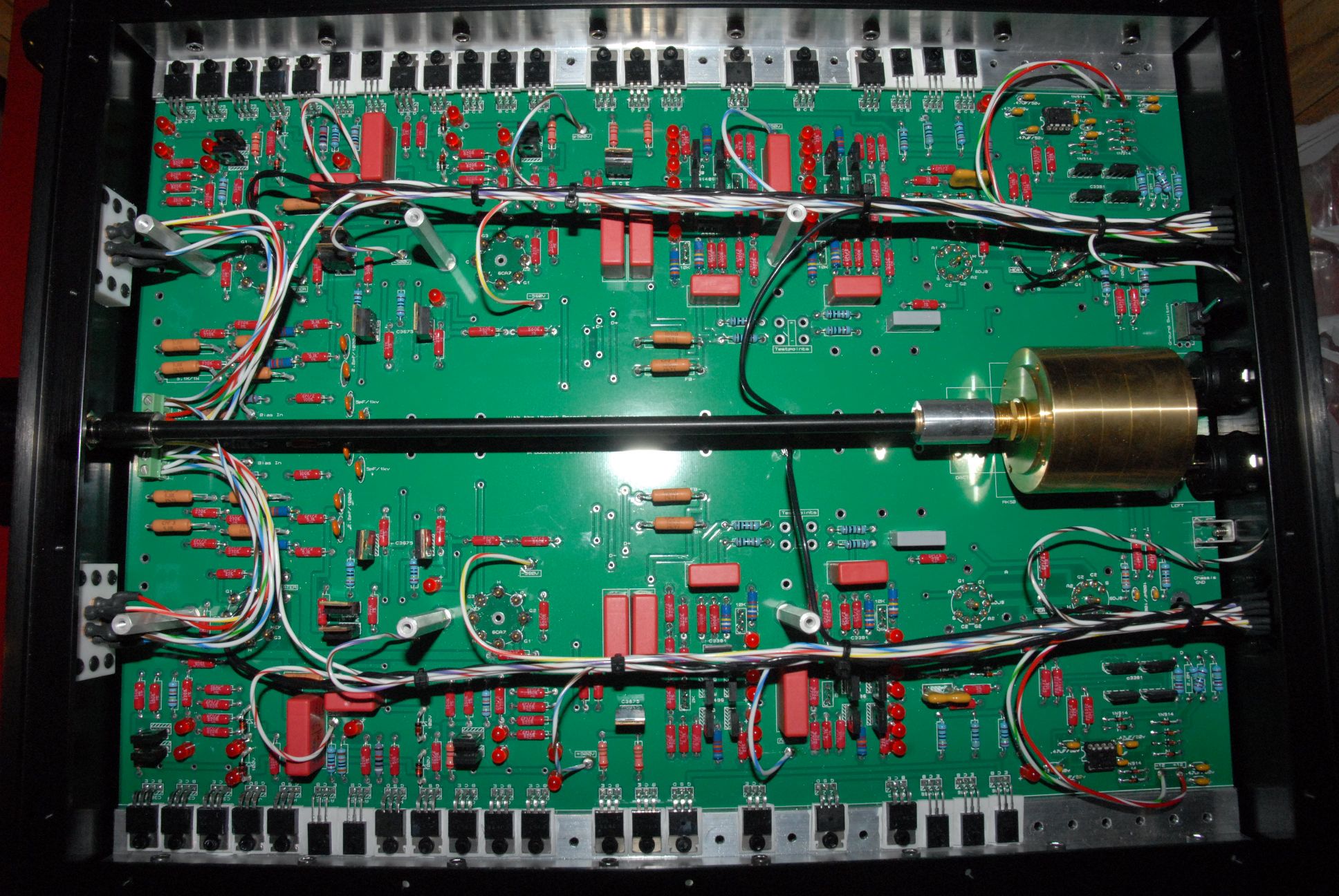

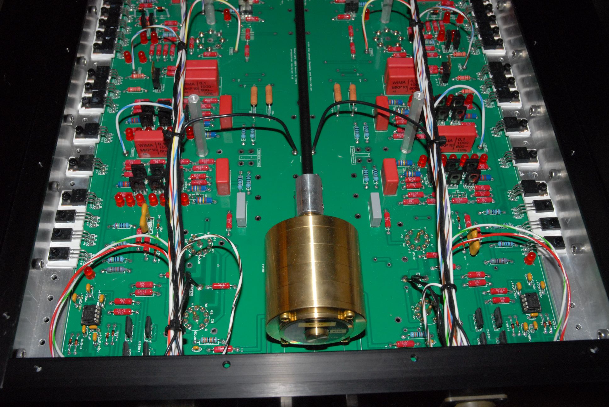

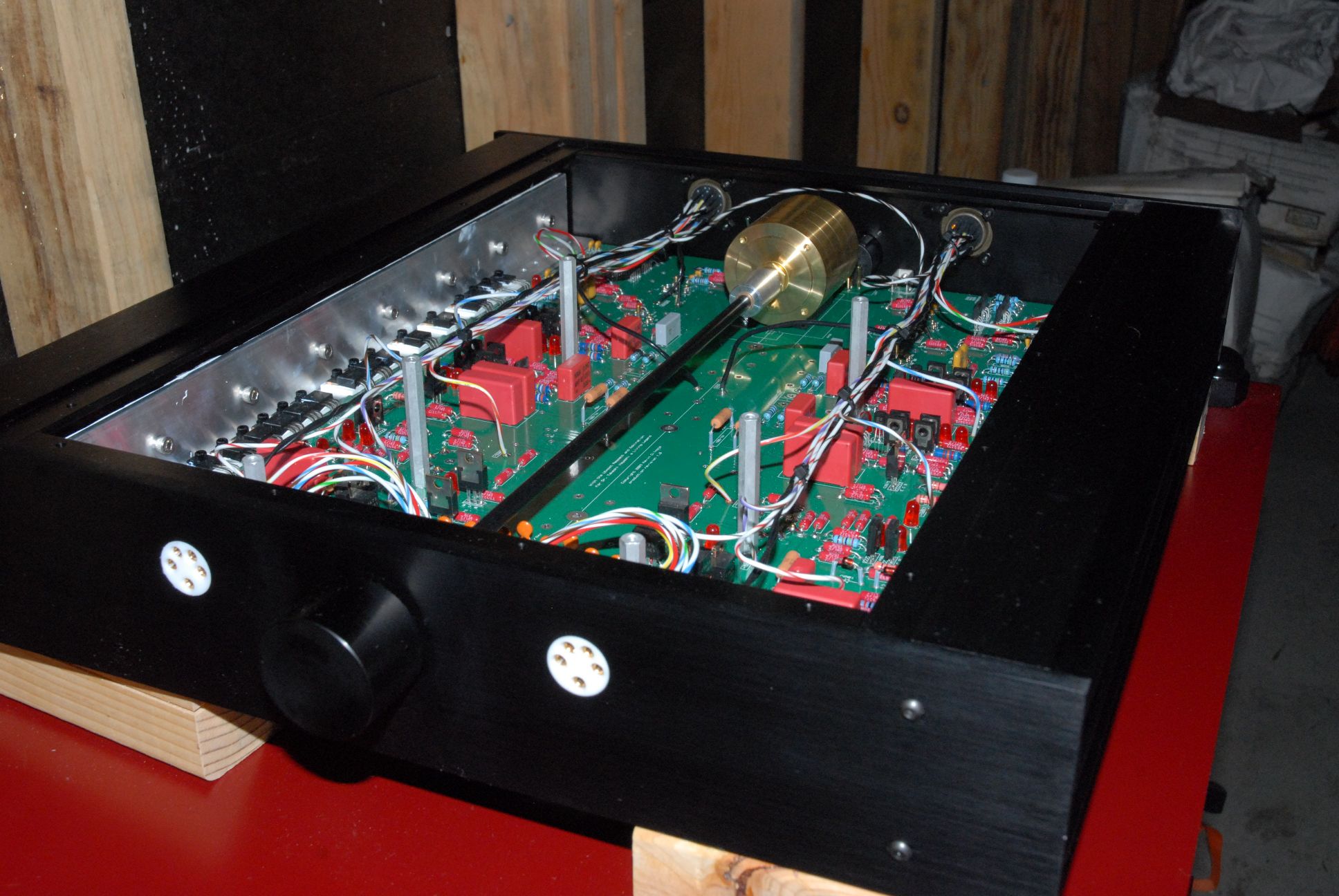

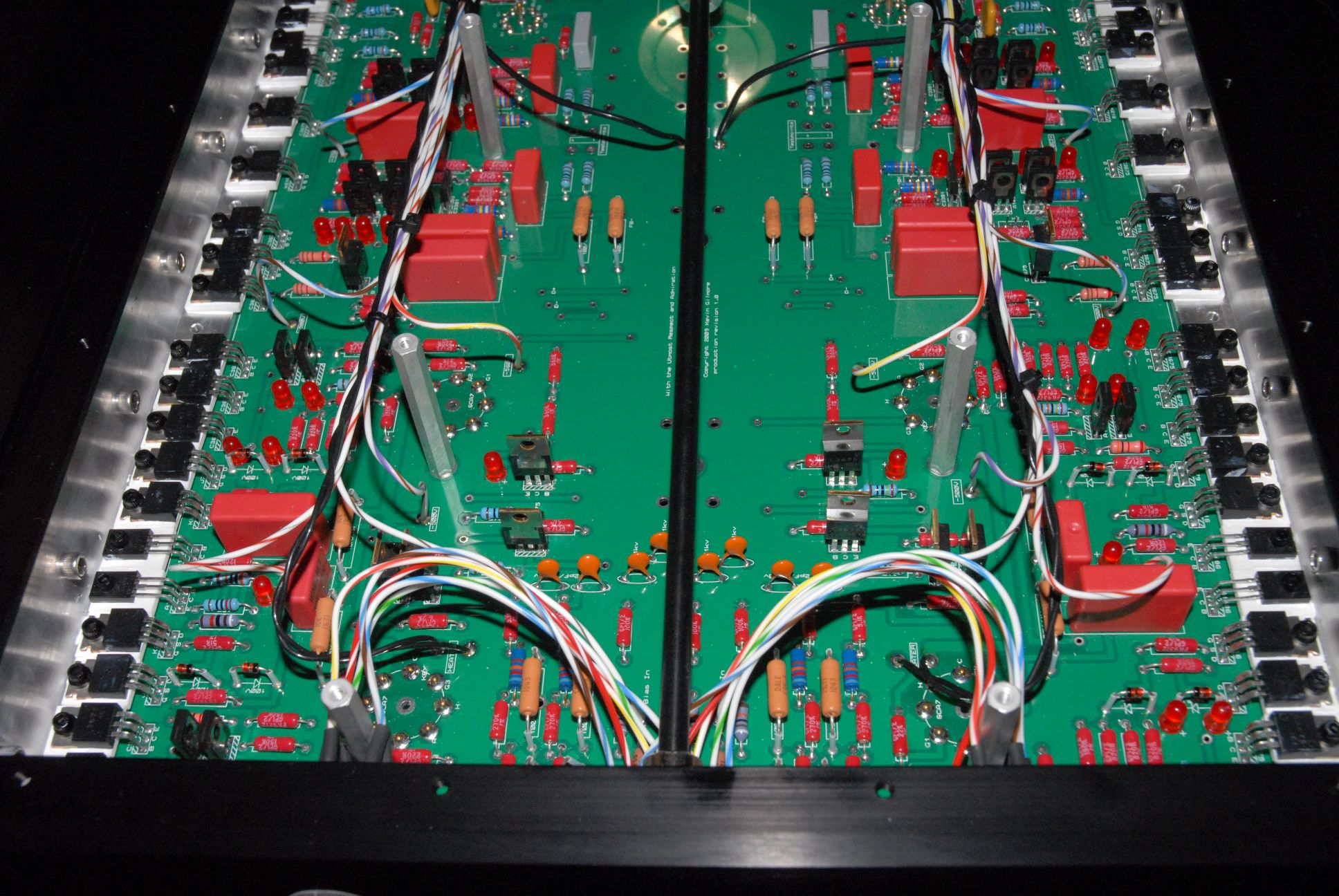

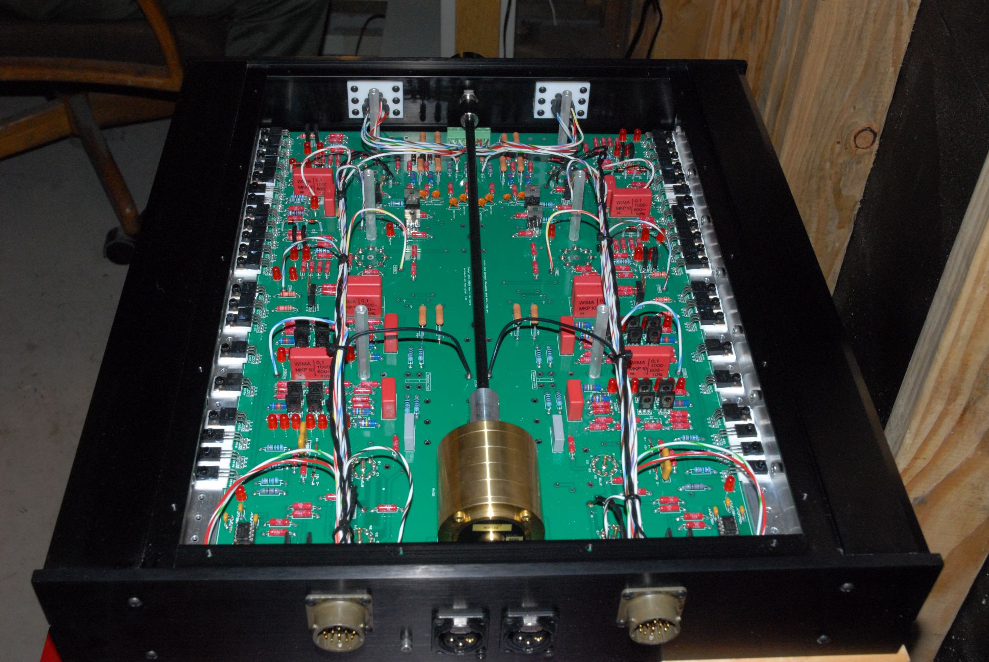

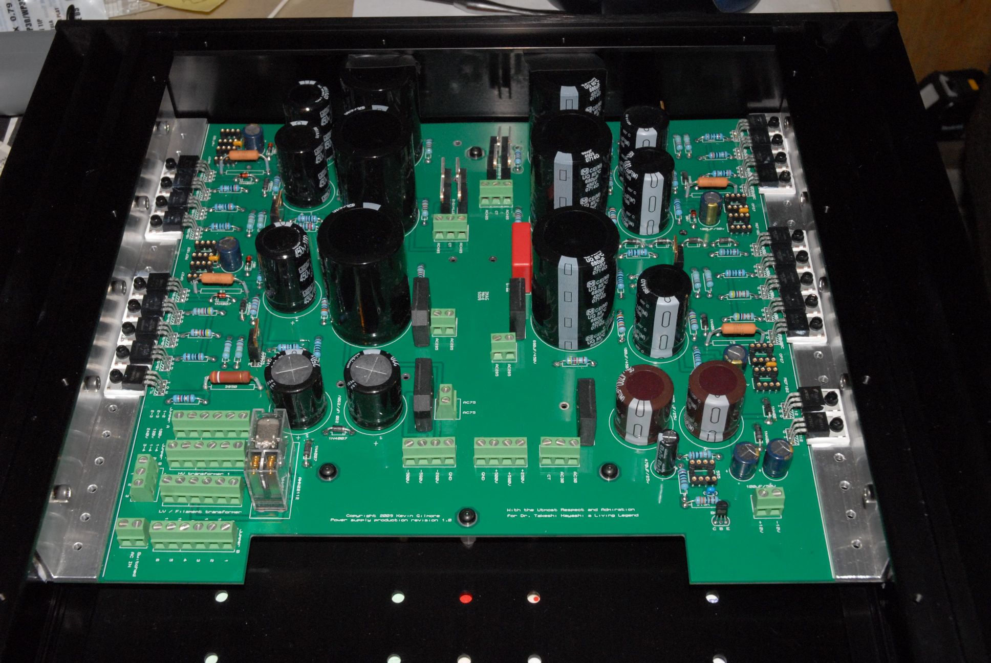

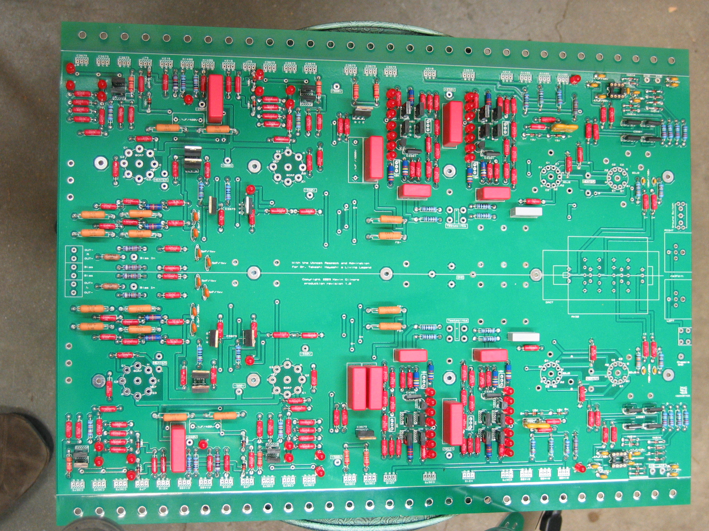

  13. Amp section done, just waiting on the transformers now. [ATTACH=CONFIG]4116[/ATTACH][ATTACH=CONFIG]4115[/ATTACH][ATTACH=CONFIG]4114[/ATTACH][ATTACH=CONFIG]4112[/ATTACH] [ATTACH=CONFIG]4111[/ATTACH][ATTACH=CONFIG]4113[/ATTACH][ATTACH=CONFIG]4117[/ATTACH]
