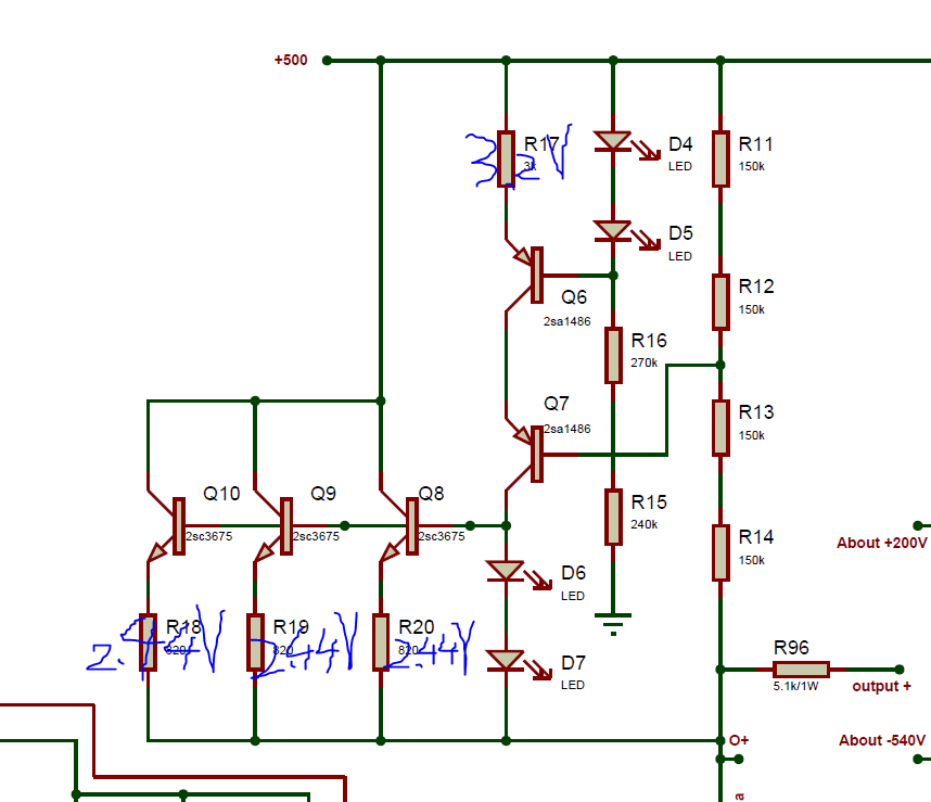

	@simmconn Thanks for your explanation, once again ๐ Sorry for the confusion and yes I meant D6/D7 (or D10/D11). Specifically, taking one side of CCS as an example: 1. V(D4) + V(D5) = 3.6V, Vbe(Q6) = 0.45V, V(R17) = 3.2V, this is all good. 2. Probe across R18-R20, all gives around 2.4V 3. Probe across B-E of Q8-Q10, all gives 0.57V 4. Probe across D6: 1.8V 5. Probe across D7: 0.7V (and probe D6, D7 together gives about 2.6V) D6, D7 look as bright, first round of trouble shooting I already replaced all LEDs and elevated them from contacting the board. Amp powered off and I diode test them they all fine with around 1.83V of Vf. So 2-5 makes no sense only thing looks ok is Vbe across C3675s. I will go ahead and check board connectivity tho. (Everything looks wrong when one probe is stick to O+?)

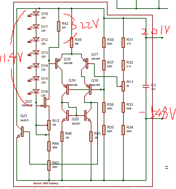

	I went back to right channel, wouldn't really call it working since balance is still a whack where offsets are a few volts apart. Battery JFET CCS is stable, no drift when trimming and I went back measured a couple times they sit at 6.55V fine. I thought because offset is low enough if I can figure out the balance stuff then I get a working channel at least from DC standpoint and I can use it as reference, turns out lotta things around output still measure weird. For left channel, output offset are both around -40V, point C and D both measures -3.5V. For right channel, output offset are about -4 and -10V, point C and D both measures -0.65V. So in both channels C and D are not exactly 1/10 of output offset and C and D seems always have the same voltage. Q37-Q40 are probably working fine, as current through R84 - R87 matches what the current mirror should do. For this, in both channels Vbe across Q32 is about 0.6V, which seems fine, Vbe across Q33 is however about -0.2V... that explains when I measure them together total voltage drop is about 0.4V. I don't know how much of these are affected by my 10Mohm meter impedance, I will try to see if I can borrow a high impedance volt meter to use. So far this has been pretty confusing.. But thanks again for your patience and explanation! Yeah overall the use of Q23 seems pretty marginal on paper, according to the datasheet it also seems it's operating on the boundary of SOA at 740V Vce with a few mA of Ic.
	Sorry that was a typo, I mean change RV1 after setting 6.55V across R42, fixed. ๐ I'm pretty ignorant would you mind explain how do you derive the theoretical value of 786V battery voltage in this setting? might help me understand how the trimmers actually affect the voltages. Also I assume the 6.55V reference voltage came from it being the center value of the range of which RV1 can set the voltage at base of Q17 (6-7V) when battery voltage is 740V, is that true? Thanks!

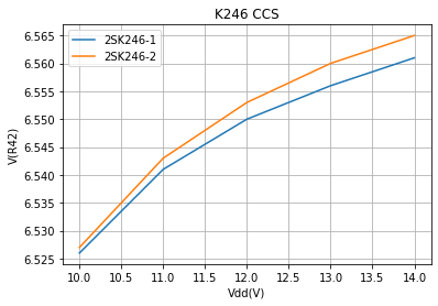

	Replaced K246s in the right channel with a couple that I previously breadboard tested as CCS, everything is still the same. tbh I don't exactly know if I have problem with the CCS on it's own, right after trimming when I measure voltage across R42, it could be my meter throwing things off and some LED somewhere when off and voltage becomes around 6V, if I leave it alone for a bit came back and measure the voltage is back at around 6.5V, only slightly lower than 6.55V. The ones I took out also doesn't measure like anything suspicious on my transistor tester. I measured connectivity of things around Q32 and Q33 from both sides of the board, nothing suspicious. I also directly measured voltage drop from the base of Q33 to the emitter of Q32, it gives me 0.38V, would this make even a tiny bit of sense considering say the rise in temperature combine with the fact that the amount of base current going into Q33 is tiny? I feel there could be a relation between offset and my negative battery voltage? So I don't know if this is normal but when I set RV1 to R32 side, and trim RV2 to set voltage across R42 to 6.55V, my negative battery voltage will be reduced from -561V down to around -541V, positive voltages are somewhere above 240V. Then when I trim RV2 RV1, as positive voltage decrease, negative voltage likes to slowly kick back for a little bit. This happens in both channels, when positive voltage reaches 200V, right channel (lower output offset) kickbacks to -543V, and left channel (-40V offset) kickbacks to -547V. I don't know what's causing this, but as a consequence my negative voltage will never go below -540V in any case. (before replacing LEDs both will go back to -548V) Lastly I'm considering the hfe of Q23, as it was discussed in previous thread that we'd want highest hfe possible. Measuring them with my toy tester, at Ic = ~6mA, right channel has hfe of 44/47, left channel has hfe of 40/44. I have a small stack of back up 3675s, the highest I can get are 1 at 53 and 4 at 50, all the rest are between 40-50. I can try replace them but I'm unsure if that is related to my issue, as I currently have 4.8mA going through Q30 and Q31 which doesn't seem far off from 5mA on the surface and am also unsure if increase hfe by this small margin would help.

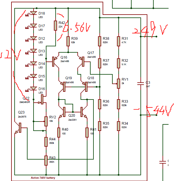

	Definitely regret saying the famous last words, all LEDs replaced in left channel and I'm still getting -30V ~ -40V of offset at output, and balance servo is not kicking in neither as +/- output likes to stay a few volts apart. I measured as much node as I can think of, after setting battery to -547V/200V. EL34 plate load CCS measures fine, current going thru R17-R20 adds up to 10mA Output tube voltages measures ok on one side, the other side measures worse with -453V at cathode and -457V at the gate of the 2sj79. Current going through Q26 and Q52 seems fine. input stage CCS voltage I'm not sure if I'm measuring the 207V correctly with my handheld meter with 10Mohm impedance, if this is indeed 207V then Q4 and Q5 are seeing a Vgs of about 7V? And lastly the bottom part point C and D are both around -3.5V. I also tried to measure a 2sa1413 with very low collector current on a scratchy breadboard circuit, at Ic = ~46uA hfe is somewhere above 90, which should be fine. Other than that I have set the battery voltage to -547V/200V, leaving the trimmers alone and turn off the amp, turning on again when high voltage kicks in for an initial period battery voltage likes to be -500V/245V, then all of a sudden it becomes -547V/200V again and stayed... Also isn't the current going through Q30 and Q31 coming from the battery via Q23? In that case I'd expect a few volts drop across R99 and R100? Which when I measured there isn't any. Is there anything looks obviously suspicious from my measurements? Would really appreciate any input, thanks!
	@simmconn Sorry about the confusion, for LED what I meant is, Vf = 1.8V @ If = 0.5mA is straight calculated from the schematic if I look at D1 and D23 and Kevin's notation on current through Q1, Q2, Q3, Q28, Q29, assuming base current are negligible and all Vbe are 0.6V, hence this is a theoretical reference value. Vf = 1.725 - 1.750V @ If = 0.5mA is when I measure LEDs on the breadboard, both from a new batch and from D1, D23 and another one in battery taken off of the board, as plotted, a little lower than the aforementioned ref value. Vf = 1.57 - 1.6xV is measured from D1, D23 on board when amp is powered on, I didn't measure individual ones from the string in battery but 10.7V drop across 7 of them falls in the same end - all are considerably lower than even the values measured from breadboarding. This made me assume all my on board LED Vf are degraded by a lot, hence so are the current through all the transistors referencing them, results in operating point of output tube to be off and hence the large offset. I just done replacing all the LEDs with the 3RDL-S and made sure they are elevated from the board in the right channel. Power on I can now relatively comfortably set voltage across R42 to around 6.55V. When setting battery voltages to -544V/200V and -543V/200V, output offset from +/- are around -3V/-8V. Checking voltage across D1 and it's now 1.79V. Now -3V/-8V offset values by themselves I believe is within sanity, the difference however made me wonder if there is something wrong with my balance servo.. But before worrying about that I'm gonna replace the LEDs in the left channel first. (I have not taken out the on board k246 for a measure yet just because I'm confident they are genuine so only after trying to fix the LEDs) Again many many thanks for your help and detailed explanation! I definitely started off not understanding a single thing about how this works but with your guidance I'm able to troubleshoot simple things little by little ๐ For the first time in a long time working on this amp that I have a good feeling of getting pretty close now (famous last word), ofc still some distance to go.

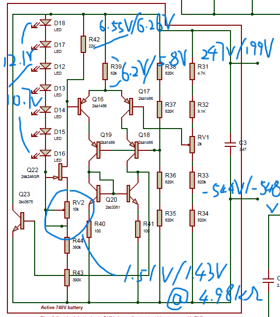

	I went on and measured more things outside battery while setting battery voltage to 750V: Seems like everything is a little off. I suppose the key to get correct low offset at output is to get the output tube operating point in place (without considering the feedback shenanigans that I don't quite understand๐ต), with grid sitting on the -500V supply it should come down to getting the plate load CCS and cathode voltage in place. Other than the previously mentioned battery adjustment weirdness, measuring voltage across D1 and D23 I got 1.57V-1.67V, definitely on the low side similar to what I found in the battery. Also battery seems to be not outputing any current with little to no voltage drop across R99 and R100. LEDs With current noted on the schematic, at least for D1 and D23 they be running at about 0.5mA with a forward voltage drop of 1.8V (if all base current can be ignored). I took D1 and D23 and another one from the battery for a measure. LTL4213_old is taken off from the board, only plotting one as they all measured similarly, LTL4213_new is another batch I bought recently, along with the Cree C566D also a 2.1V red LED with nominal forward current of 20mA. These all measured pretty much the same, on the lower side of 1.8V but strangely never went down as low as around 1.6V as I measured in amp when operating. Only thing I can think of is derating due to the negative temperature coefficient? 3RDL-S is a 2.1V red LED with nominal forward current of 2mA, as expected the curve shifted to the right side. Seems to be a shot in the dark but I shall replace all LEDs with 3RDL-S and sufficiently elevate them from the board? (which I didn't do with the current LTL4213s on board..) 2SK246 I didn't take out the ones on board but gotten a few backup ones from ebay, hook them up on the breadboard and set voltage across 22K resistor to around 6.55V at 12V supply voltage from the bench. Then sweeping supply voltage nothing surprising and they regulates fine... Resistors I replaced R33, R34, R43, R44 with 500V rated resistors - as I just realized voltage across them will always be a little above 350V, and this doesn't change anything. So I think I'm going to replace all the LEDs this weekend, although it seems everyone else are using LTL4213 just fine, possibly still not the cause of my problem...
	This is really helpful, thank you so much! I'm way too ignorant on this so I wanna verify if I understand things correctly. More probing around the battery with Vgs on 2SK246 now, "/" is before and after trimming RV1 to bring down battery voltage to around 740V. So in theory assume base current of Q16 is negligible, while the regulation on the LED string is not ideal, Q22 shall work as a current source fine despite the Vds drop from 4V to ~2.65V, that means regardless the LED is not the source of my problem right? Now the current running thru R42 before and after are 298uA/284uA, current thru RV2 before and after are 303uA/287uA, while not super accurate but it seems the base current of Q16 is on order of magnitude of a few uA and had changed about 2uA, this can cause Vgs of Q22 to change about some tens of mV depending on RV2 value, enough to say that whatever Q16 is doing here, it's effect on the CCS is indeed negligible? That lead to the conclusion the first thing I should do is replace the 2sk246 right? And breadboard test them with a bench supply varying input voltage around 10-12V with R42 and RV2 in place. Is there a recommendation on readily available replacement of this part? Thanks again! ๐
	Many thanks @simmconn! Things I know so far: PSU voltages sits still as I tried to trim the batteries closer to 740V, none is loaded down. Also unlikely that I'm running on the boundary of current limiting because I trimmed one channel at a time while leaving another channel with batteries not conducting? monitoring total power consumption it is 30-40W lower than bringing both channels to be on. All resistors seems fine, no visible damage and ones below 100kohm I can measure on board and values are correct. Measured two C3675s in same channel on board with toy tester, hfe are both around 48 When I set RV1 to R32 side, I can comfortably set voltage across R42 to 6.55V, this is what I get: Then I leave RV2 alone and turn RV1 to reduce positive voltage to ~200V, I got: I remember reading somewhere that LEDs need to be 2.1V, mine with handheld meter all measured around 1.7V, but I guess around below 1ma bias current in circuit this sounds about right? I unfortunately don't have any spare k246, best I can do is pop one out and find replacement if they are malfunctioning. Gonna measure more nodes over the wknd

	๐Right channel is exactly the same story - negative voltage likes to bounce back from - 544V to -549V and stay when trimming RV2, with RV1 bringing positive voltage down output offset just keep increasing, and is -125V/-151V near -549V/200V I found one thing though - if I start off setting RV1 wiper to the upper R32 (9.1k) side, trimming RV2 I can easily set 6.55V across the R42 independently and they stay there, until I trim RV1 to bring down the positive voltage, they drift to something else between 6.2V-6.6V. This happens to all 4 batteries.
	thx, I will do that in the next few days (I remember last time I tried the behavior was similar). When I do that should I leave left channel in this current state?
	Thanks for the help! Yes I only used RV1 to adjust positive battery voltage after trying to set voltage across R42. And yes I can set overall battery voltages to 740V too: because the negative voltage is just staying there at -549V I just keep further trimming RV1 to bring down another 10V on positive voltage, that gives both battery voltage -549V/191V. Now output offset just increase to L- = -123V and L+ = -150V, measure R42 again it's 6.35V and 6.6V
