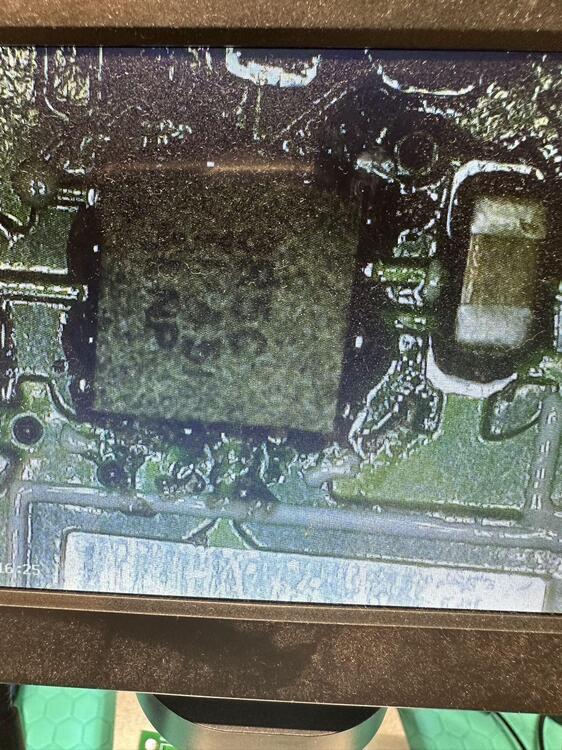

BTW, do you know what kind of DC-DC chip on the picture? Too blurry for me to read.

I don't what chip it is.
Marking might be???? Very hard to see.
26QH
288
A3HL
Including in curcuit is also dual comparator 2093B and  .05R sense resistor.
Good luck and looking forward a report.
11 minutes ago, JoaMat said:
26QH
288
A3HL
Find it. I will share the info here anyway if you are curious. The switching freq range is between 900 to 2400(kHz). Lower than the LMQ, but shouldn't have any problems.
https://www.ti.com/product/TPS62913

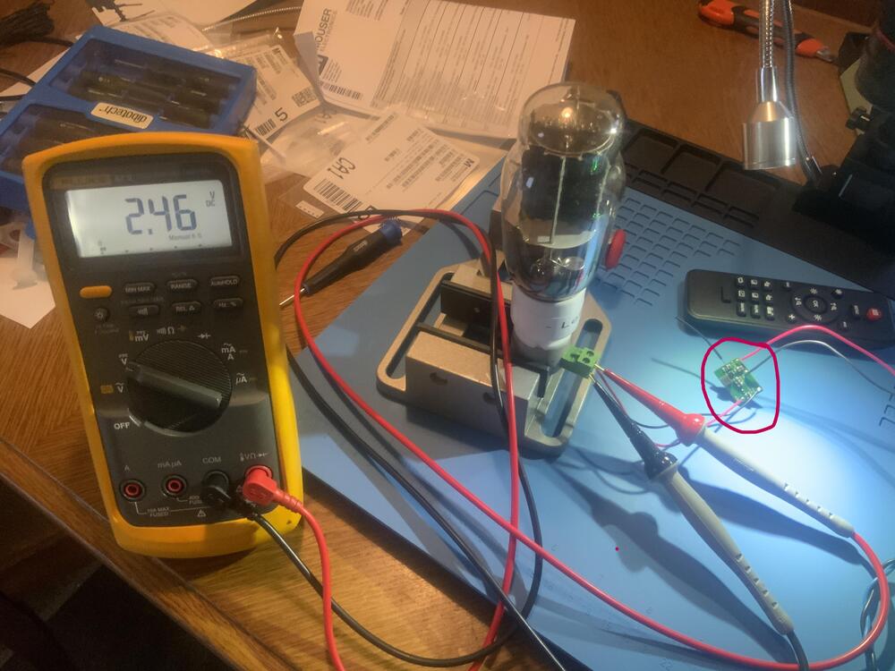

Good news: It works!

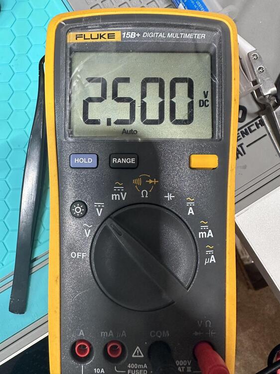

Measured output is 4.9V for the 5V setting, 6.1V for 6.3V, and spot-on 2.5V for the 2.5V setting.
I haven’t tested the soft-start function yet — if anyone has good suggestions on how to choose a suitable load resistor for testing, I’m all ears.
Bad news: I spent two days figuring out how to hand-solder with a heat pad and heat gun the QFN package. Even when using a stencil, too much paste tends to remain on the pads, which makes them very prone to shorting.
As a result, I ended up ruining two boards and some components. At this point, I really don’t feel like assembling the remaining three boards myself. I think it’s best to leave the rest to a proper assembly house.
Updates:
Soft start works. About 3.5ms rising edge time for 6.3V.

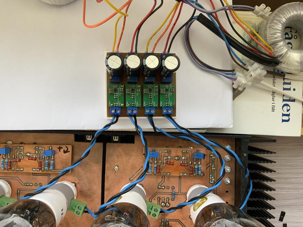

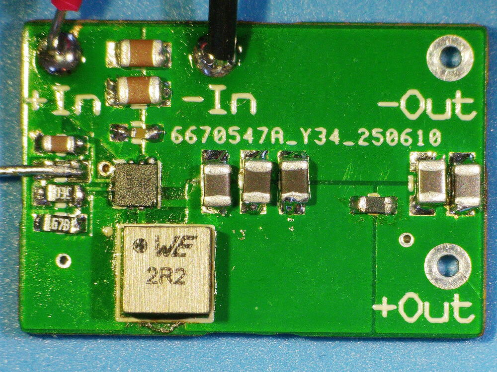

Thanks to @Shawn, who found the device used in Elekit filament supply module, I now have a working DHT switched mode filament regulator ”prototype” (in red circle).IMG_1837.JPG
Board size 23mm x 15mm (0.9in x 0.6in)
Soldering looks awful, but remember my eyes are 69 years old and my hands are not that steady.
Edited by JoaMat
Great to know that. You could further reduce the PCB size by using a compact bridge rectifier like the CSPB40K-HF. It has a much smaller footprint compared to standard rectifier packages and still handles decent current.
Like the way how you fix and test the 2A3 tube.

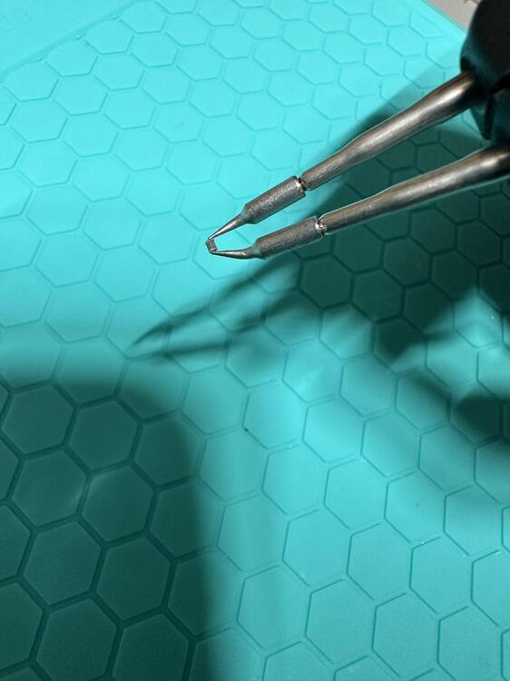

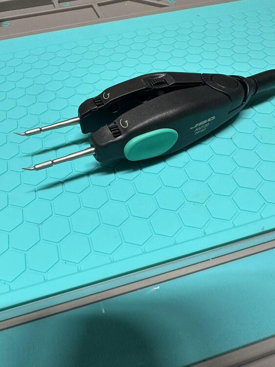

Recently, I purchased these soldering tweezers from JBC to perform SMD work. Nice and decent.

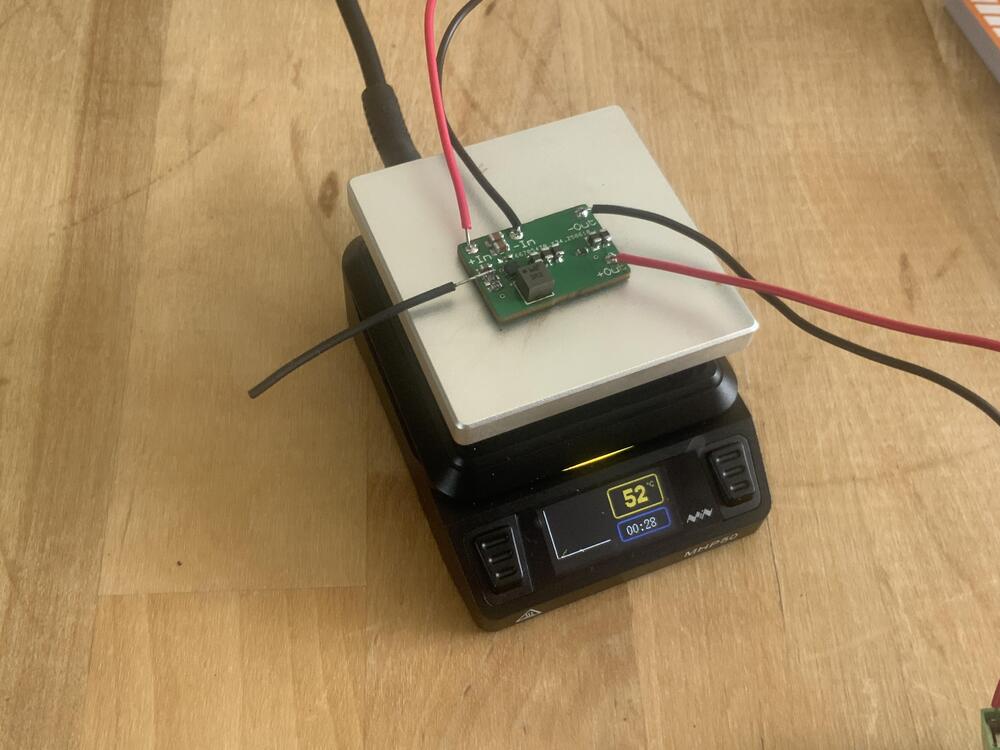

 I used a Mini Hot Plate when soldering the buck converter and inductor. First a thin layer of solder and then up on the plate. 150 degrees Celsius for a minute before up to 250. Rest of components are hand soldered.

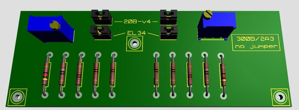

I’m planning to use ±400 V for the supply with an anode current around 23 mA. I noticed that on Kevin’s PCB layout for the 300B, the cathode resistors are shown as two 3300 Ω parts. Do you think I should replace those with 3600 Ω instead?
Also, for filament voltage switching, I’m using the pin header setup shown below(MPN: 0010897120). Each row corresponds to 2.5V, 5V, 6.3V, and 12.6V, and I also left one extra row reserved in case I need it in the future.
C-Grid 70280 Series 12 Position Gold
I’m using a single cathode resistor. When you are using two 3300R resistors, as on your board, I guess that is equivalent to one 1650R. If you follow silk screen you will get -100V or so on output. You probably need to double resistor values. Maybe someone out there can tell more about this.

Last night I did the first power-up. I used some very inexpensive 300Bs just in case anything went wrong and to avoid risking the expensive tubes.
Balance was actually very normal. About 5 V on one channel and 3 V on the other. But the offset was around –100 V on both channels. I’m guessing this is the “–100 V output” issue you were referring to? Let me know if that matches what you’ve seen.
I haven’t had time to swap the cathode resistors yet. Measured Vgk is about –42 V, which is clearly not deep enough. I’ve ordered some 7.5 kΩ resistors, which after calculation should bring Vgk closer to –90 V.
Also, for anyone interested, here are the LMQ66430 output voltage setting resistor positions I used on my board:

Today the 7.5 kΩ resistors I ordered arrived. To swap all eight cathode resistors I pretty much had to remove every screw on the chassis.
Long story short, the offset is much improved, going from –100 V to about +10 V.
Big thanks to @JoaMat for the help!
For me, this voltage is acceptable, but if someone wants to get even closer to 0 V offset, I think 7.0 kΩ might be the sweet spot.
Also worth mentioning: the G-grid adjustable pot on the board offers around 2–4 V of Vgk trimming range.
My 300Bs are running at ±400 V, since I feel 450 V is pushing things a bit too much.
I think the main reason(Correct me if I'm wrong) for the original –100 V offset was that the cathode resistance was too low, allowing too much current. This made the anode current too high, and because the EL34 CCS isn’t perfect, it compensates by lowering its voltage output. With the original 3300 Ω resistors, I saw the B+ drop from 400 V to 370 V under load.
One more note: after increasing the cathode resistor, Vgk sits around –80 V. For safety, I’d recommend replacing the original 220 uF/100V cathode bypass caps with 160V rated ones.
