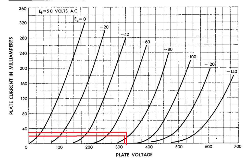

Shawn Posted September 5, 2025 Report Posted September 5, 2025 After some rounds of trial and simulation, I thought I’d put together a rough guide for setting the 300B operating point, mainly to make life easier when dialing things in. Given static operating currents: 34.3 mA → Rk = 2160 Ω, Vgk = –73.7 V, Grid pot = 10 kΩ, set around 10%. 23.8 mA → Rk = 3200 Ω, Vgk = –75.8 V, Grid pot = 10 kΩ, set around 10%. Plate voltage check (with Va = 0 V target): At 34.3 mA → Plate Voltage = Va – Vk = 0 – (–325.9) = 325.9 V. At 23.8 mA → Plate Voltage = 323.8 V. By matching these points against the 300B characteristic curves (see the red-line markers in the attached graph), the theoretical Vgk comes out roughly between –70 V and –75 V, which lines up with the measured –73.7 V and –75.8 V. From the curves, the 34.3 mA point looks more linear. Pushing current further could be even better, but that depends on whether the EL34 can handle it safely and whether the PSU has enough overhead. All of these measurements are under a ±400 V supply. The 300B datasheet gives a max plate voltage of 400 V (though some manufacturers claim 450 V). On the XL build, with 400 V rails, the plate voltage is about 335 V, and still within a safe zone. I haven’t confirmed the behavior at 450 V rails, but I’d expect plate voltage around ~380 V, which starts to get a bit risky. If anyone’s interested, I can run tests at 450 V and report back the voltages at each node.

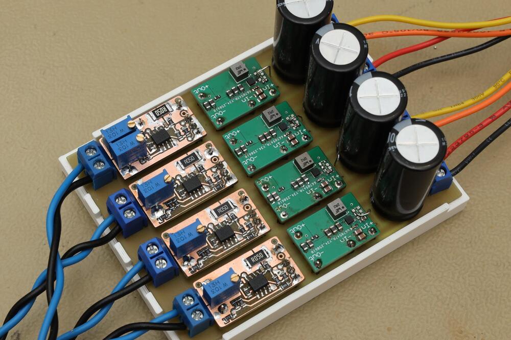

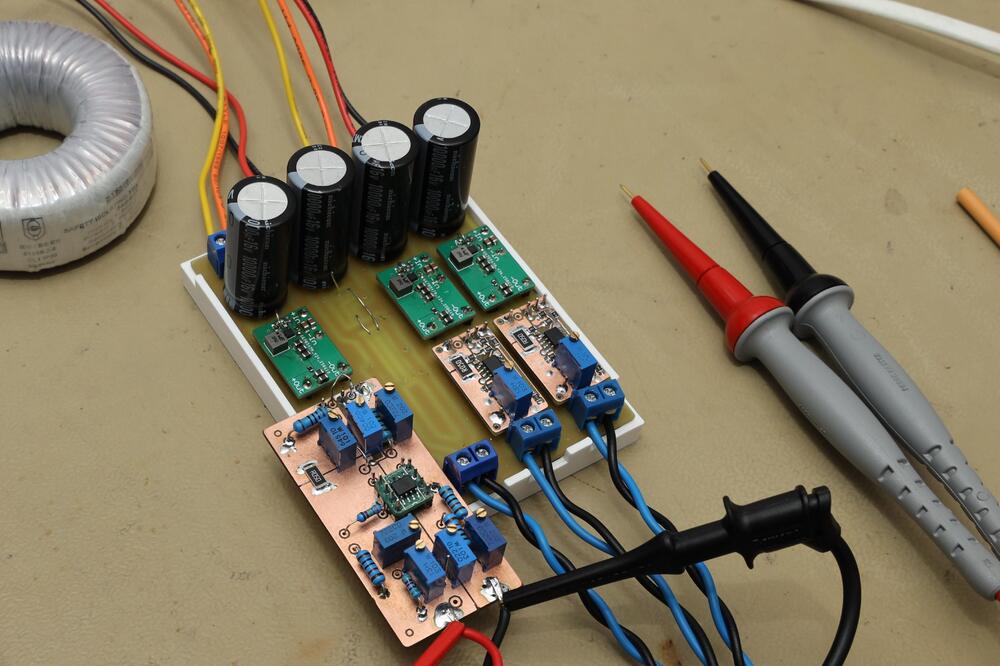

JoaMat Posted October 6, 2025 Report Posted October 6, 2025 A new daughter board to my Megatron something. It sets the grid potential of the output tubes. A few resistors, one trimmer set offset and the other the balance plus a small 120V GRHV supply completes the whole thing. So, I removed cathode resistor along with its decoupling capacitor. EL34 has Vgk 40 V and 2A3 has Vgk 92 V. The amplifier has solid state CCS (no top tubes). Works? so far so good. 2 1

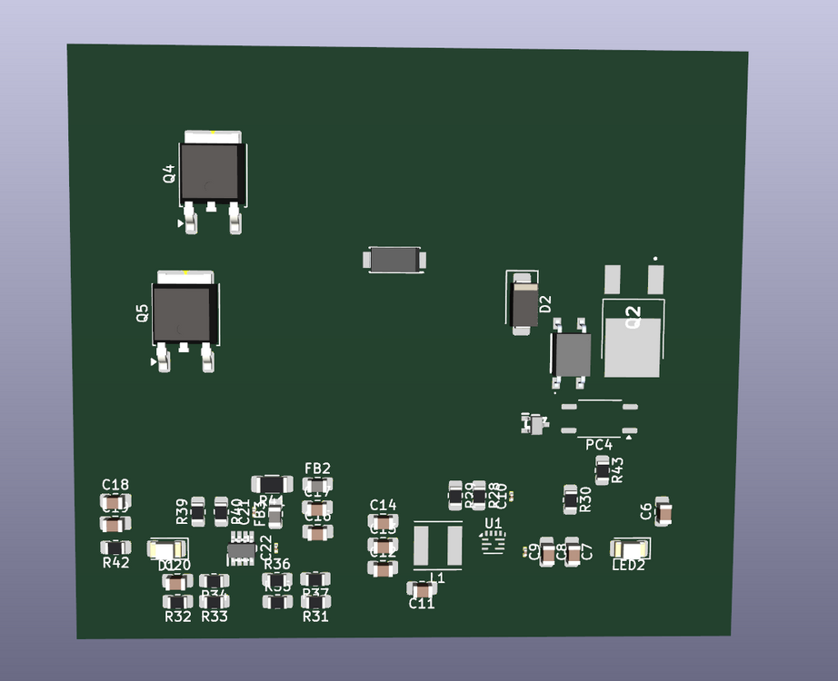

Shawn Posted October 10, 2025 Report Posted October 10, 2025 Thanks to @JoaMat for posting the 2A3/300B auto-switching filament supply. Although the picture isn’t very clear, I’ve been trying to figure out how it actually works. I roughly recreated the layout (still very preliminary, no routing yet. So please note it may/does contain errors. From what I can tell, the circuit likely uses the voltage comparator on the left to sense the voltage drop across a 0.05 Ω current-sense resistor, distinguishing the different filament currents of 2A3 vs. 300B. The two optocouplers at the upper right appear to be controlled by that comparator and might handle auto-bias adjustment. This is still an early interpretation. I’ll keep updating as I make progress or manage to get a cleaner schematic. On 10/6/2025 at 3:47 PM, JoaMat said: A new daughter board to my Megatron something. It sets the grid potential of the output tubes. A few resistors, one trimmer set offset and the other the balance plus a small 120V GRHV supply completes the whole thing. That looks really interesting. Can I ask a quick question: Are the two trimmers on top each setting the grid voltage vs. plate current, or are they controlling the grid potential of each EL34 individually? Also, is the 120 V GRHV section meant to supply the bias/grid voltage reference for the output tubes?
