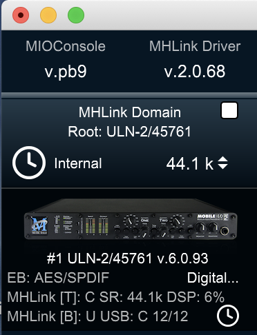

It's regular (frequent) but doesn't seem to follow a pattern. I always hear a click within 2 seconds, many times more often in that 2 second window.
I don't get the same clicks with the Ethernet connection. I can swap back and forth with the same source and it's only on USB.
I don't see them on the front panel.
I could look at the PSU, how did you pry it open?

If you aren't getting the clicks with MHLink (ethernet) than it isn't the power supply.
If you ever want to open it, there are screws beneath the rubber feet (on mine there are 2). Then pry it open on the iec end.

One thing that you might try first is simplifying your usb connection. It seems like the more stuff a cable/adapter tries to do, the more issues it can have ( I went through some Thunderbolt cable nightmares myself).
Also, the number of channels is maxed at 12.
Try decreasing it to 4 in 4 out. (right click the interface icon in the inspector).
I'm just using a USB-C to USB-A cable, no converters. When I change it to 4 in, 4 out it goes crazy and sounds like wrong sampling rate is being used. 8 in, 8 out sounds the same as 12/12 (clicking).
