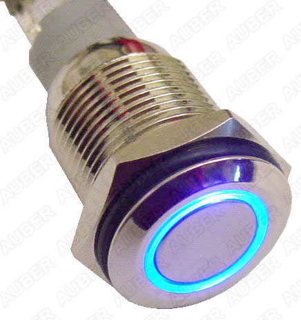

  15. Any suggestions for a sick looking front panel switch light other than the typical 19mm light on most builds? Looking for a change just don't know what to look for
