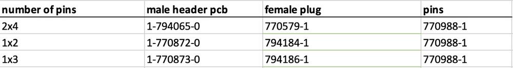

What is the difference to 1-770872-0? Looks absolutely identical to me.
