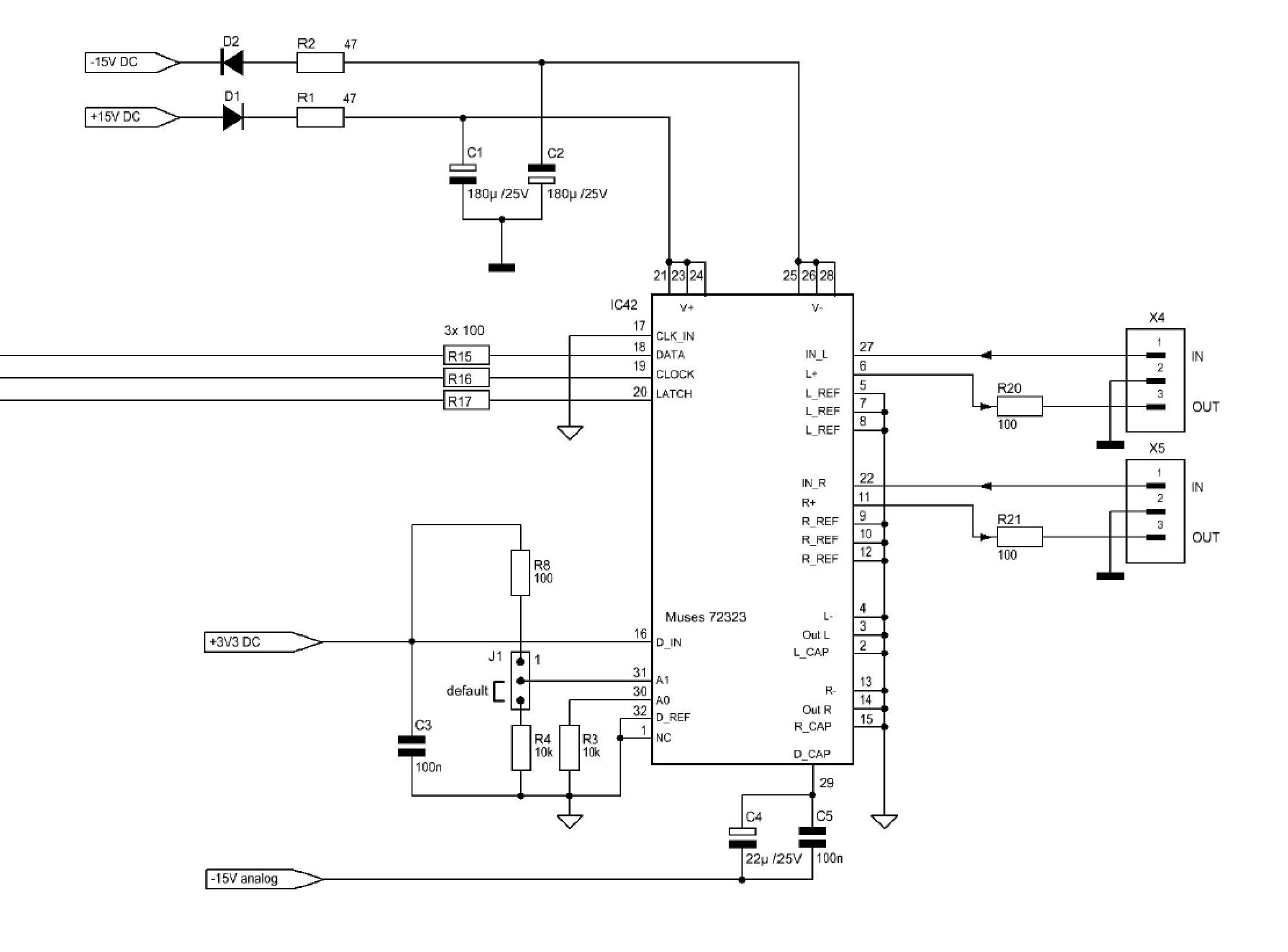

Here the actual attenuator based on the 72323 for one balanced channel (the 72323 already includes two channels, so + and - for us). The three lines on the left are coming from the controller. The jumper J1 sets the chip addressing for the left/right channel. Not sure if we need the 100R resistors on the output with Kevin amps, as well an opamp (like the Muses NJM2082), which according to the tech specs is recommended. -

Hey Pars, the BOM for that preamp says explicitly MUSES72320, are you sure you want to buy the 72323? The 72323 is the newer chip, has better specs, need less external parts and is cheaper. Unfortunately not compatible with the the older 72320. We should be able to take out the volume control portion of the code from there. I am making a balanced board atm that will sit at the amp's input and connect via cable to the controller board holding the encoder and the microprocessor itself. But the STM32G031K8T chip is sold out everywhere; ebay and AE remain only. -

Looks like he is not publishing the control software! The ST controller chips are completely sold out everywhere as well. Otherwise flashing the software is pretty easy with a ST-link programming unit and their IDE and the hardware part is straightforward as well. Btw, nice balance control can be implemented (in software) as the chips can be addressed separately and 2 are needed for balanced anyway. The newer chip is the 72323, not much difference, if any. -

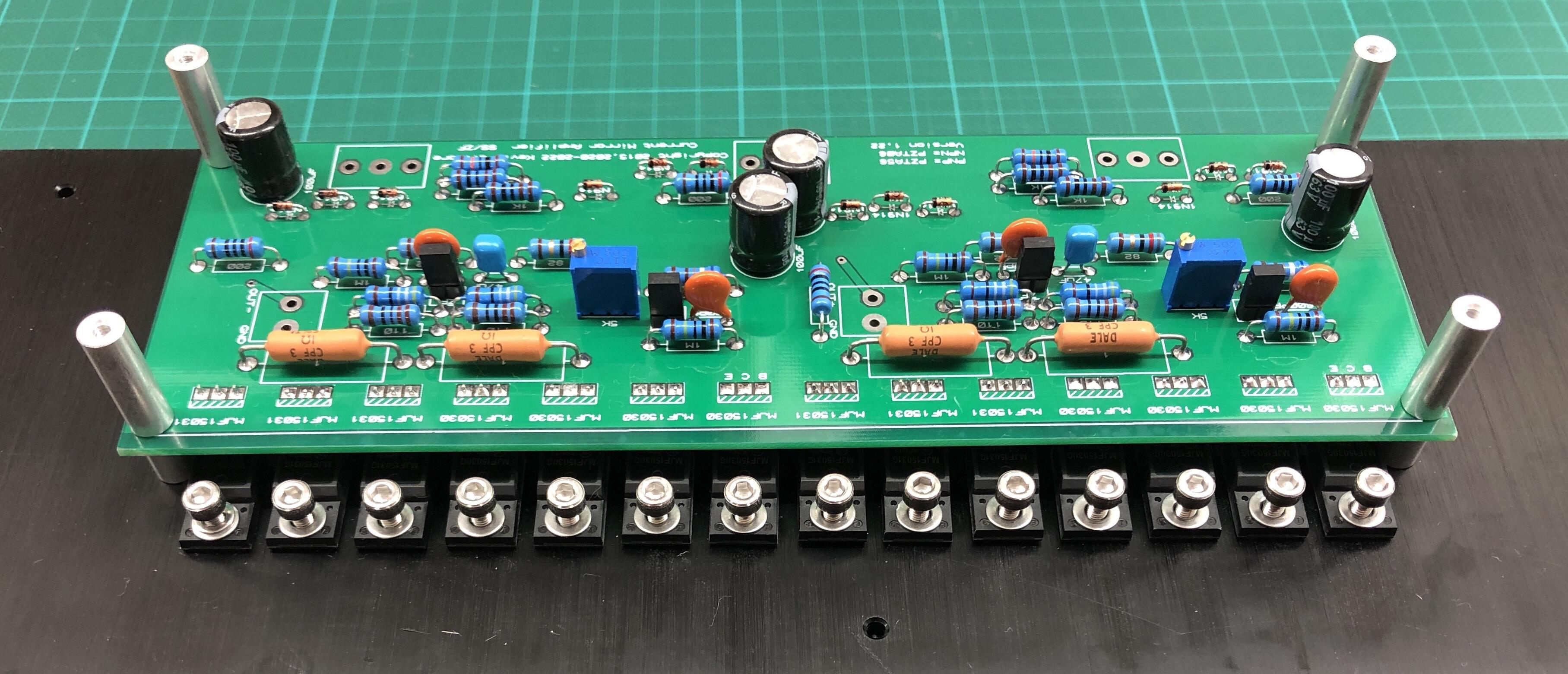

Looking nice! Are you going to bolt the pass transistors on the GRLVs to the heatsinks on the side of the case? They will need some cooling. First powering and adjusting the amp should be without the OPAs, so you can take them out for now. For the CFA3, I would advise to consider the headphone protector as well, which is pretty much a must for dynamic cans. It connects to Vcc+ of the amp and makes its own 12v out of a 7812 which is 1A and if you use a couple of low signal switching relays on the inputs, you can tap into it without the need for another transformer and voltages in the PSU.

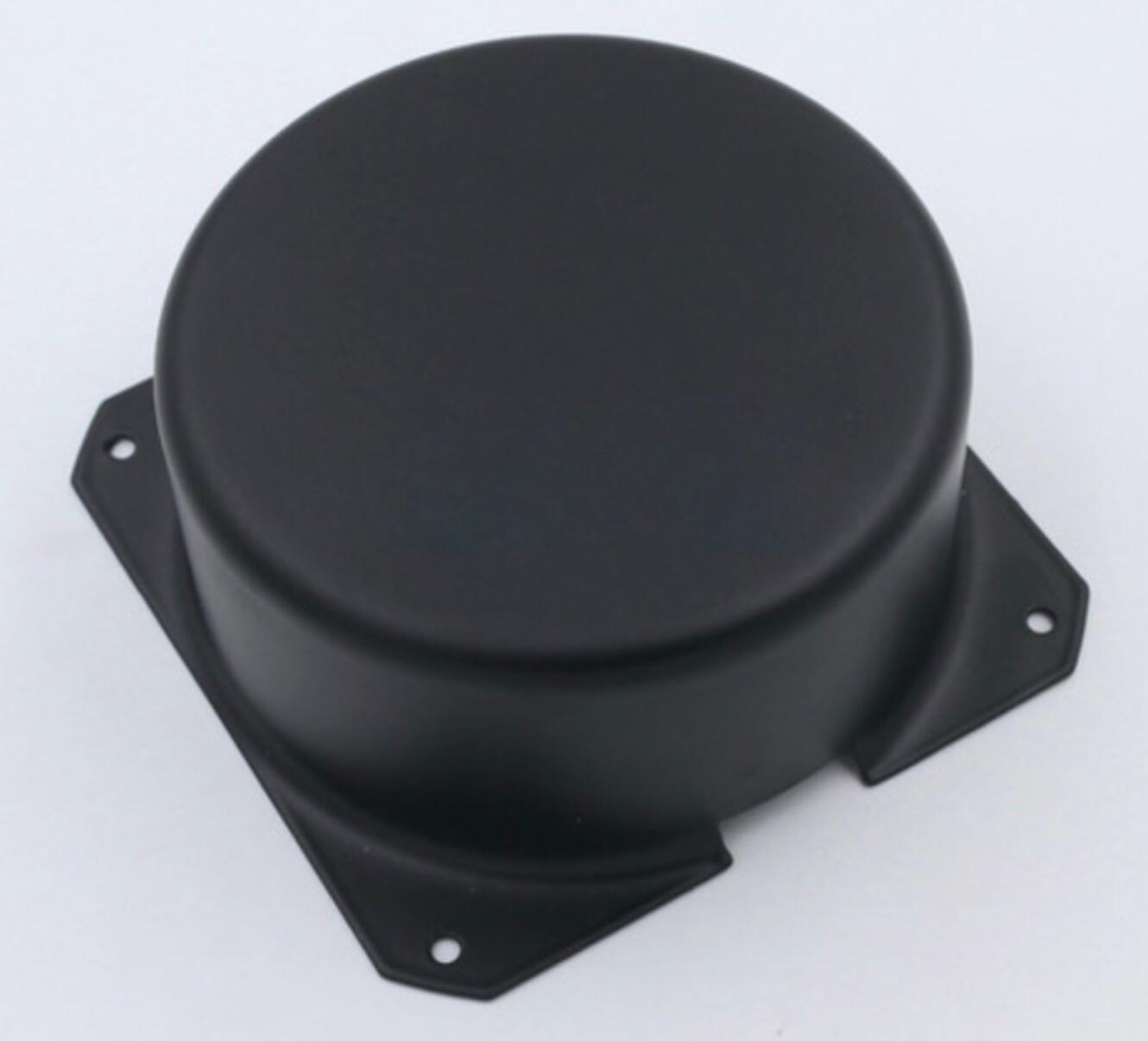

Using rounded button head would be classic. If not you might pot the transformer into a transformer case like this and then mount it using 4 smaller screws, which might be then countersink. You can then easily rise the transformer as well.

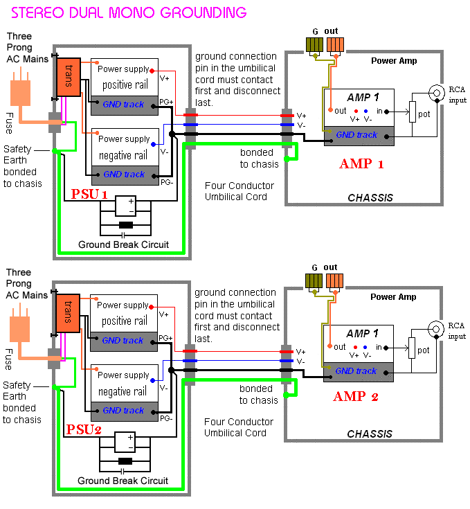

For isolation I would use Aavid insulators, mostly ceramics if there is enough clearance, Aavid PPS shoulder washers and stainless steel mounting hardware tightened to 0.8Nm (M3 or #4-40 allen head screws). The Aavid insulators and shoulder washers are available in different sizes, depending on transistor packaging and size. I am attaching an ONsemi paper as well including mounting considerations for power transistors. For grounding follow this scheme, which shows pretty much the most complex case of a two box design, amp with a separate PSU chassis. Pic shows single ended amps, balanced would be slightly different as the signal do not touch ground, the amp chassis would change so that the inverted signal (cold, pin 3) would go to a second amplifier board instead to ground. Overall idea should be pretty clear however. Mounting Considerations - AN1040-D.PDF

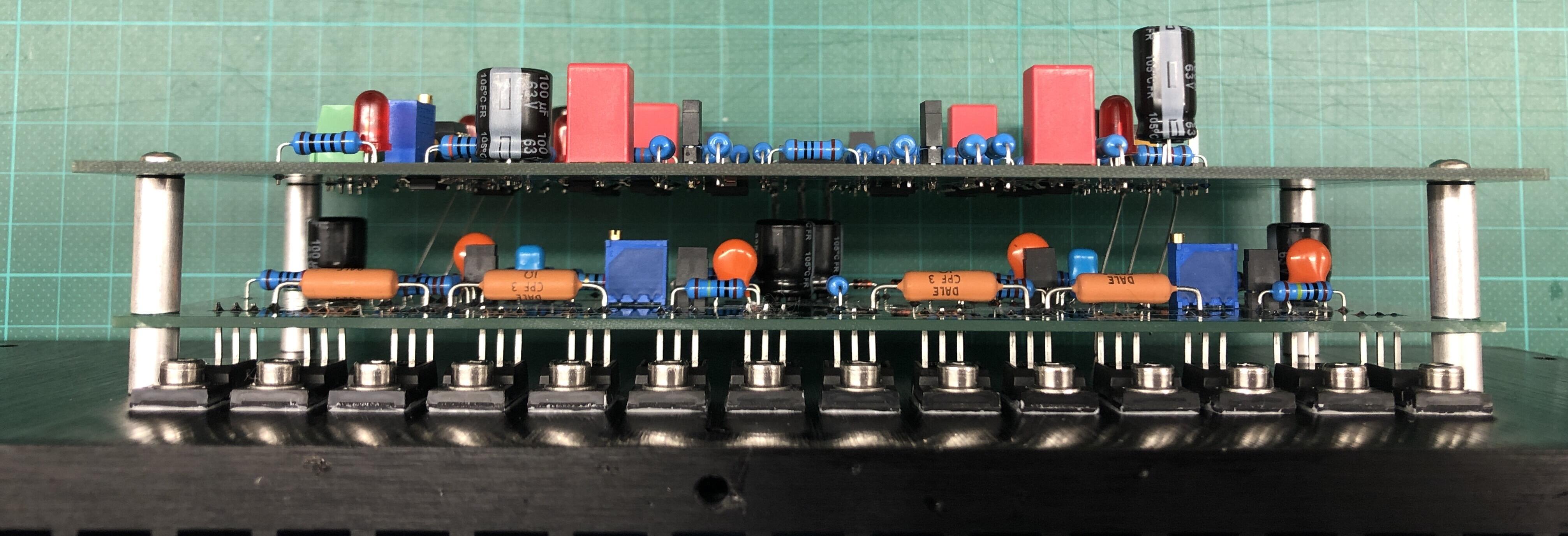

Uff... Mouser delivered today only 4 from 6 backordered C2M1000170D, so I guess my Carbon boards are going to wait more months before first power on. I even have the LSK389's stuffed in there.
Like magic 🙂 Nice pics and congrats, looking good!
