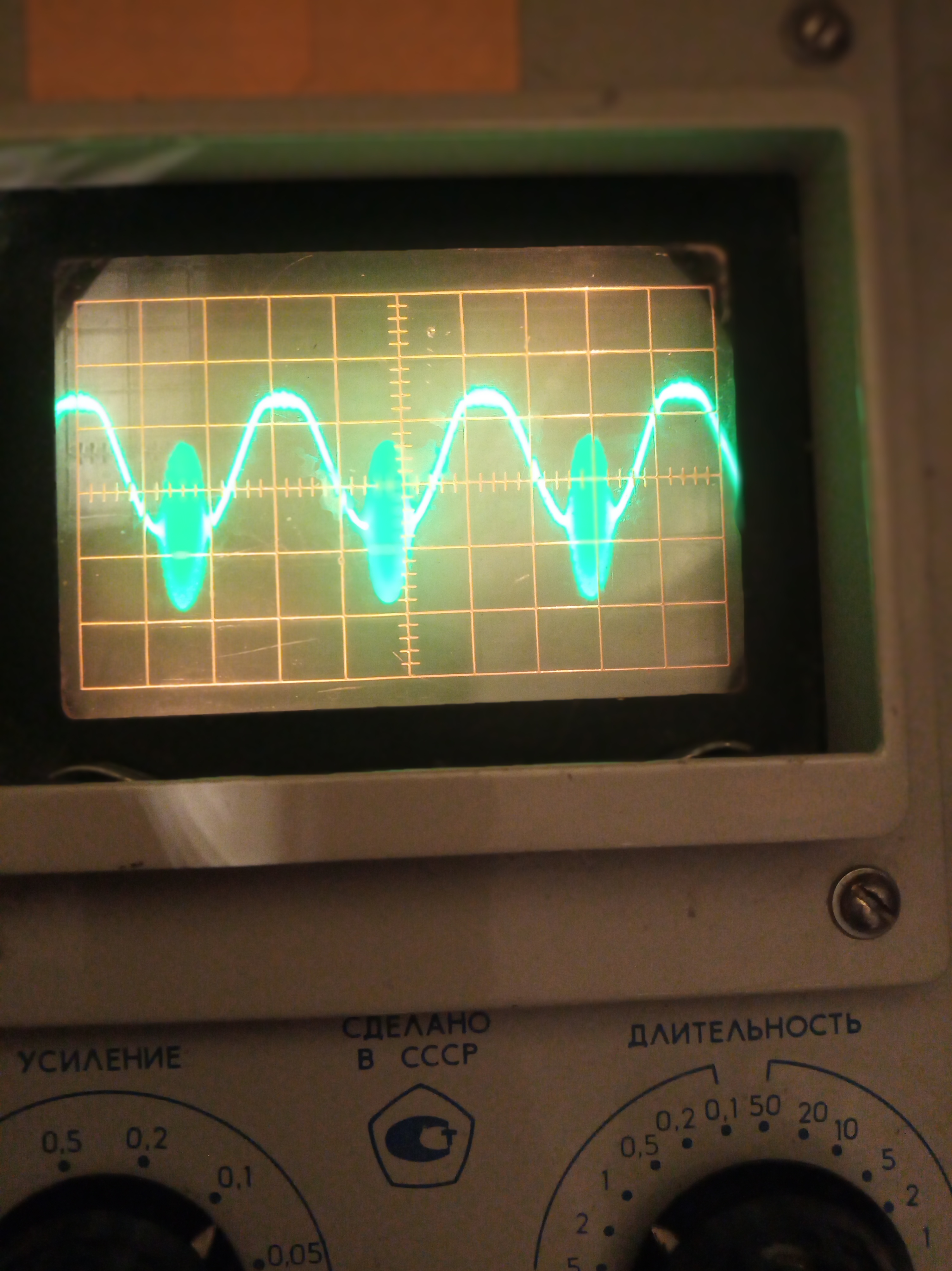

29 minutes ago, micon21 said:
Before connecting to the board, I set the necessary voltages on the stabilizers. When I turned on the board, all the high voltages dropped, +368, -408, 208. Since they dropped evenly, I believe that this is not the reason for the very small output swing.
the psu clearly has poor voltage regulation. The voltages have not all decreased by the same percentage but I don't think this is why you have almost no voltage amplification.
if you connect the test signal to the + input and ground the - input do you get a similar output on both out + and out -?
if you connect the test signal to the - input and ground the + input do you get a similar output on both out + and out -?
how are the + and - 15V dc rails under load? (the -15v also acts as the input 6922 anode current sink)
and what frequency is the oscillation when both + and - input are grounded?

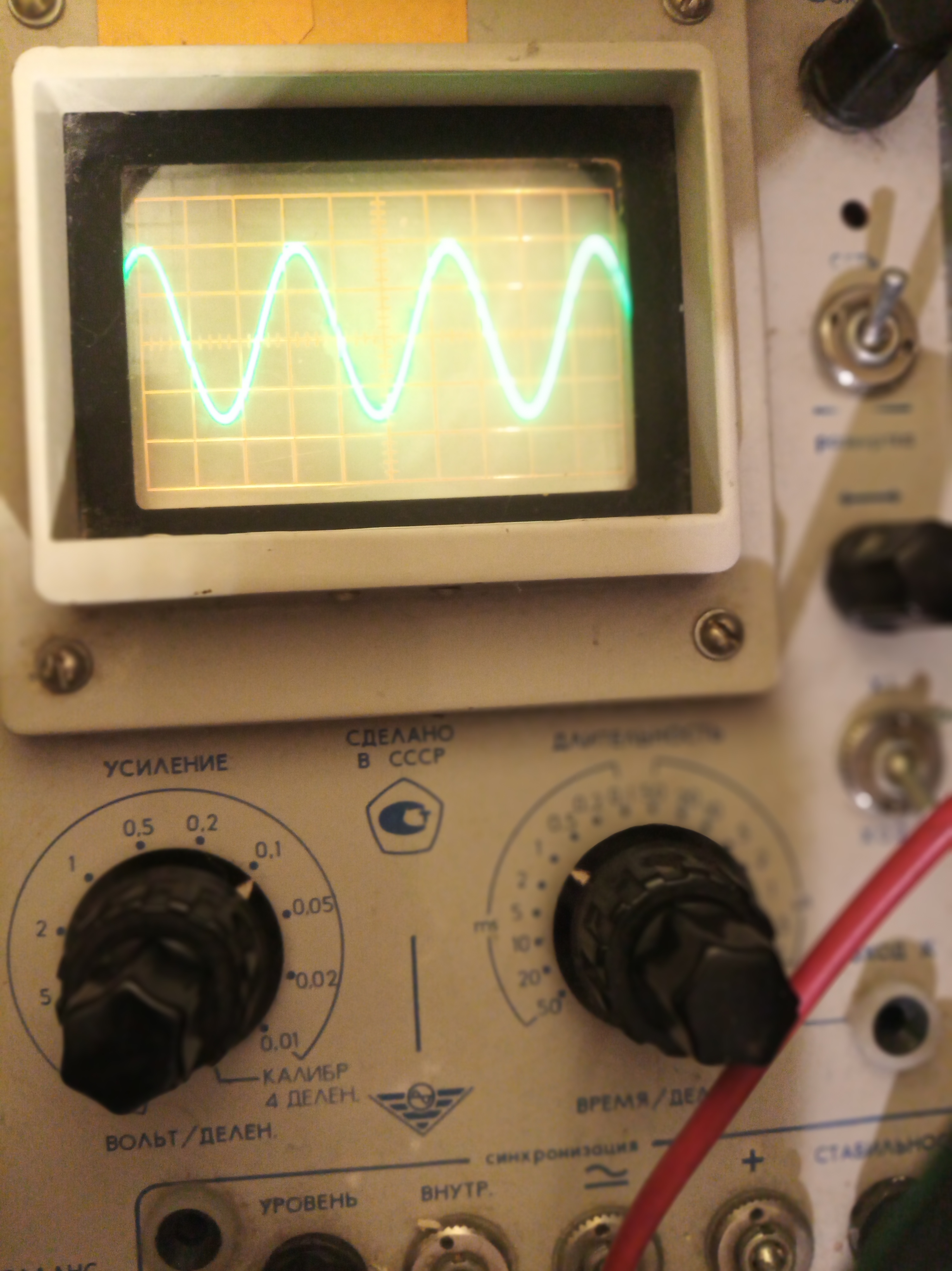

filed 220, 400, 460, but alas, the result is not happy.
!!! fed the input BALANCED  signal 0.35v, photo 1. the output received a swing of 82v  and  84v, but in terrible condition, photo 2
P.S. I get an undistorted signal with a swing of 20v at the output if I input 0.170v

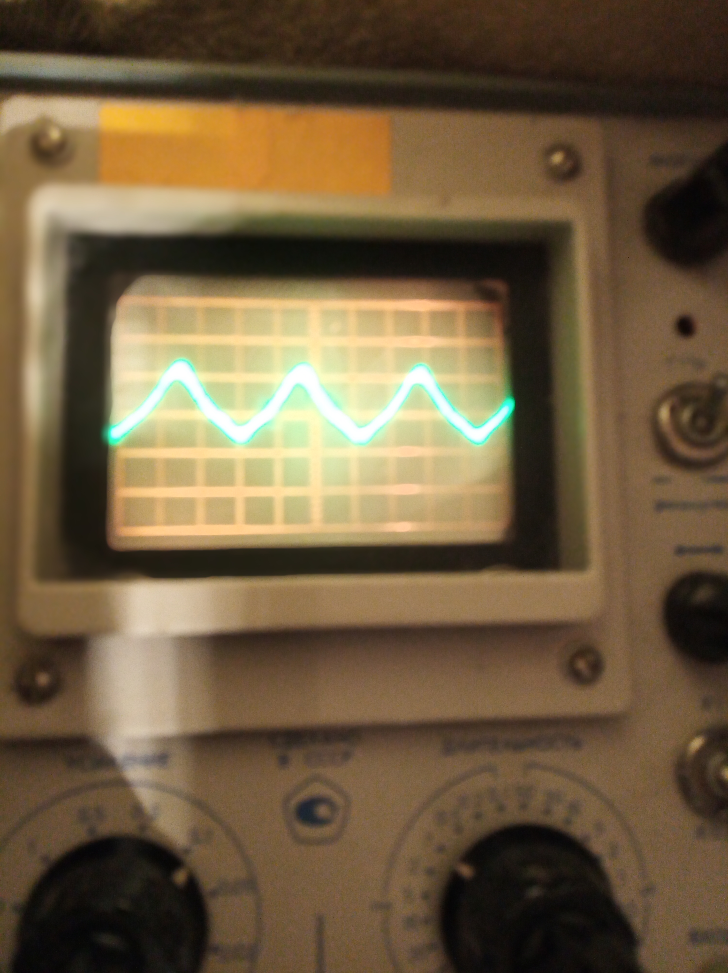

on the first leg of the first lamp, photo 1. on the third leg of photo 2
Tester measurements are as follows:
lamp one, 1 pin - 74v.
3pin - 2v
The second top lamp: 6pin-200v.  7pin- 61v
el34, 8 pin - minus 365v

I got a good undistorted sinusoid, with a large sweep of more than 110v at the output, with an input signal of 1.2v.
after adjusting the resistors R43, R44, R7, R8.
In the end I replaced 100k with 270k and 100 ohms with 2k.
now also on the third leg of the first lamp, I see a nice not crooked sine wave.
This change did not change the voltages on all legs of both 6922 lamps.

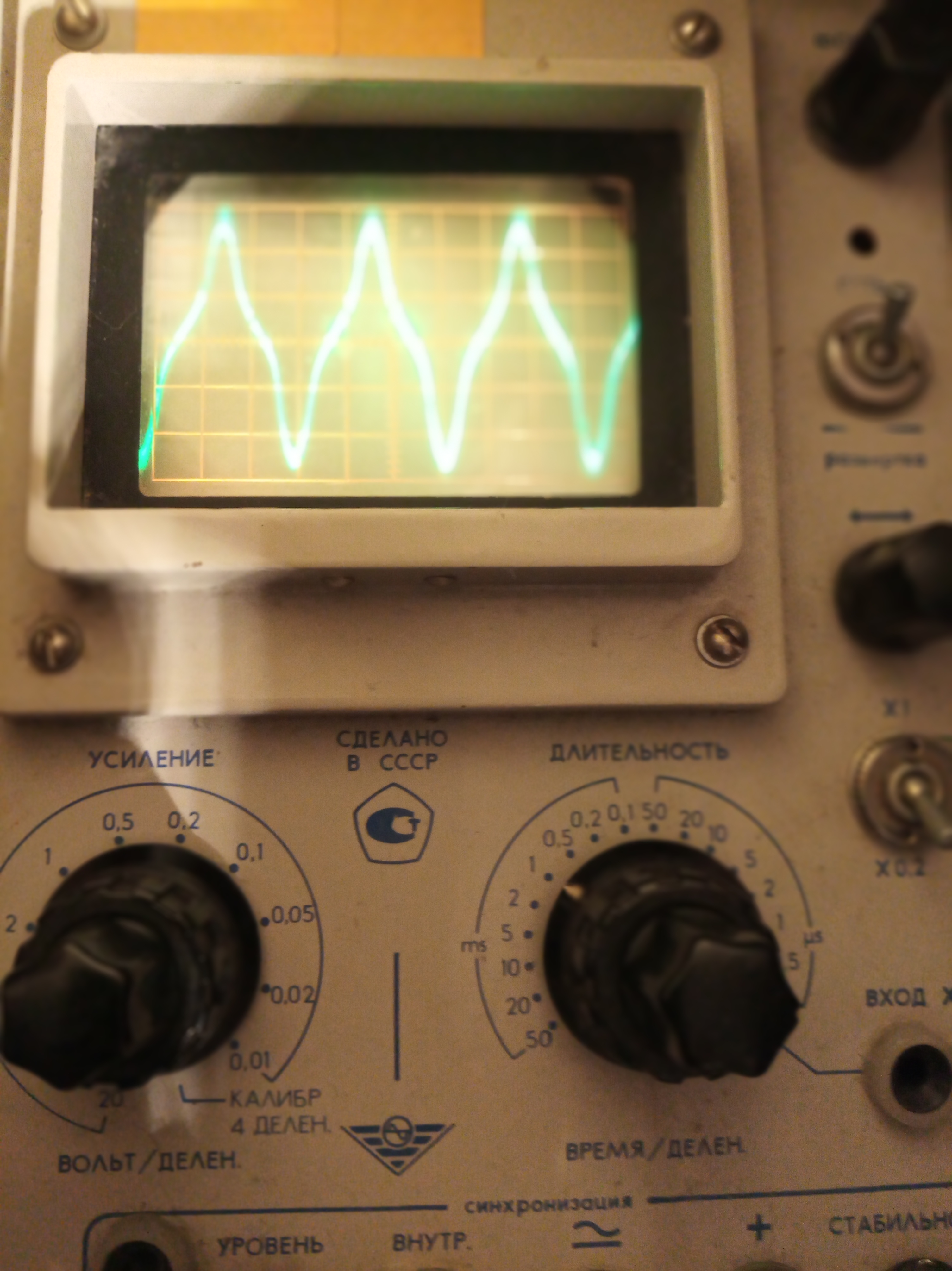

I checked everything yesterday, all resistors, transistors, no fault found, I put a different bulb, it didn't help, and was very upset.
i planned to throw the board away and be done with it. but i accidentally discovered that increasing 100k leads to an increase in signal. The result is much more interesting than it was. the sinusoid is beautiful, not crooked. in the evening I will plug in my headphones and listen to how it plays....

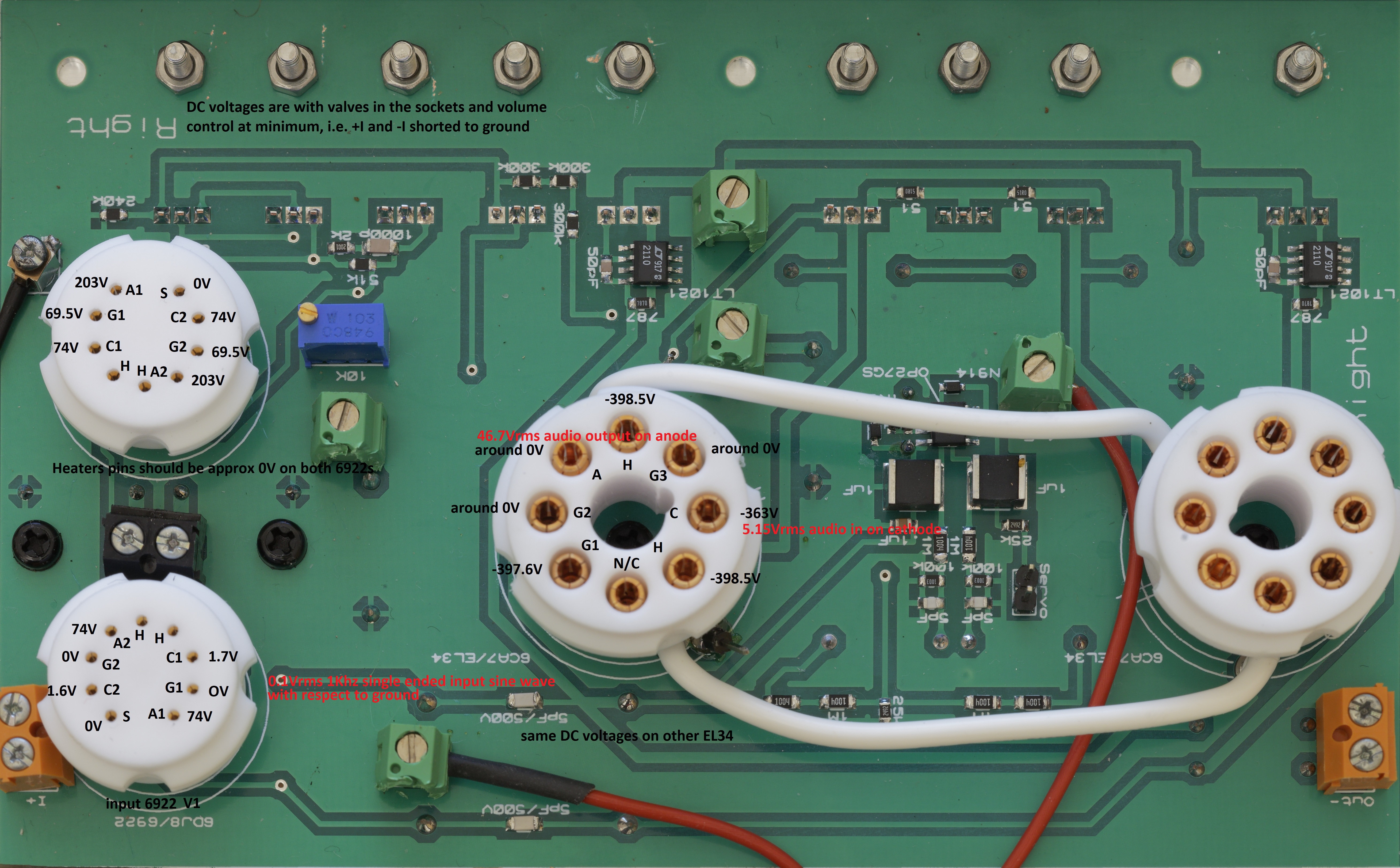

To help people with troubleshooting here are the valve DC operating points measured with respect to ground on a known good stock mini T2. Inputs are shorted to ground. No load on output. All components stock values and DC PSU voltage rails within 1% of schematic when under load. Obviously the two el34s should have identical DC operating points and so should each half of a 6922, the other channel should also match. Exact measured values are going to vary a bit depending upon the valves, exact PSU voltages component, tolerances etc etc.
NOTE the EL34 heaters sit at approximately -400VDC. The 6922 heaters are approximately at 0VDC
I get a signal gain of approximately 940x with a single ended 1Khz sine wave 0.1Vrms input and an output of 94Vrms between the + and - output pins into a 10Mohm (multimeter) load.
Audio enters the EL34s on the cathode and for 0.1Vrms 1khz input I get approximately 5.17Vrms of audio on the cathode, the EL34 amplifies this by about 9 times and gives 46.7Vrms on the anode with respect to ground. The other EL34 operates similarly but opposite phase.
