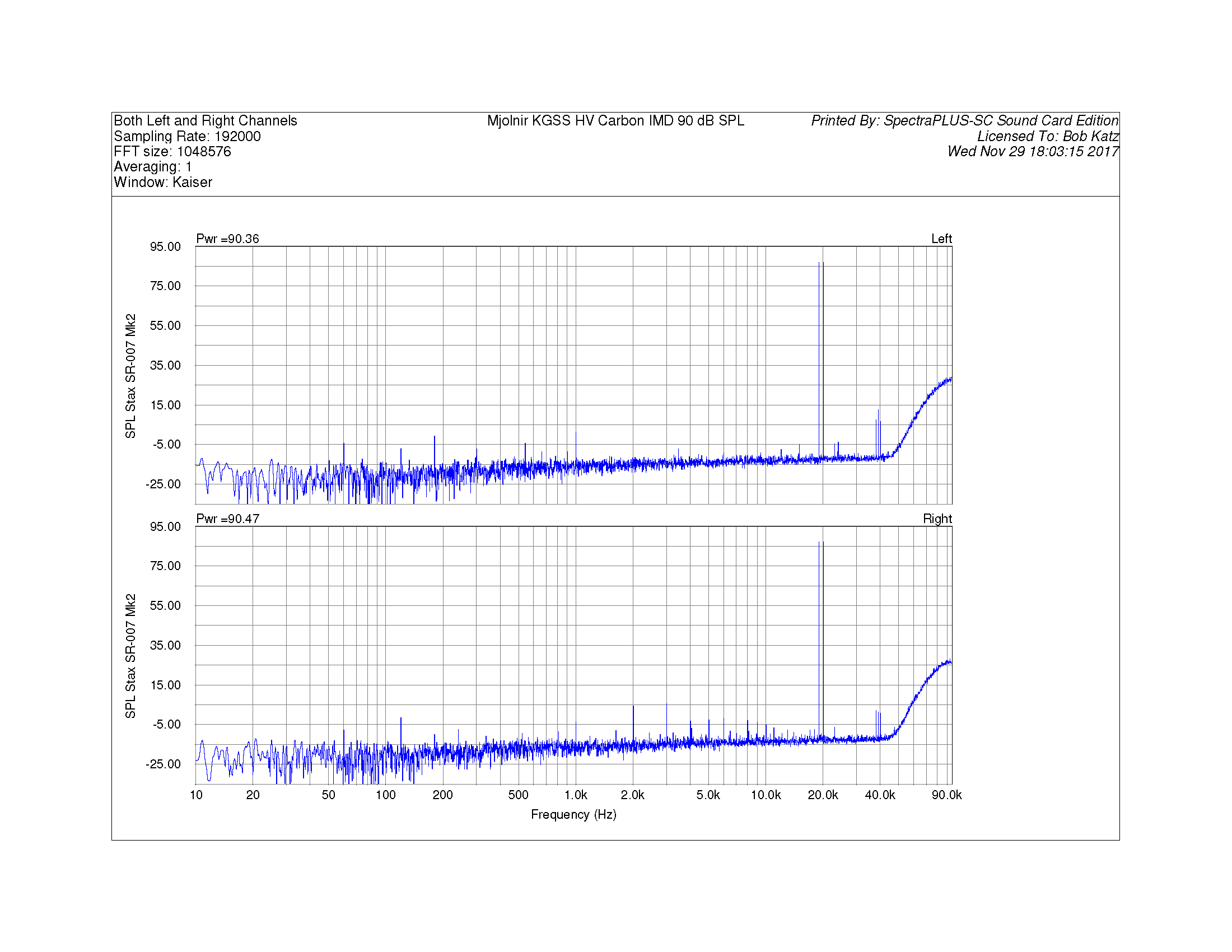

To see where the skeletons are buried in this amp, take a look at my measurements. The measurements to really study is a comparison of the Mjolnir KGSS HV Carbon and the Topping at nominally 90 dB equivalent SPL of IMD 19-20 kHz 1:1 ratio. I think that lurking in that measurement is at least one of the reasons why the Topping sounds so harsh and the Mjolnir sounds so pure. The primary difference tone at 1 kHz in the spectrum does not tell the story. Notice the high frequency side bands near the 19-20 kHz that begin to reveal to us the Topping's nonlinearities. There's more in the attachments. I'm sorry that I didn't do the multitone, I will some day, when I get around to it, and I'm sure it will reveal the skeleton underneath the "golden glow" of this amp.
 Hi Bob,
Thanks for the great effort and information! I just do not see the graphs for the KGSSHV Carbon measurements. Perhaps the image upload did not work for that graph?

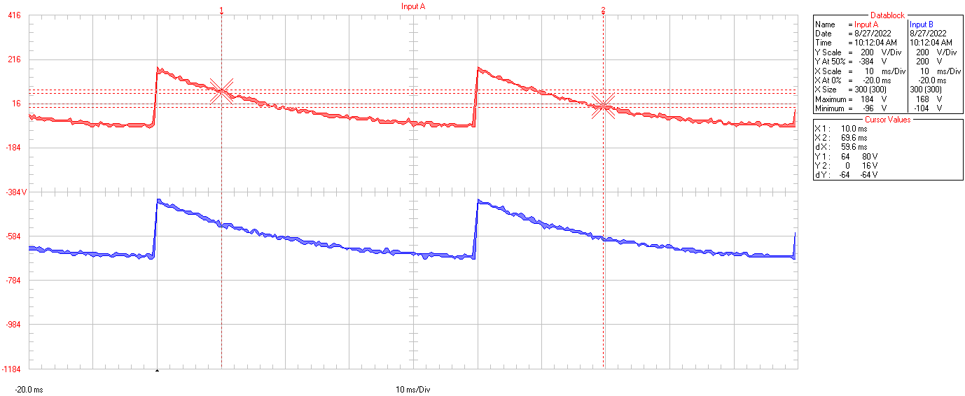

  • Jest before I stopped playing with it last night I took some measurements, I fed it a 10kHz squarewave, 1Vpp from a function gen and while it was a pain to get a good ground in there, we are not deali
My pleasure! Just uploaded the Mjolnir measurement. Put the Mjolnir and Topping pictures side by side!

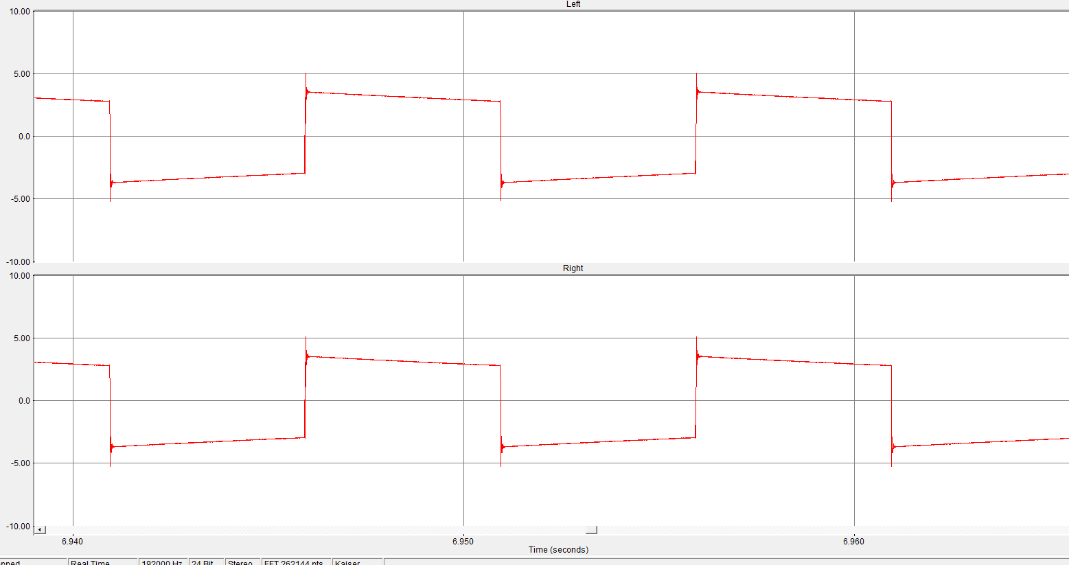

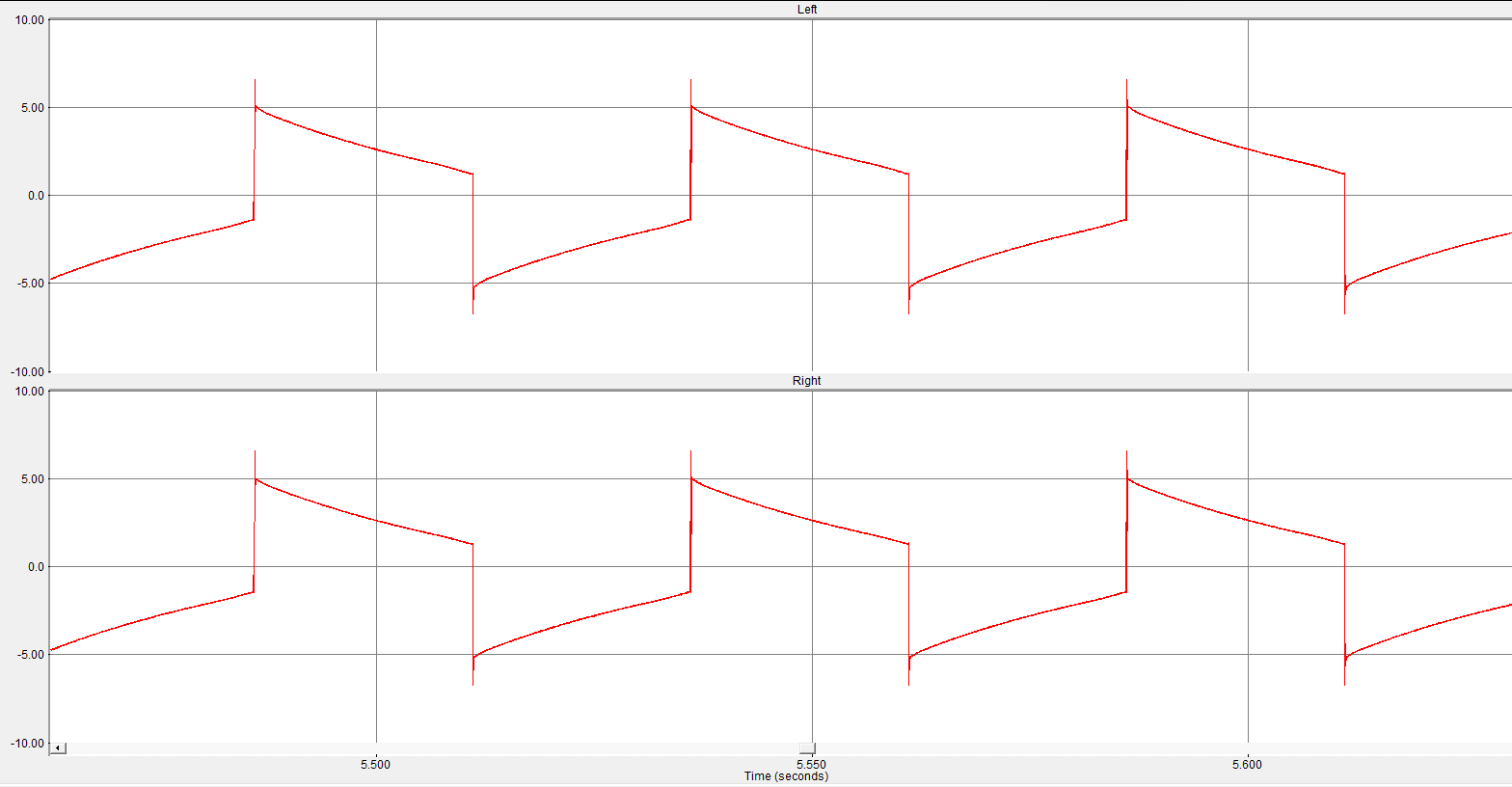

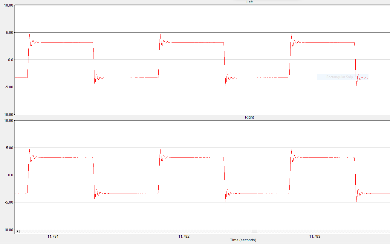

I'm sorry that the BBS interface does not show the names of the files. The unlabeled ones are square waves at 1 kHz, 10 kHz, 20 Hz, 100 Hz. Next time I upload I'll annotate all files in the GUI 🙂
Another test picture shown is a polarity test signal. The amp is non-inverting, based on pin 2 going positive to +-marked pin on the Stax connector. I guess that's something. Although, as you would find from my measurements of Stax and CRBN headphones using a cheapo Mini-DSP Ears, cross checked wih a calibrated measurement microphone --- these headphones invert absolute polarity! But you know what, and here's my theory: Those who say they can hear a difference when absolute polarity is reversed made their judgments listening to moving coil loudspeakers --- not electrostatic headphones. A moving coil has an inherent linearity difference between out-going and in-coming due to differences in the spring/cushion of the coil and spider returning to the zero point. And also consider that magnets themselves are very non-linear in their pull at different distances. Not so with capacitive. And an electrostatic diaphragm in push-pull from the stators is  bilaterally-symmetrical, so there should be no distortion or strength of difference between push and pull. Personally I have never heard an audible difference between inverting and non-inverting signals with E-stats.

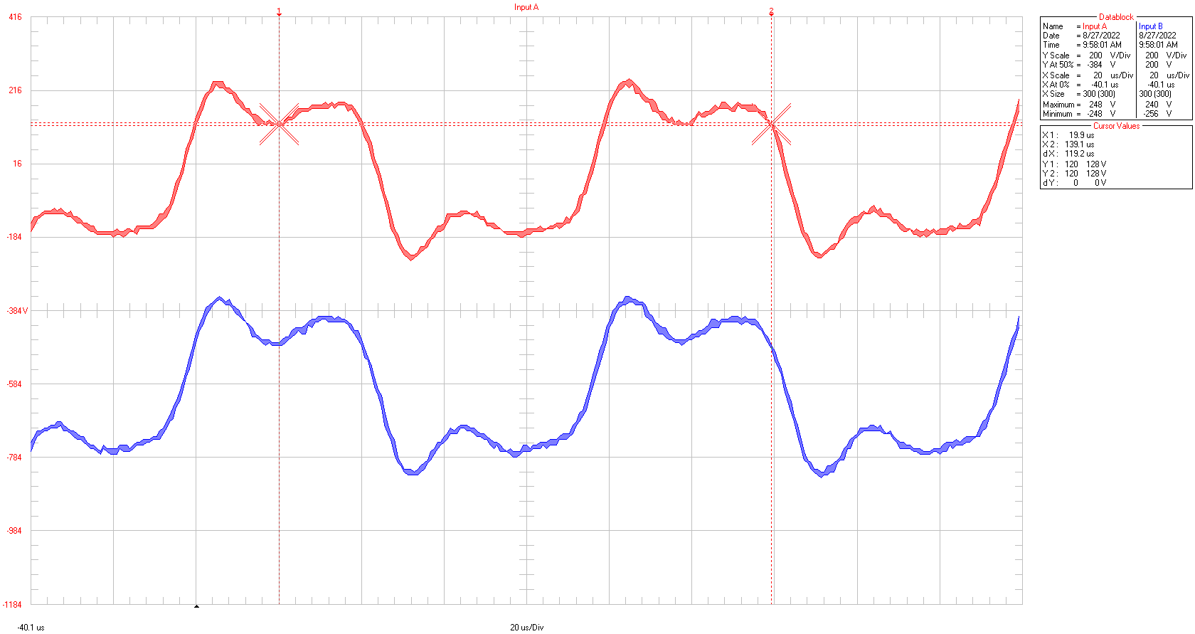

first 2 are 1khz into 50 ohm non-inductive load. notice that the rise time and fall time are not identical. also notice severe slew rate limiting in both directions and kink on the positive slope.
3rd picture is 10khz.
kind of what you would expect from an amplifier with an open loop gain of around 120db and a group delay of 10us or more.
i don't have the transformers, but i'll bet it looks even worse driving that transformer.
pretty sure the a90d will perform exactly the same.
edit: see pictures in next post.  definitely same as a90d

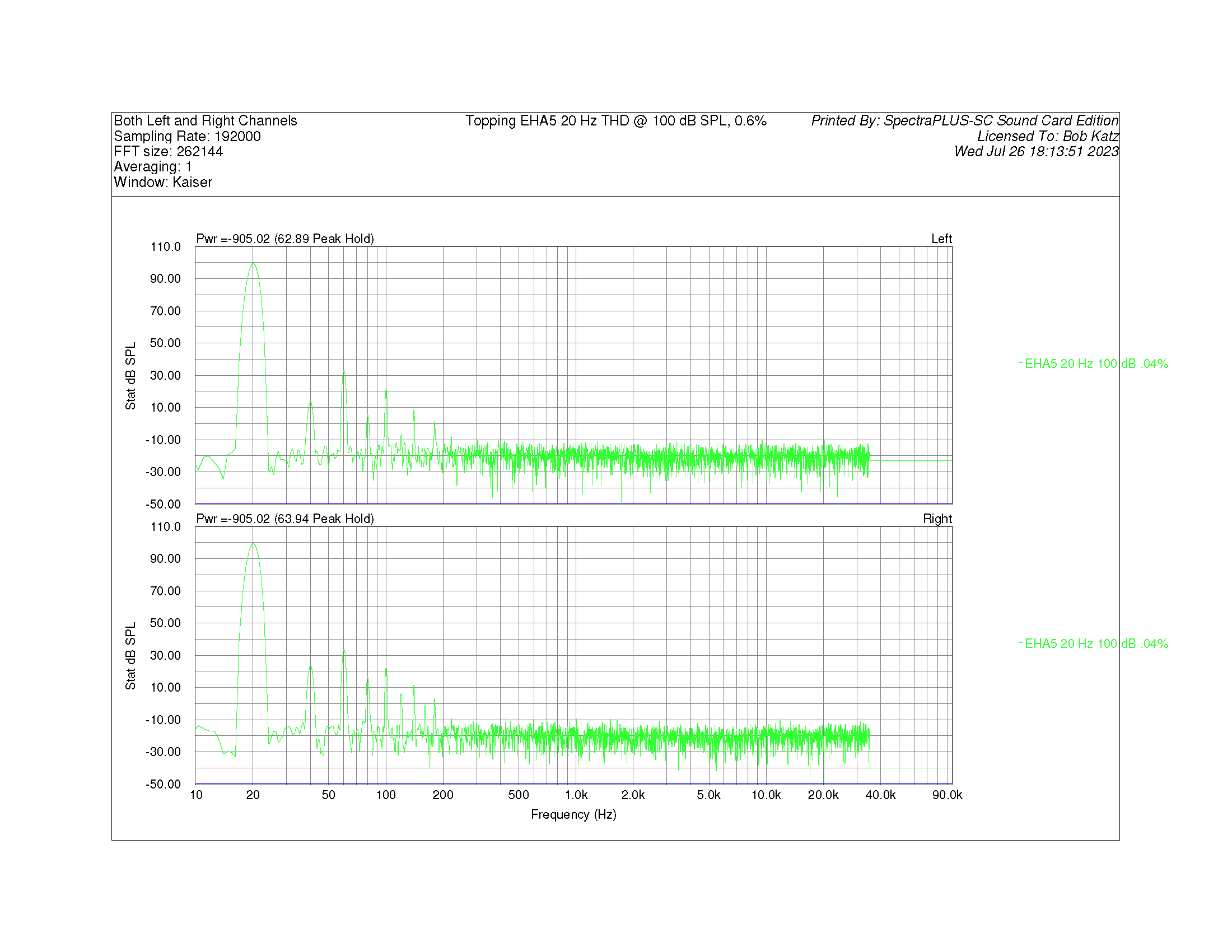

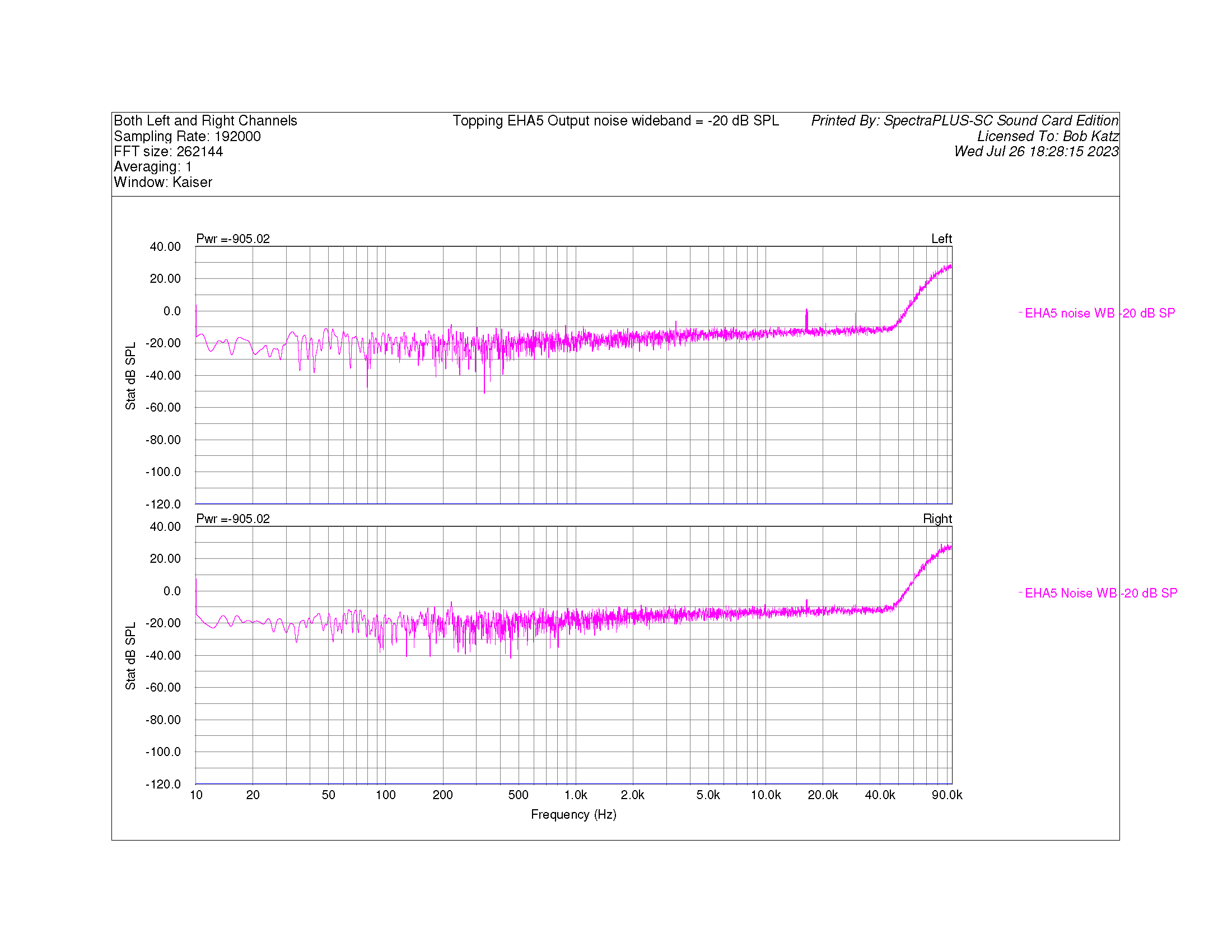

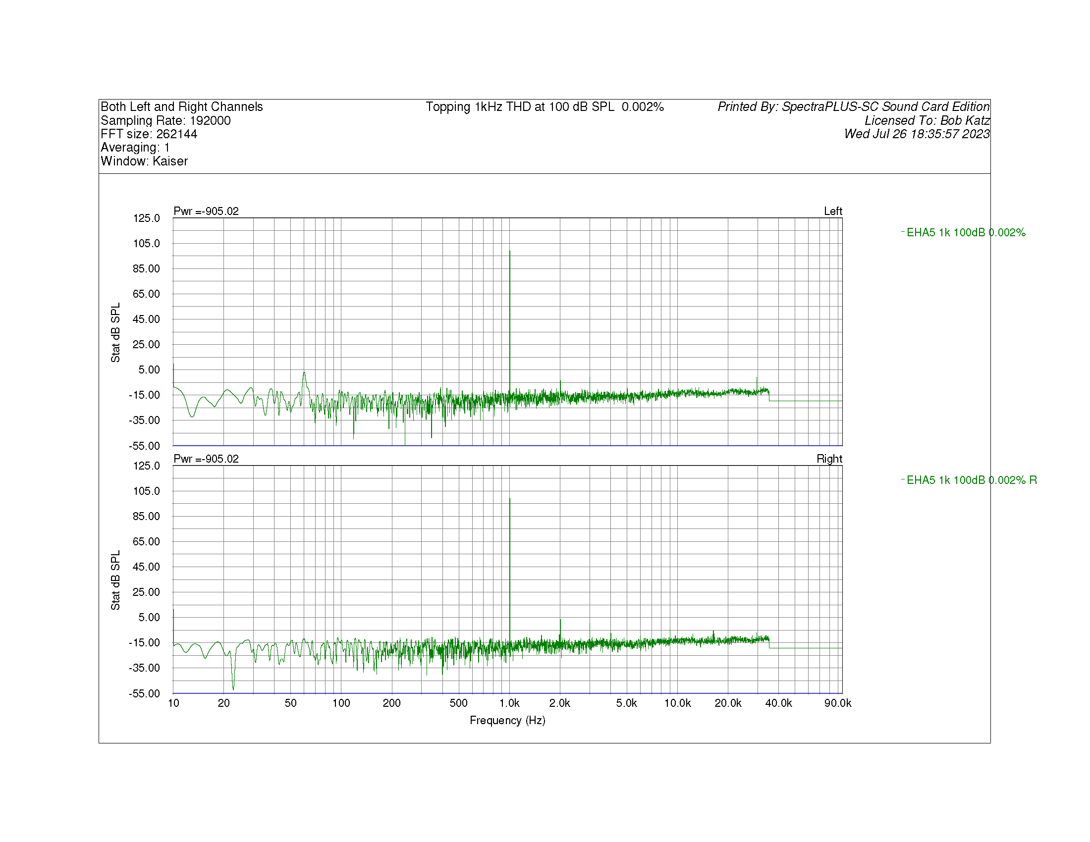

What a disappointment this amp turned out to be. My disappointment came in stages. The first stage was an optimistic listen: "Hey, not too bad". At that time I was listening to some simple classical and folk arrangements: with solo voices and guitar, the weaknesses of the Topping circuit are not immediately obvious. But as soon as I played more complex music, full orchestra, rock band, you name it. Where it starts to get real harsh, bloated, lose dimension is with complex music, full orchestra, rock band, you name it. The more I listened, the more I started to hate this amp.

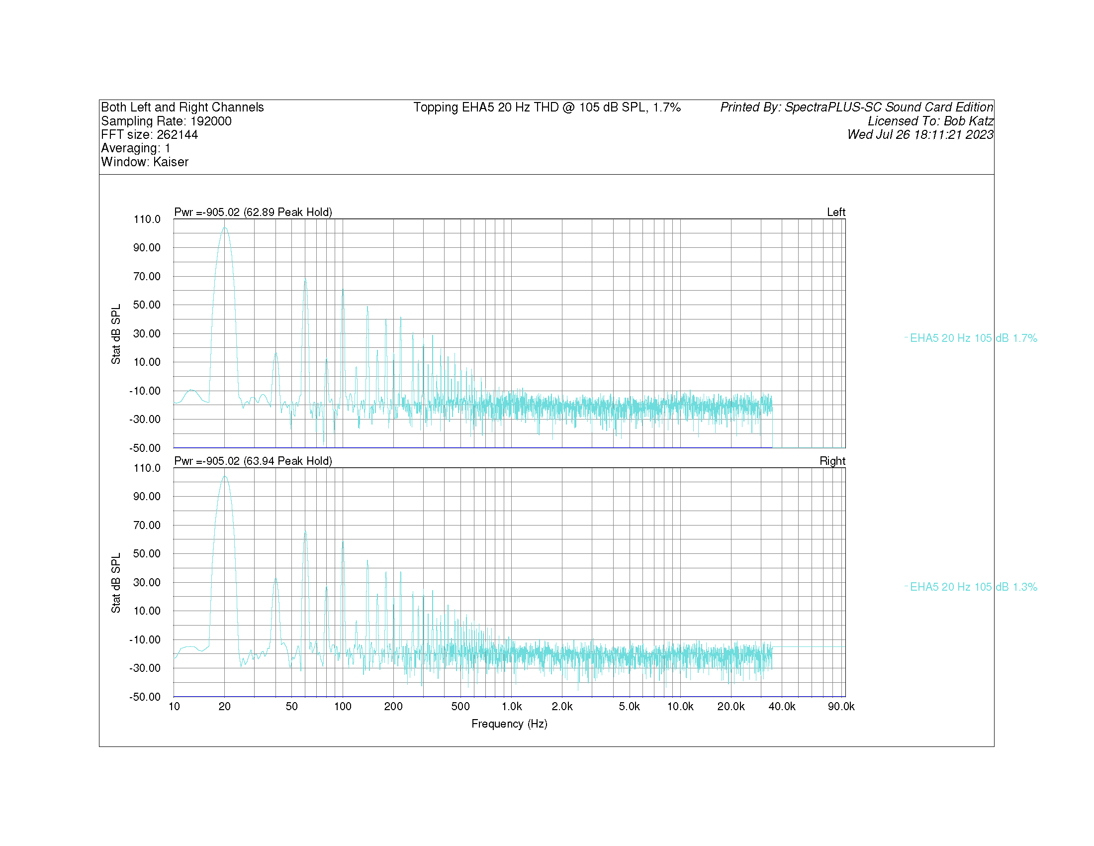

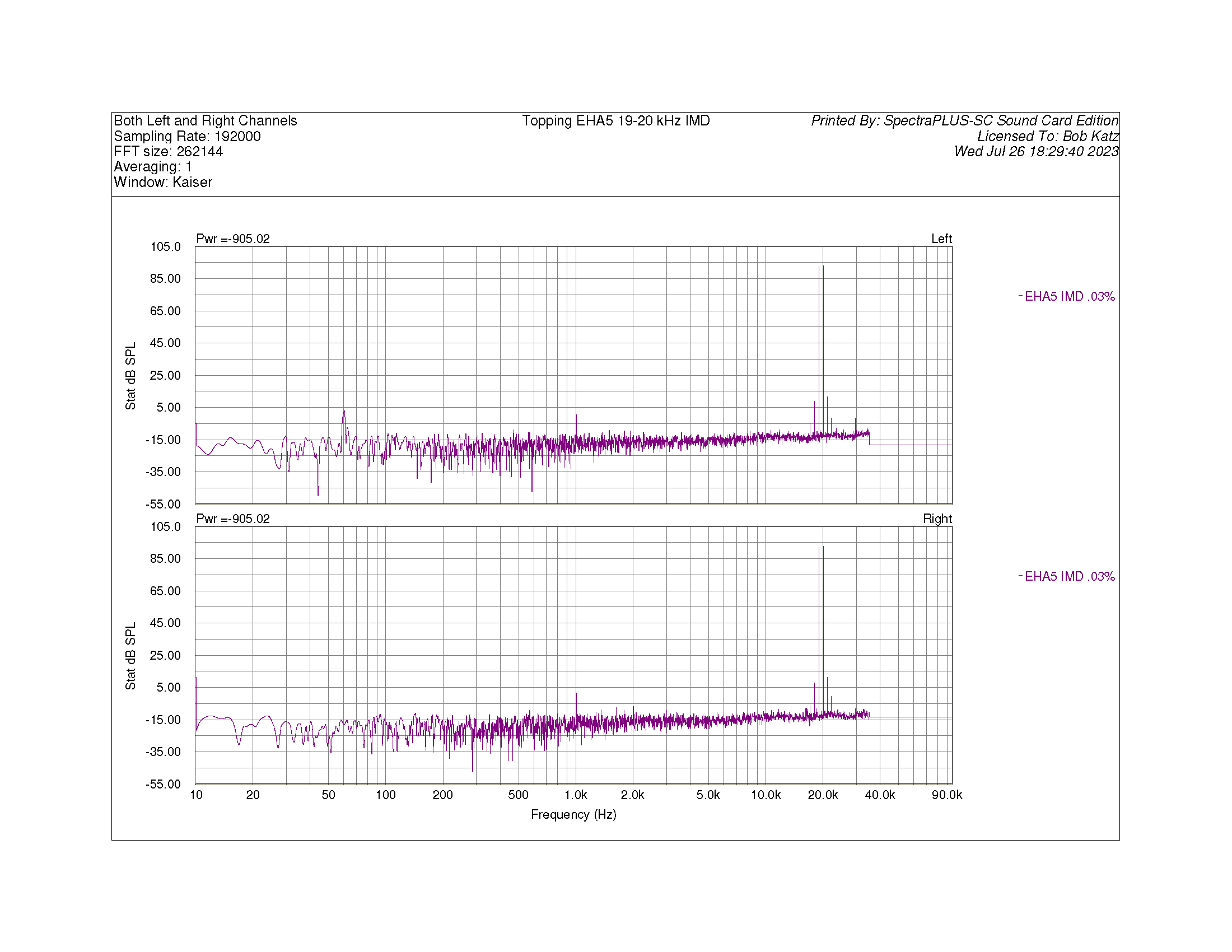

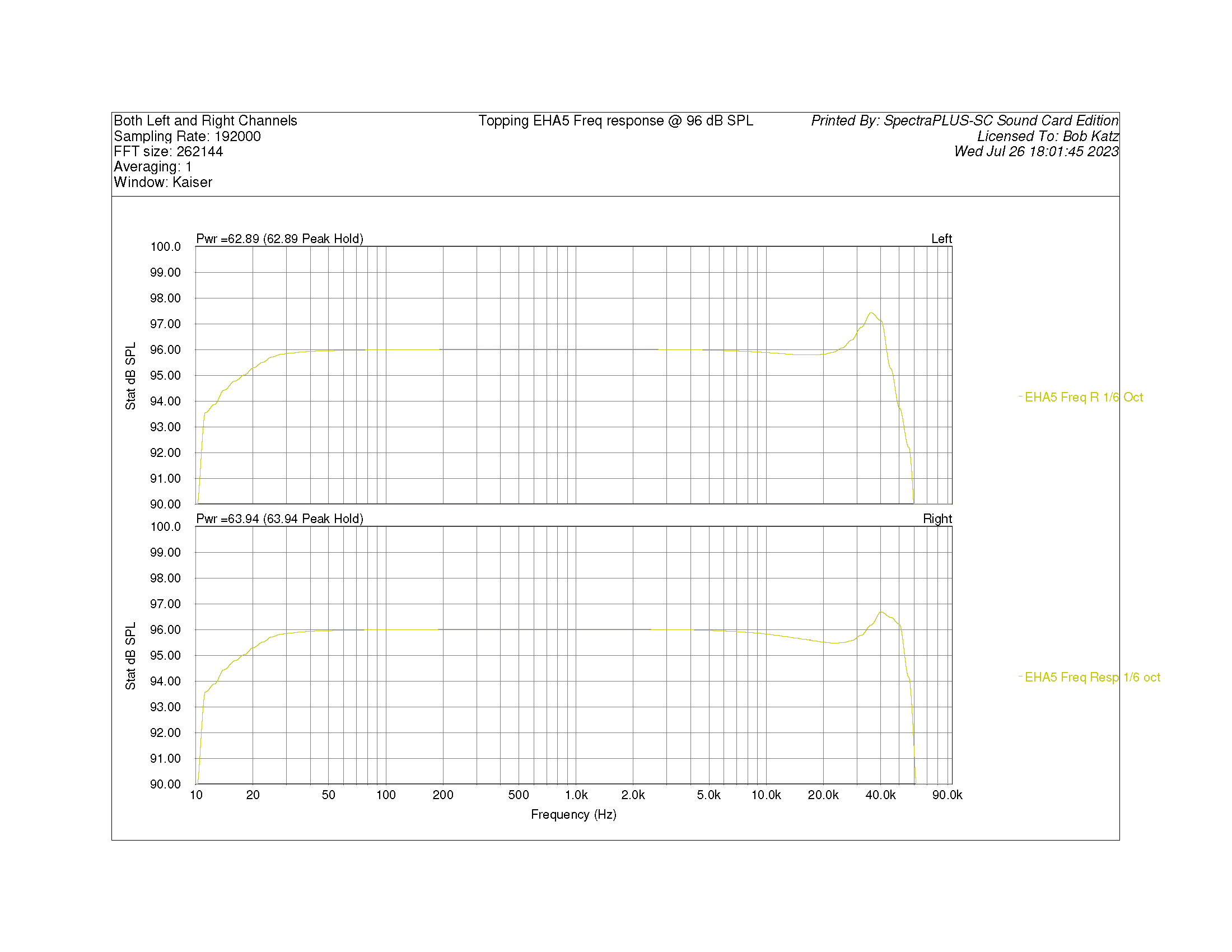

I WILL BET THAT THERE ARE MEASUREMENTS THAT WILL REVEAL THIS AMP'S WEAKNESSES. You just have to know how to find out where the bodies are buried. I did find some that clearly show its weaknesses. Attached below. Frequency response (with a 100 pf load), Output level just before clipping, THD at various frequencies at normal levels and just before clipping (spectrum and %), IMD (19-20 kHz) (spectrum and %). The one thing I should have measured is a special multitone signal I use, I bet that would show where the bodies are buried, and tell us why the amp falls totally flat the more complex the music you put into it. But I'm so disenheartened and disappointed by the sound of it that I don't have the energy to bring it back to the test bench.

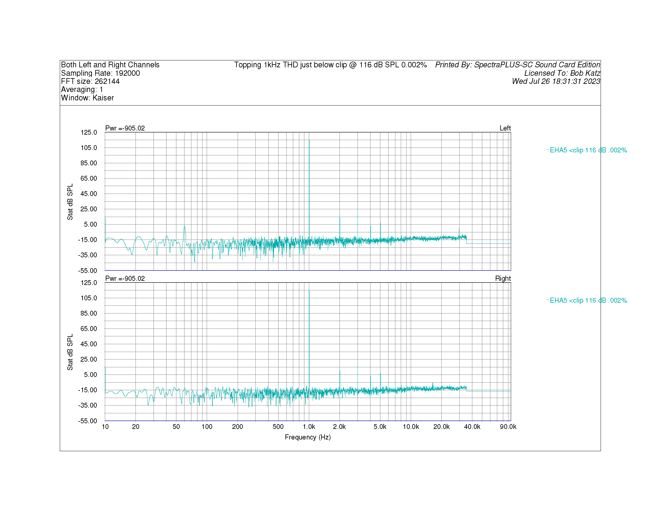

I like to display an amplifier's measurements in equivalent SPL, based on Stax 007 and CRBN nominal sensitivity of 100 volts RMS = nominally 100 dB SPL. It helps bring a real-world perspective to amplifier measurements.
Topping Factory spec for max is 700 volts RMS (I suppose the factory took this a cat's hair below clipping and only at 1 kHz). I measured maximum output at 1 dB below clipping at 630 volts RMS at 1 kHz, equivalent to 116 dB SPL. But When performing the 20 Hz THD test, the amp's DC protection circuit kicked in and the most I could get out of it at 20 Hz with a continuous sine wave was the equivalent of 105 dB SPL, 177 volts RMS before the amp shut down. So the lower the frequency, the worst the amp's headroom for transients. Plus, the THD at low frequencies is pretty bad, the transformer saturates very strongly.

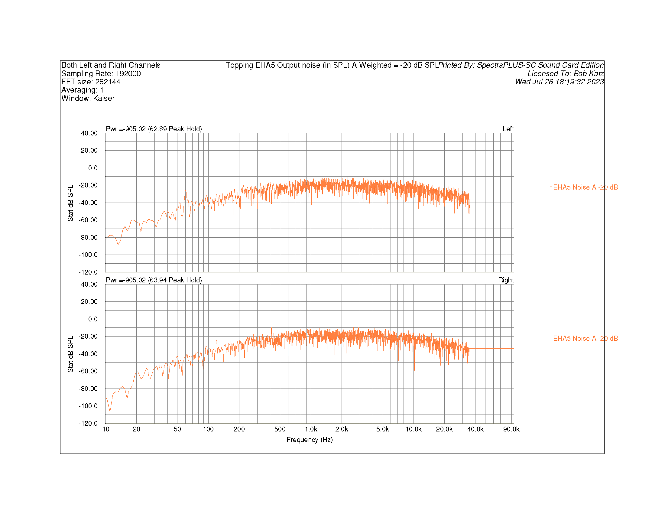

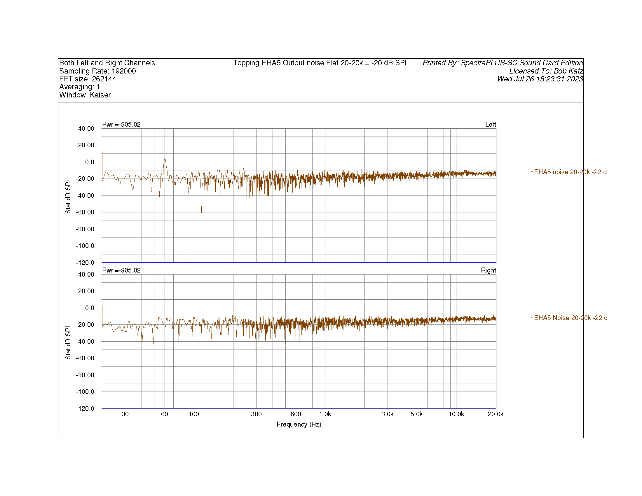

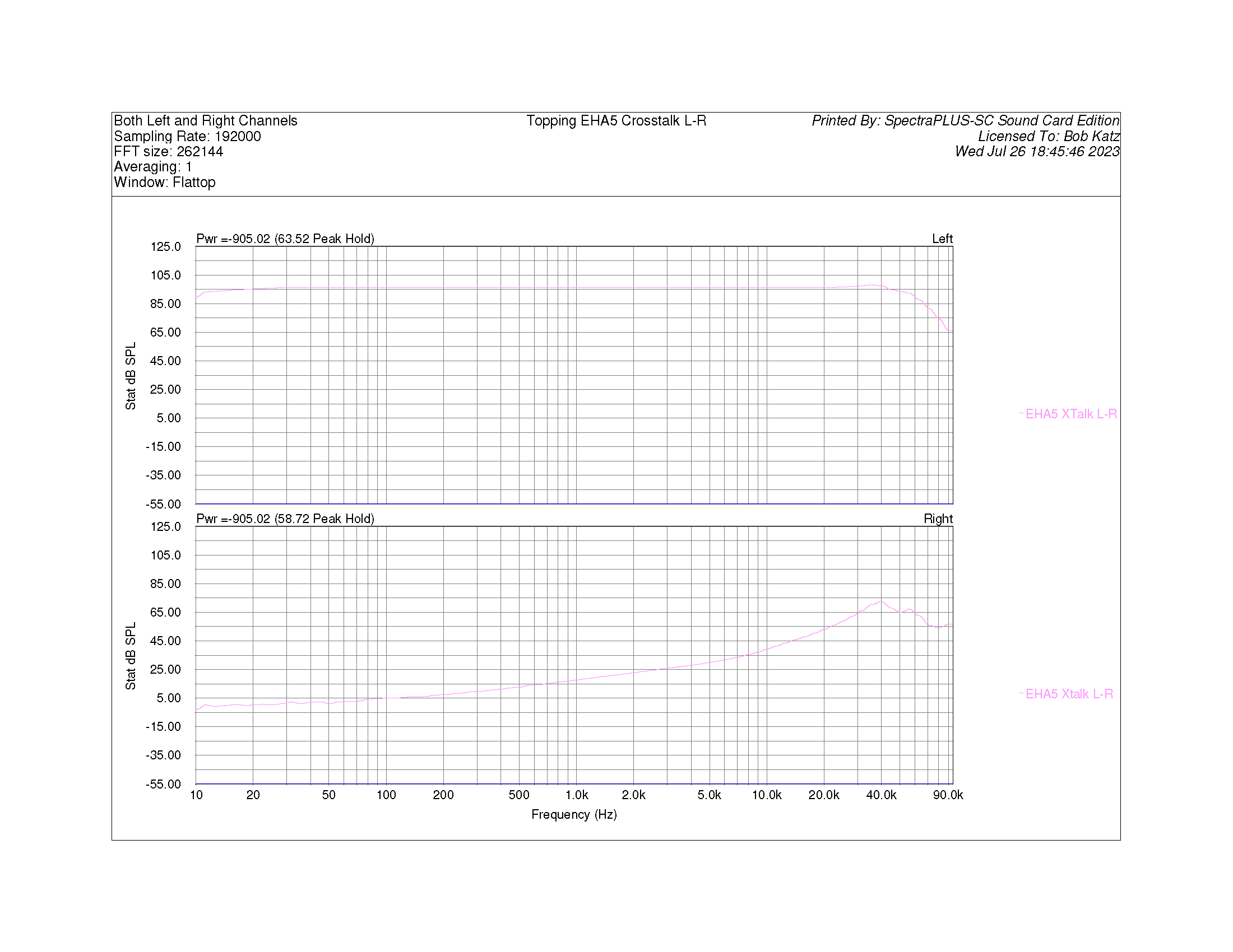

The date in the Fluke scope pictures is wrong... it's actually yesterday, 7/28/23. I have to fix the date in my Fluke Scope. Every time the battery dies, it loses the date 😞
Post the equivalent measurements of the Carbon for comparison please.
So a person accused me of faking my scope picture, because it had to be my signal generator. And that the amp performed better at the higher gain setting.  I completely disagree.
Q15 has no emitter resistor and the resulting gain of just this transistor is 30db. which makes the miller capacitance absolutely huge.
which is why you see two different slew rates. the first bit is due to the output amp (everything left of r12 which is a diamond buffer driving a pair of current mirrors driving another diamond buffer). The second bit is due to Q15.
I think I did put up a Carbon measurement in this thread. If it's not here I'll have to dig up the measurements and show you all.
