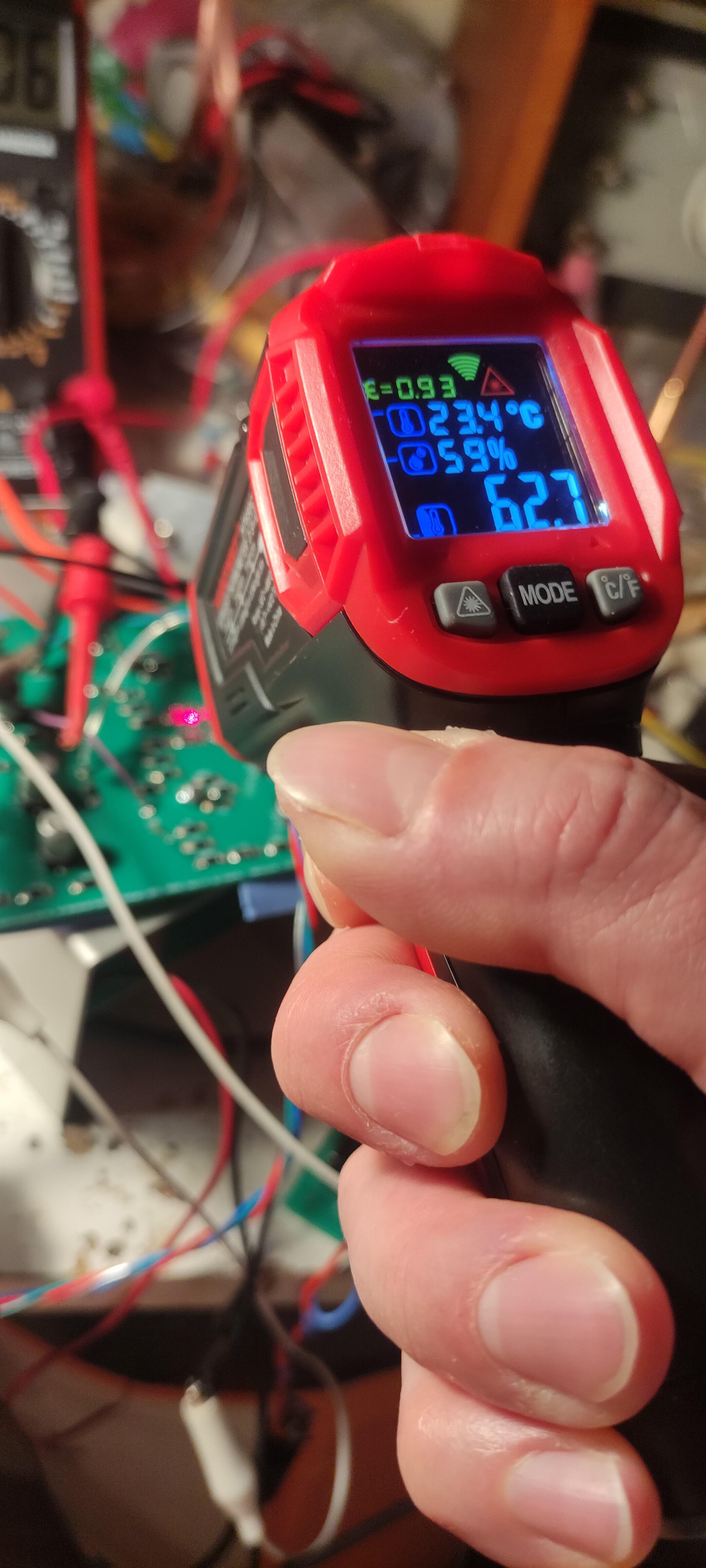

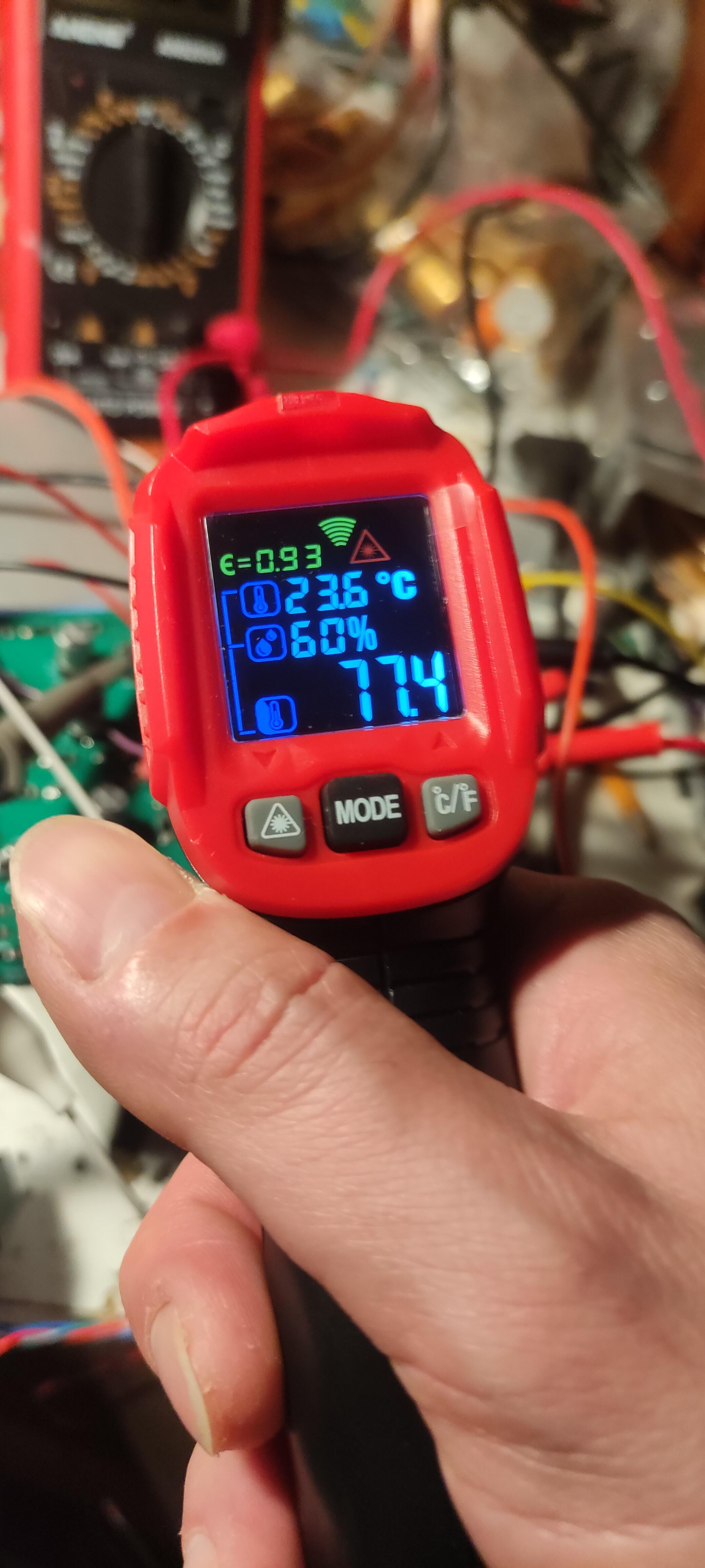

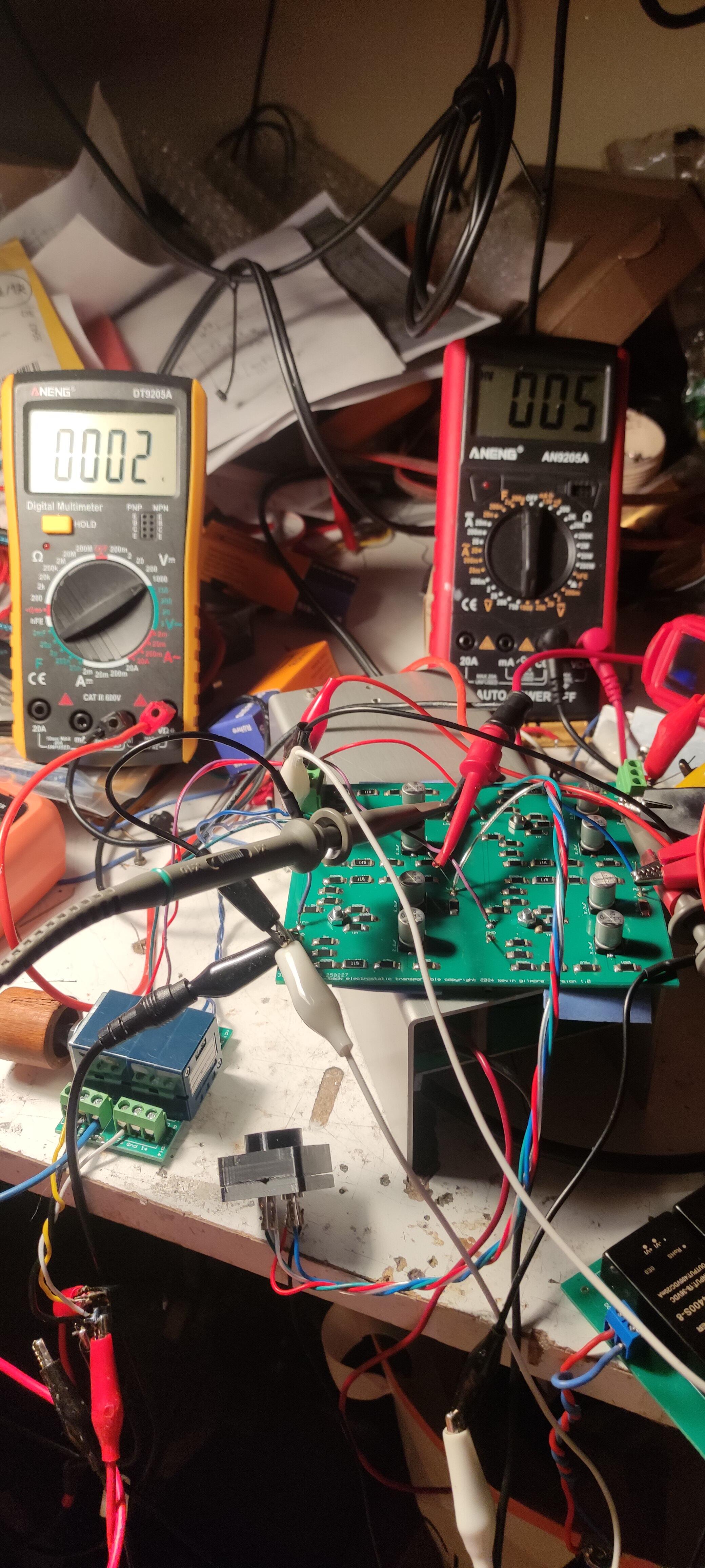

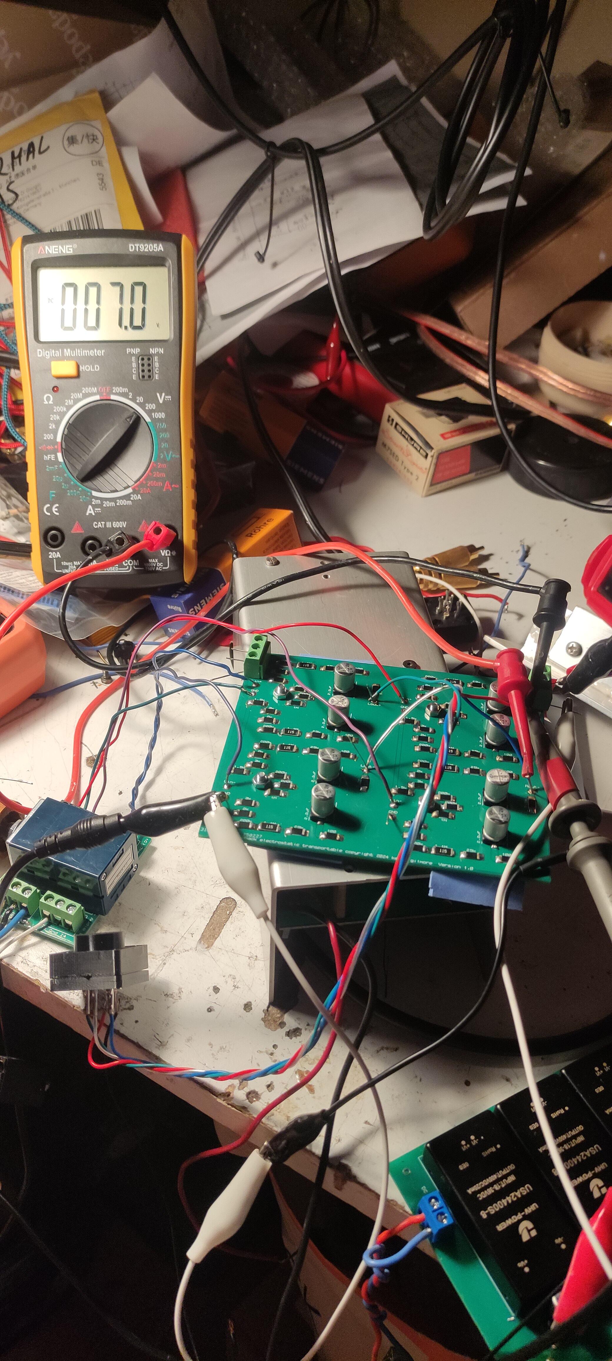

Michelag Posted October 18 Report Posted October 18 Tried a test build, with silicone thermal sheet, alu plate on some alu piece. Yes, there's thermal runaway. Power consumption begins at 24V/0.8A and slowly takes up to almost 2A, when the board reached 80°C I shut it down. The 400V B+ rail (so the B-) started around 9mA, up to 20mA before shutdown. Offset was around 2V on one channel, 5V on the other one. Amp was in idle condition. @kevin gilmoreDr., you were saying putting a 12V sender in series to 1.1Meg resistor, newbie question, with what polarity? What about trimming the bias ? Do you foresee adding a trimpot in the next release? Thanks, hope it helps other fellow builders.
psyduck Posted October 18 Report Posted October 18 Unfortunately the resistors drift with temperature as I've tried building it before. I'd recommend adding a fan to cool the top side.

psyduck Posted October 19 Report Posted October 19 When adjusting the trimmers, make sure they're balanced to minimize DC offset between outputs, recommend having another DMM for that. To measure the current, you need to measure the voltage between the 100R resistors and divide the voltage by 100. The total current for one side is the sum of all 4 of them.
kevin gilmore Posted October 19 Author Report Posted October 19 never expected thermal runaway because birgir has been selling the much higher power version and its completely stable. those particular resistors due to the heat really drift. like 10%. and in the wrong direction. with the resistors replaced by current sources its stable. so much easier to make really higher power things.
