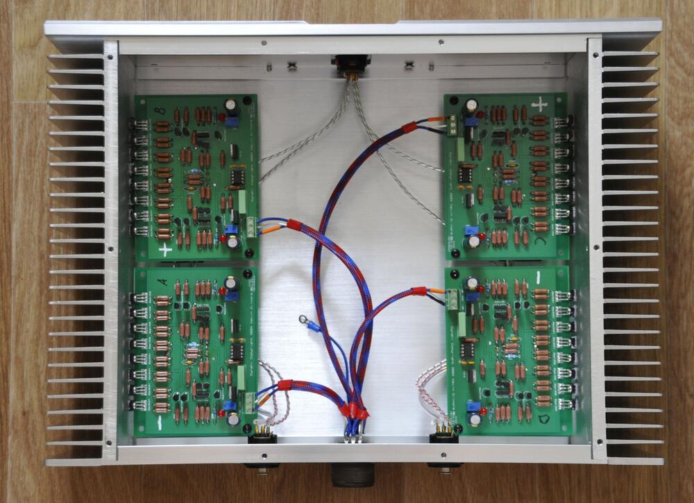

  1. Hello all Build CFA3 version 1.22 near to be finished. Will try to use GaN transistors PSU for it. With greate helps from other members cleared that trimports: RV1 for offset, RV2/RV3 for bias (equal to 0R for testing). Only ZF mode, +- 30V PSU. All good but it is something wrong in build, very high power consumprion: 10W preamp board and about 100W amp for one channel. Tested: all leds LTL-4221NLC resolded and tested MJF15030/MJF15031 - all good all resistors, that340, pzta06/pzta56, 1n914 - all good no soldering joints Seems like jeneral problem which met bdinnev, Satyrnine and others. I am worry to run too long time with such high power consumption, so only 3-5 secs and power down. Both channels with same problem. All leds on preamp boards are on. So what else could be tested, how you think? May be change gain R50/R51=1900 on something else? And is it possible to check preamp and amp boards separately?

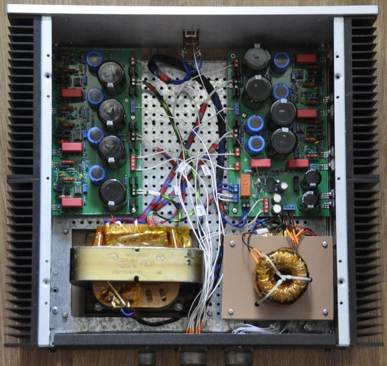

  7. Repairs. Of cause it was some problems (for T2 this is normal, nothing special). It was successful first run. But after some modifications I had bad connection for tubes filaments 6.3V. * so fried couple times 2SK216 + went to rip 4-6pcs LTL-4221NLC. Silent dead, no sparks. * PSU lines -500V, +500V (not alone here, other members had same problems): zener 24V, 2n3904, fqpf8n80c. Thanks all who helped in repairs.

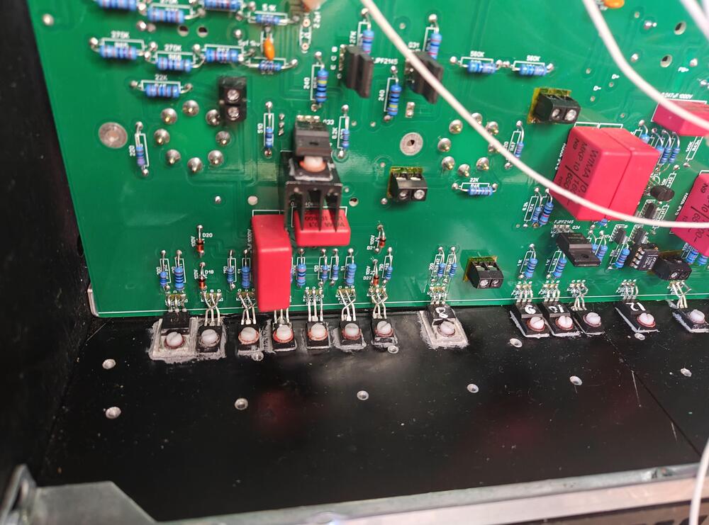

  8. Hello everybody! Almost finished T2 started in 2022. It was very funny and pleasant build, very interesting. For base I took PCB developed by jamesmking in 2020. For me it was most convenient layout, it is possible to rearrange in case two channels. Plus no absolete elements. In this build changed: * DC offset resistor R64 from 510 to 649Ohm * 2SJ79/2SK216 on TTA004B/TTC004B * FQPF8N80C on STP8NK80Z Some pics Amplifier. TTA004b/TTC004b And PSU More pics here https://cloud.mail.ru/public/mHh6/ktC6SknZ5 Thanks jamesmking, JoaMat and other guys for help in assembling.

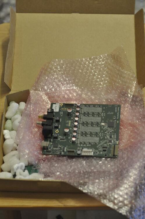

  14. Read many good reviews on such kind of DACs, so get latest version of boards dam2941-12. Wanted to power it with Salas Reflektor-D and Salas UltraBib.b.
