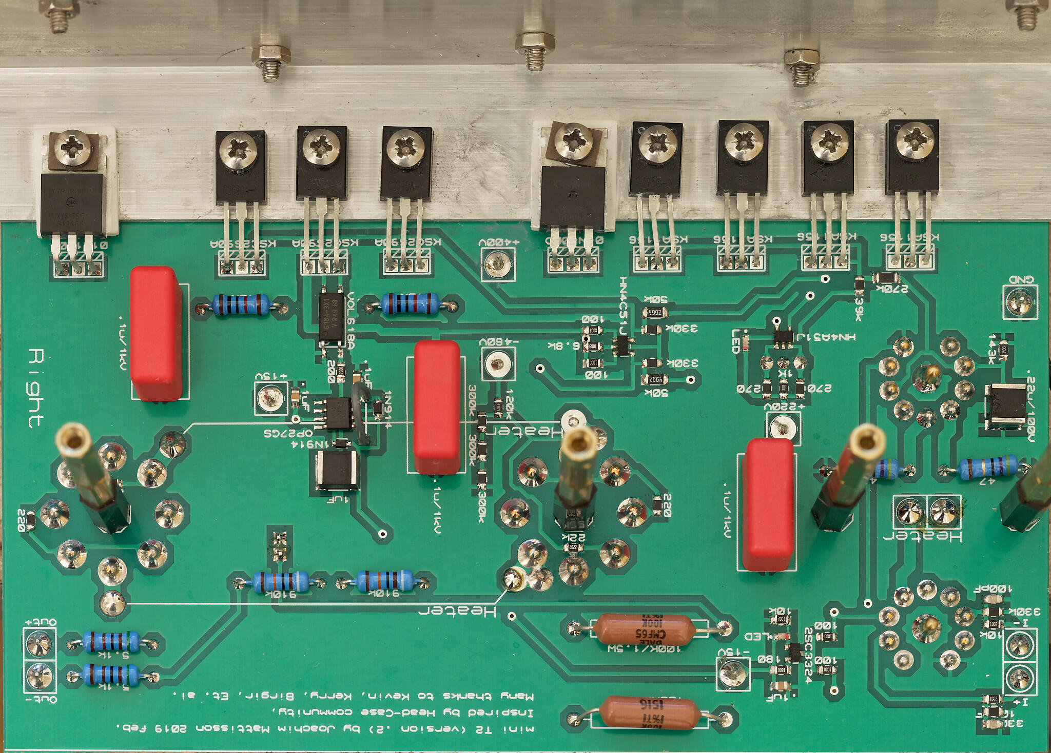

Some small changes I personally would like to see to the mini T2, based on my build style. 1. space for screw terminals for the transformer to el34 heater wires - I like to be able to remove boards easily for testing/inpsection etc without having to desolder anything. 2. more space between the 6922 heater screw terminal and the valve sockets. - its a bit tight. 3. the ground plane not connected to the screw holes for the heatsink L bracket. I like to mains earth my casework and leave the amp ground foating. 4. the screw terminal holes grouped like the blue hawaii, so I can use terminal blocks without having to cut a 2 way into a 1 way.. plus the one way can twist easily if you dont hold it when you tighten the screw. 5. a second ground screw terminal, - so I can have one connect to the psu pcbs and the other connect to the input signal ground. 6. have the 6922s at the front... more valves visible more orange glow 🙂

My transformers have arrived! and I have begun initial amp board testing. A few more mini T2 build notes/observations. Once the amp boards are completed using diode test on a multimeter across the leds will not make them light. The 2 red leds on the underside of the amp boards will not light if just heaters and + and -15V are applied... you need the high voltages too. The el34s heaters run at about -400V DC with respect to ground plane on the amp board, the 6922 heaters run just about 0V with respect to ground. The attachment holes in the pcb for the heatsink L bracket are plated and connected to the amp boards ground plane. So the L bracket, and therefore the heatsink and ultimately the entire case is connected to the pcb ground plane. I have decideed to turn the amp boards around so the 6922 are at the front... to me it looks more visually pleasing... 🙃

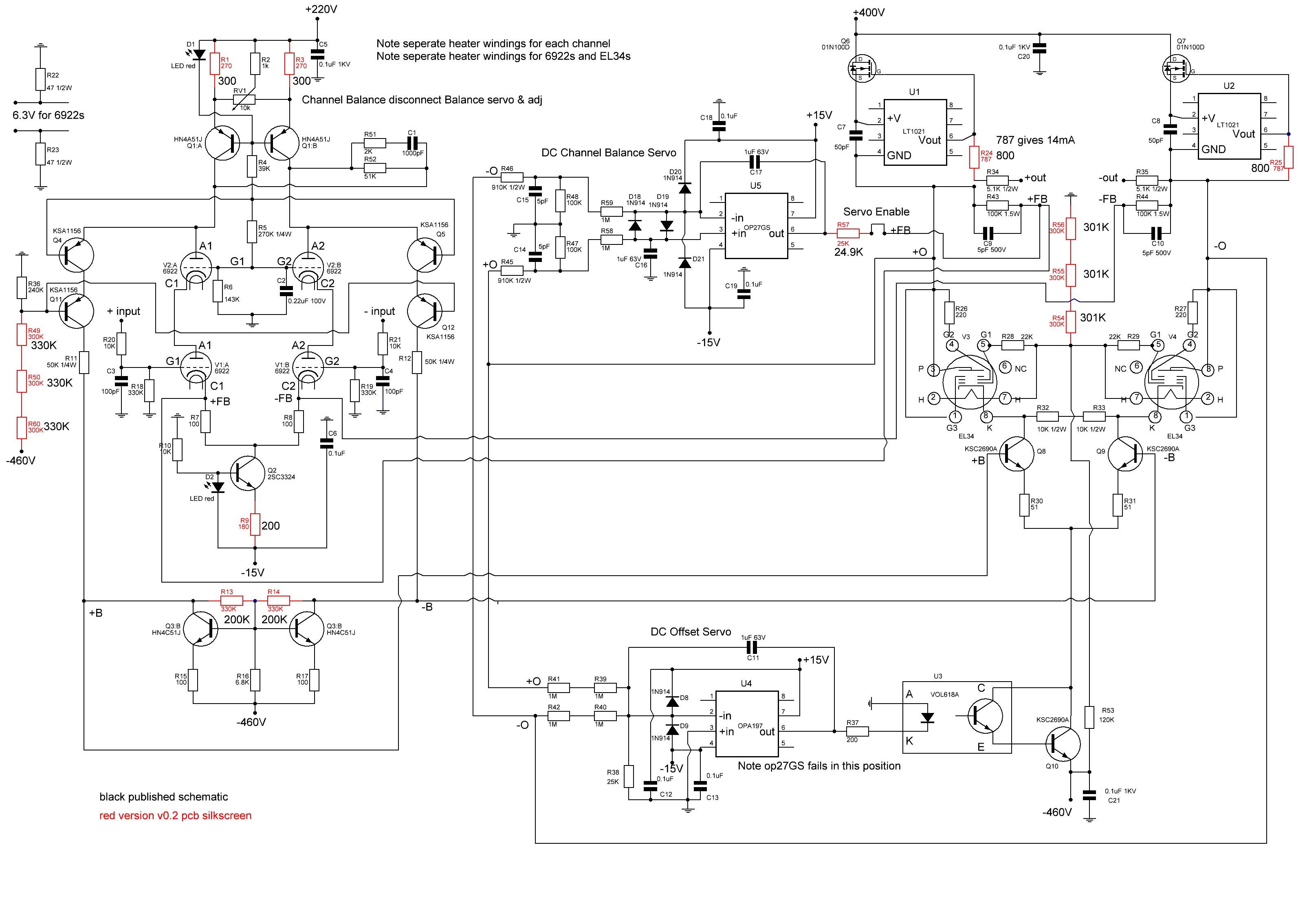

Well spotted Mirko, you are correct. I will update the schematic.
I added the red anode mark myself when I tested the leds with a multimeter.

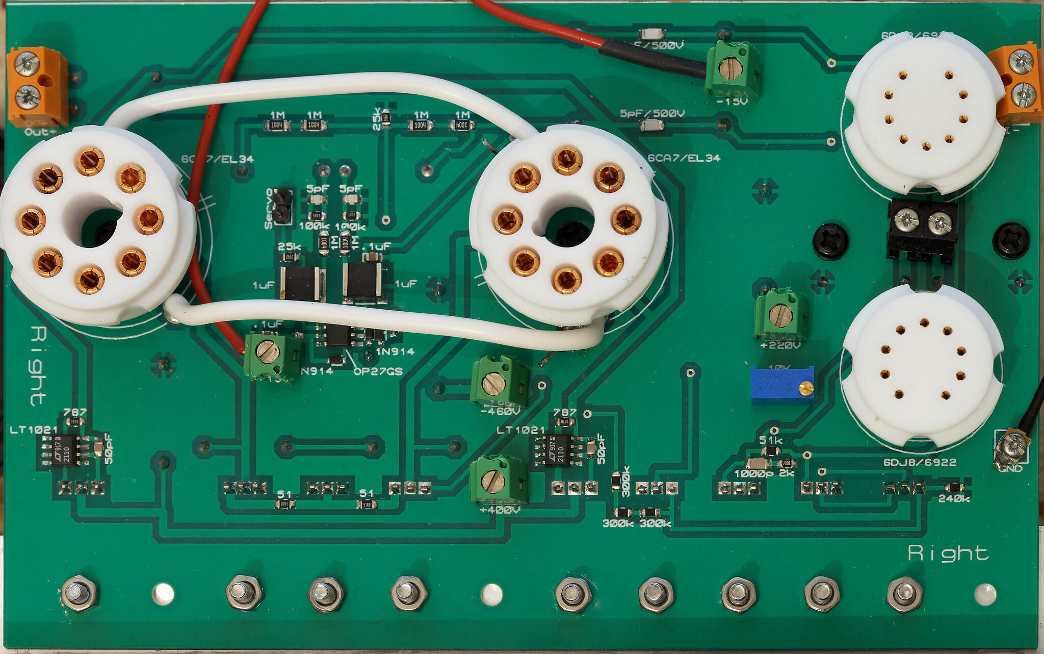

My mini T2 amp boards. Note the screw terminals on the top to make troubleshooting easier I know JoaMat does not believe in screw terminals but I do. 😉. If you are careful its even possible to orientate the terminals so the silkscreen voltage markings are still visible 🙂 . I take a 2 terminal and cut it in half and put the original smooth side parallel to the silkscreen markings. There is not space for screw terminals for the heaters of the el34s so I (possibly temporarily) have soldered in a header pin at 45 dgrees I have used nylon m3 standoffs for the first layer so that there is no chance of the standoff shorting against anything and brass standoffs for the remaining layers to get to the required height. SMD soldering was done in a three step process. 1 apply solder paste to the pads. 2. melt the solder using a hakko 888D station at 330 degree C using a fine tip until the paste has migrated to only be on the pads. 3 Hold the component with twisers onto the pads and with my other hand use a Quick 861DA hot air station using the smallest supplied nozzle with airflow setting all the way down to 5 (even then its possible to send one of the small diodes into orbit with that air flow)... to reflow the solder onto the component. the reason I soldered this way was, 1. I could collect any excess solder with the hakko, since I dont have an electronic solder paste dispenser... 😞 2. I could be reasonably certain there was no solder paste left under a component. I use the same method for soldering Kevins' synchronous rectifiers. this is the schematic of the v0.2 pcb with valves from the silkscreen. The red components have changed since the last published schematic.
