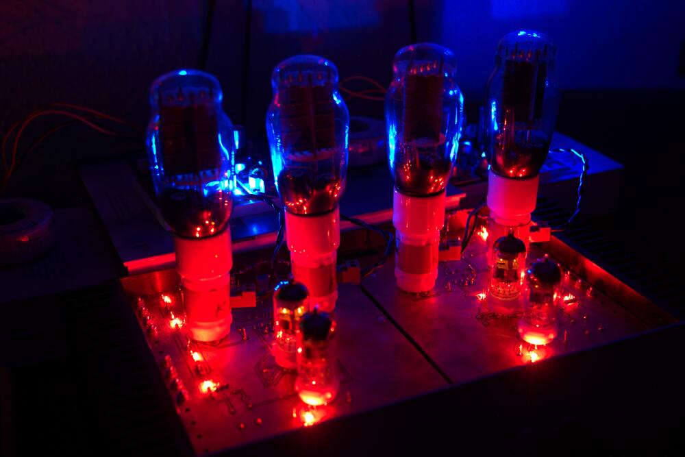

Did this today today – in full dayligt. Replaced EML 20B-V4 with 2A3 tubes in a Megatron with solid state constant current sources. Changes are filament voltage and cathode resistors (from 640 ohm to 3600 ohm. Only light is from blue and red LEDs and some light from the tubes themself.

Posted
The latest version of Megatron XL comes with 4 pots each 300B.
What are those pots adjusted for(cycled in the pic)? I'm not familiar with the DHT tube.☹️
I assumed they are for Grid voltage adjustment.
  • Like 1
Posted
Yes; gives roughly +/-4V of adjustment range in my build. Can be upped if larger range is needed.
  • Thanks 1

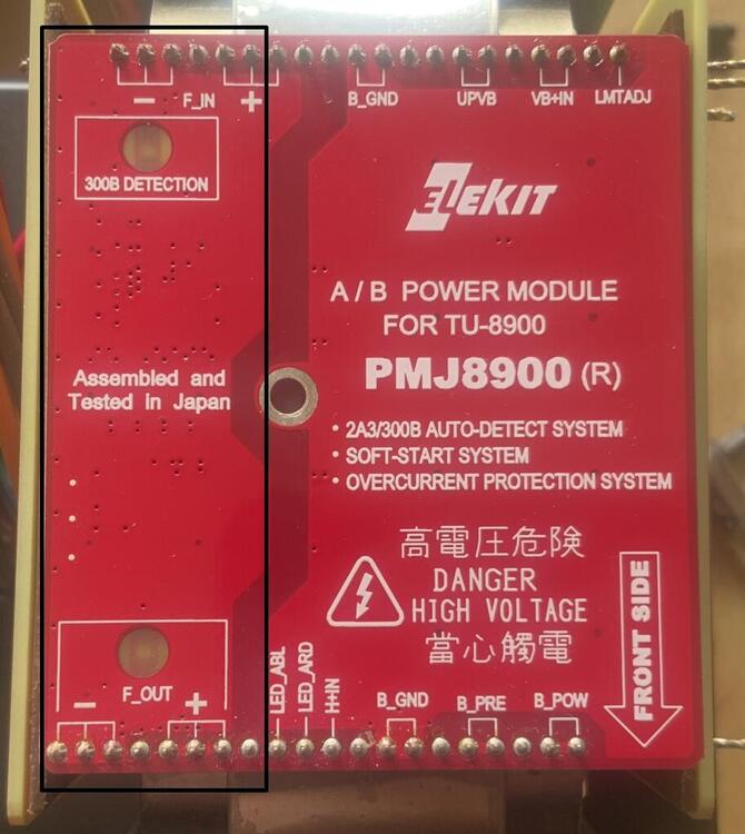

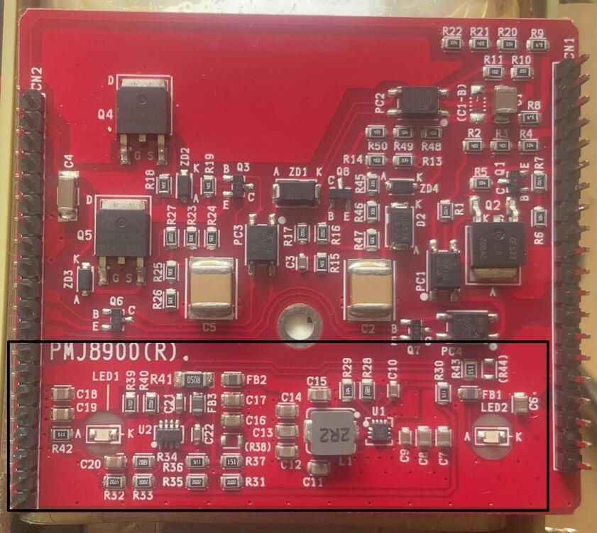

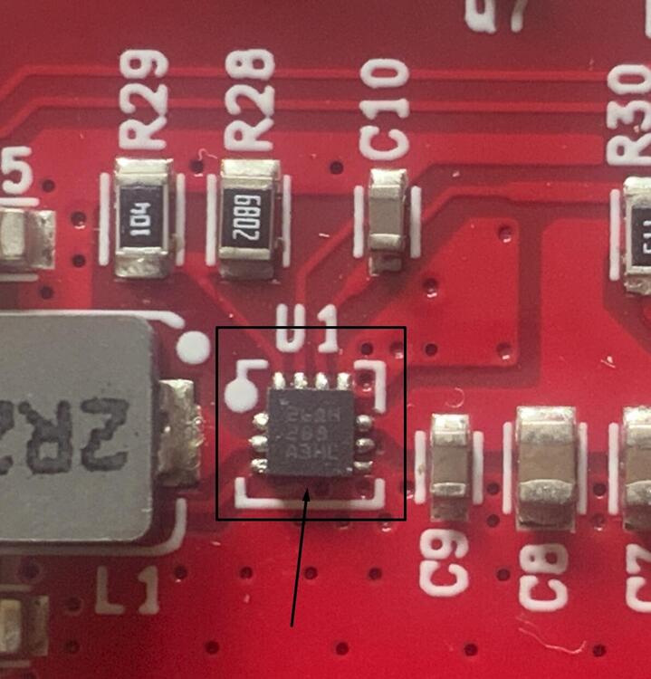

Posted
On 6/4/2025 at 9:06 AM, Shawn said:
Adjustable output voltage (to support both 2.5V for 2A3 and 5V for 300B)
Nice idea. If you can implement an auto detect function as well – like Elekit has done with TU-8900.
Power module…
filament supply in black square,
and the tiny - 2mm x 2mm - step-down converter.
