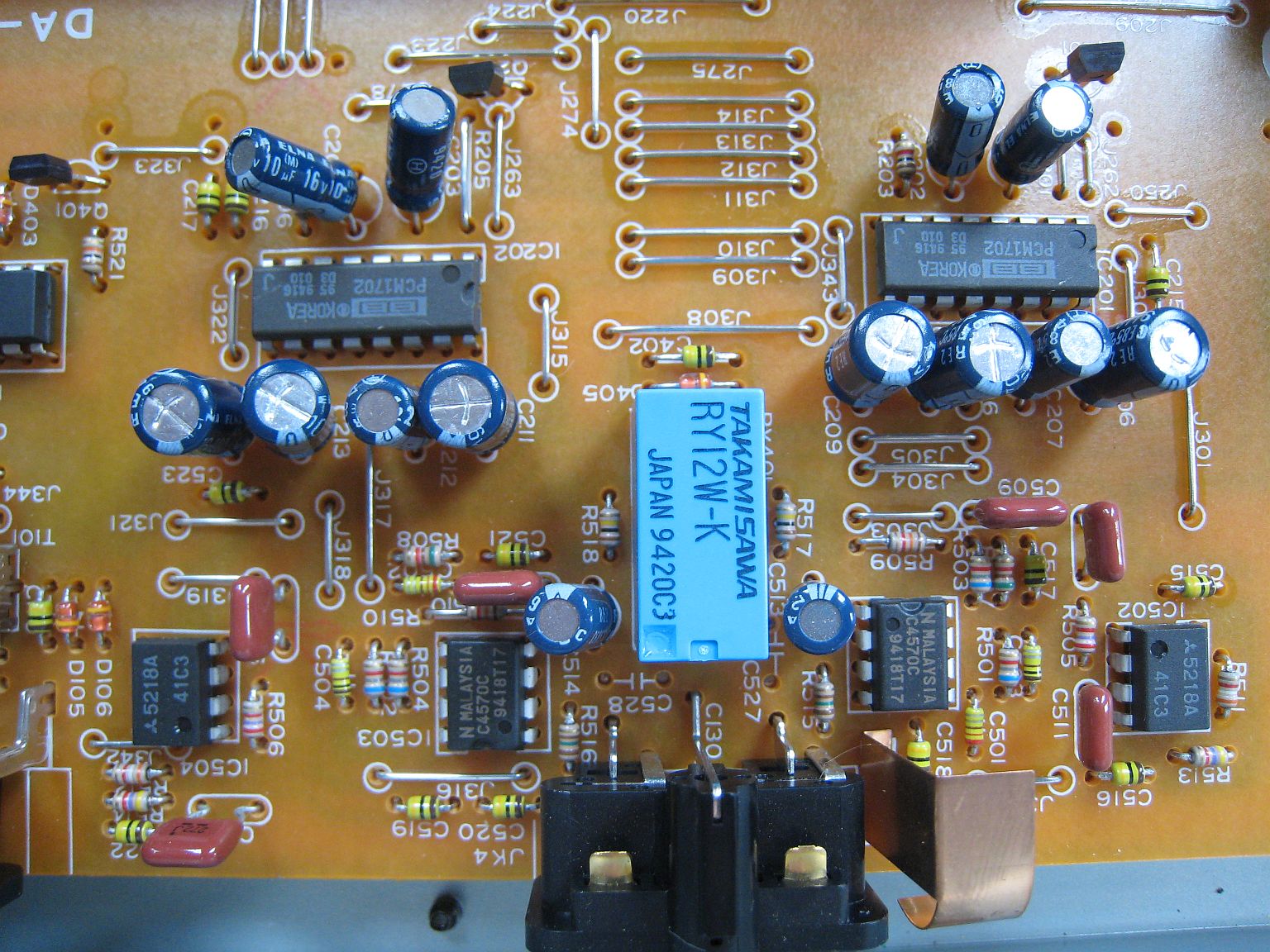

Honestly, I can't remember what the DA-500 looks like on the inside. If you could give me some good pictures of the inside of it, that would be really helpful in terms of my being able to give advice on mods. A schematic of the output stage would also help, perhaps from grenert :)
Or I could just send you one of mine, you figure some stuff out and let me know what I owe you... Then post the mods at your leisure!

Here's the analog section of the DA-500. Some highlights are:
M5218 op amps (IC502 and IC504) are filters
PC4570 op amps (IC501 and IC503) serve as I/V and buffer
C514 and C515 are the output capacitors
You need a better set of screwdrivers, deepak ;)
I won't argue with that. Thanks for the pictures. Does the digital and analog section share the same power supply?
